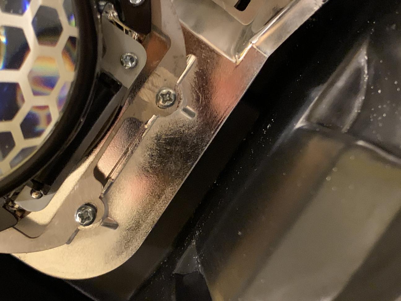

If you opt for the D2S 5.0’s with the brackets, just know the bracket may not be a direct fit into whatever amazon headlamp you get. I’m in the middle of my 2nd retro and had to do some Dremeling and what not. Definitely worth the trouble though!
So I got a chance to pull apart the headlights today...
Turns out my projector bowl is burned up/corroded to hell, as suspected. Welp, that explains the dim output. :caked: There was a ton of water that isn't visible collected at the bottom of the headlight (not visible without removing that little headlight body panel on the bottom covering it) and it even rusted and cracked the two screws that hold the smoked chrome portion of the housing to the lens.
At this point I think I might just be better to buy some TYCs and break those apart for the retro.
Yeah, it’s the bracket Lightwerkz sells
Hmm I guess maybe some of the aftermarket ones have a different mounting pattern for the brackets? If it’s a real pita, I could probably reuse the backs on my OEM lights and harvest the lenses from an aftermarket set. How much work was it to make the brackets work? Which aftermarket did you use?
In other news, I am seriously contemplating the Morimoto MLED 2.0. Lightwerkz’ initial testing seems
to confirm they do outperform the typical (D2S 5.0/G5-R) 35w HID setups. TRS claims they are “brighter than a D2S 5.0 with a CBI and 50w ballast” but it seems Lightwerkz hasn’t quite found that to be true, not that I was really considering 50w anyway, though. They use the same mounting points as the D2S 4.0/5.0/G5 and seem to be reasonably priced so needless to say, they I’ve added them to my board.
I am curious about the newer LED units as well, but leary of the fact that they are a single unit and if your LED ever goes out, the entire thing is shot and needs to be replaced... right? (save for dis-assembly and soldering in a new emitter). That makes me less inclined to run them considering you might shoot yourself in the foot long term, or at least set yourself up for some not so easy repairs down the road potentially. I would be more inclined to consider an LED specific projector that had a replaceable LED.
I think you might be right.
On the plus side, baking them open was surprisingly easy. I just reused the stock sealant to cram em back together, but leaving it on was a huge pita to fit some of the stuff back together. I’ll be much better prepared to do the actual retro now...I think lol.
