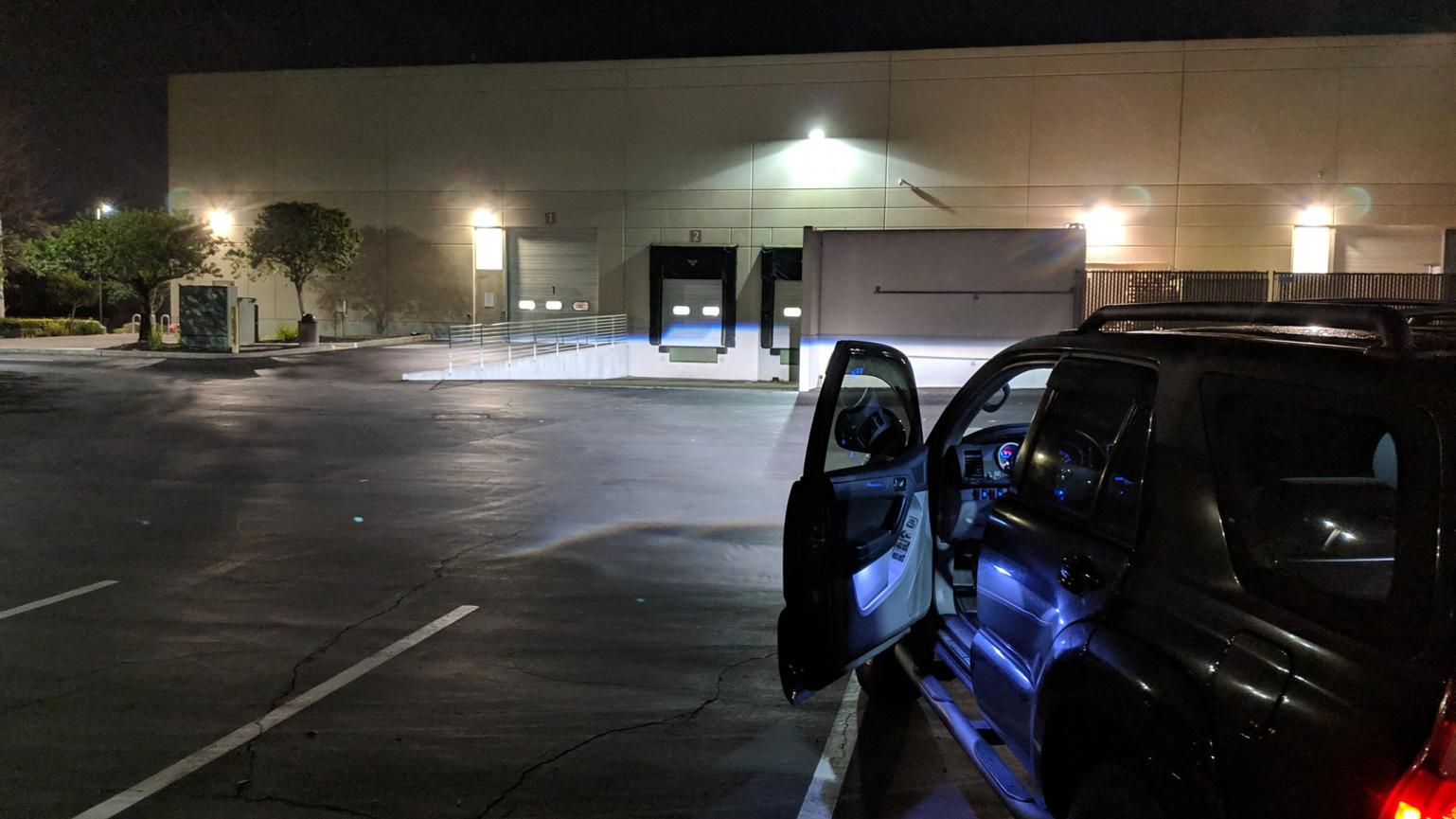

heres what s2000 projectors and 50w and cbb bulbs can do, camera is a google pixel 2 xl auto setting.

even if you use the aftermarket lights, you keep the stock internals and swap over if necessary, its good to use it for parts when certain parts break, you can also swap the lens over or shroud over. just take your time and do it right.
Nice! Good height on the purple shift too. Did they do any lense spacing/tuning for that specifically or a happy bi-product of your setup?

lightwerkz did the retrofit for me, clear lens was stock, only mod i did was the bulb spacer mod, which help make it a little brighter, i used a 16 gauge bare solid wire to make it space about 1mm at the bulb area. 2mm and you will loose intensity.
im at least 120+ feet from the loading dock.
