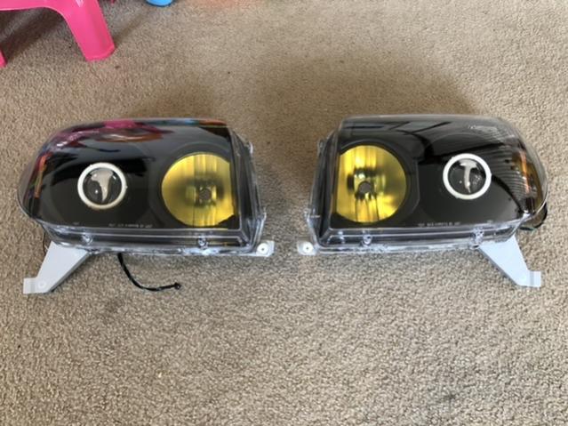

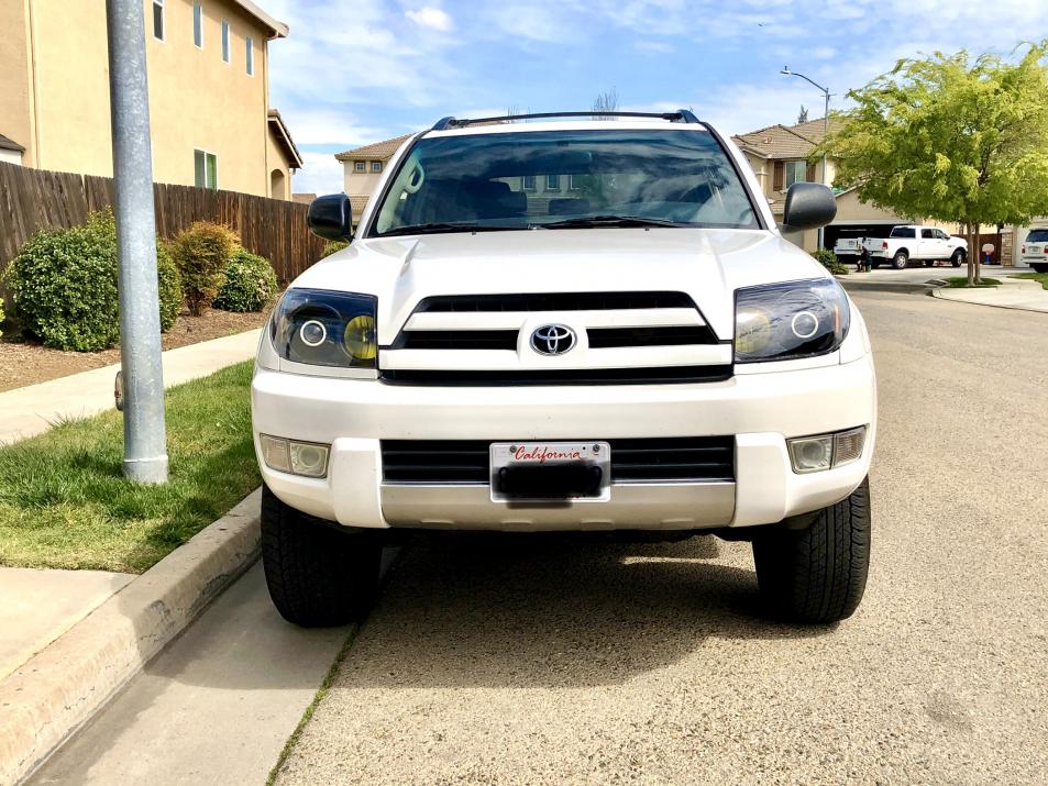

I think the painted highs looks good during the day but not as bright as It being unpainted. Good thing my projectors are bixenon, with the wire harness I’m running quad highs. Probably search for a mod to make them daytime lights with my halos. Also did the stage 1 fog mod so I can turn them on anytime except when running the highs.
