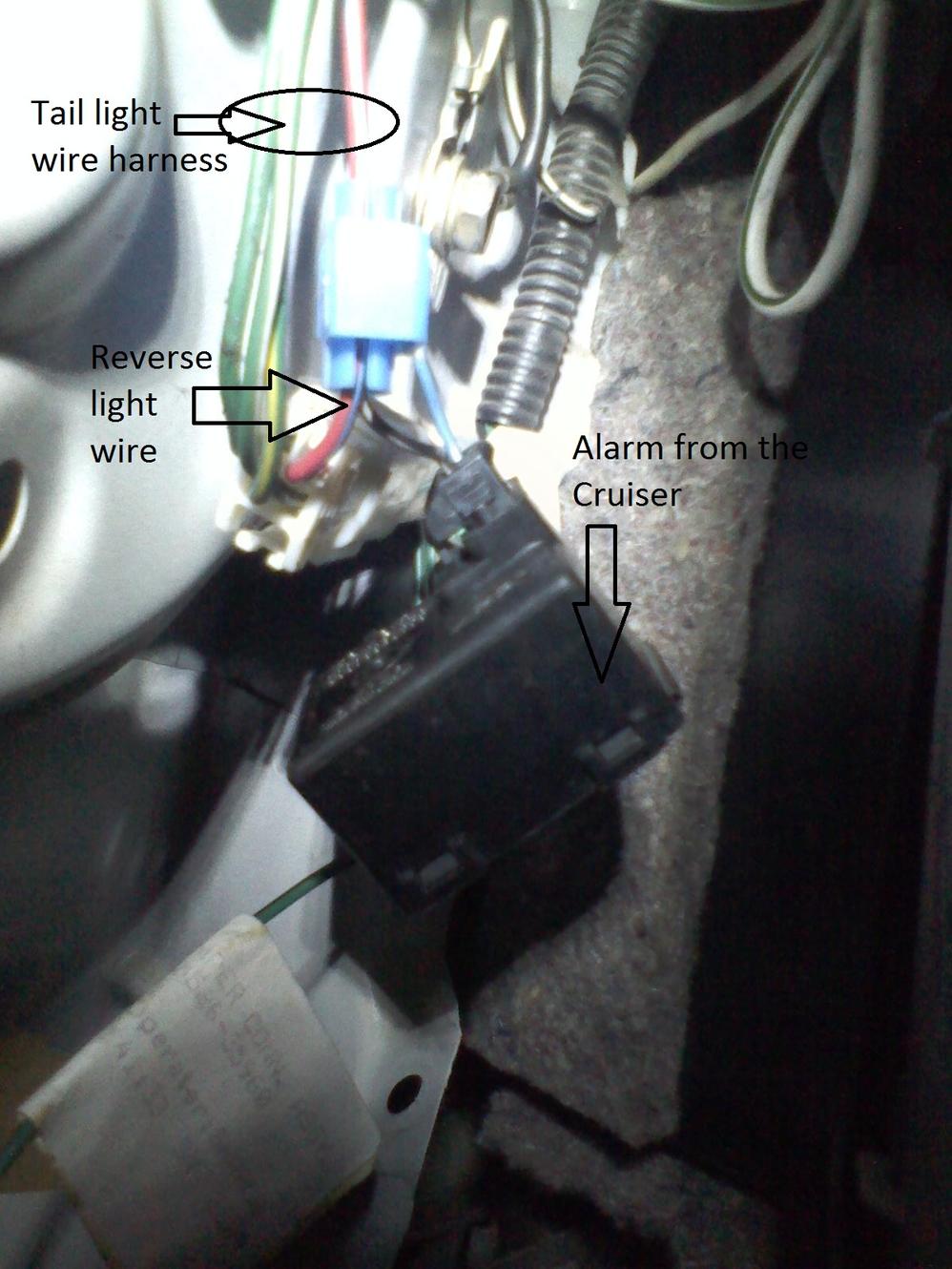

My 97 has no dash indicator to show the gear I am in other than beside the shift lever. JDM models have an alarm when the car/truck is in reverse.
A week ago I got off the truck to take my 5-year-old to school by shifting the shift lever into P (I usually get it to N) with park brake on. Then got back in and shifted it by 1 step (assuming I was at N). Thankfully I gave a little gas and the truck went backward a bit, so I quickly stepped on the brake.
I would have been in a bad situation but I was lucky that day. Since that day I wanted to install an alarm. I want it bit close to JDM. I came across an alarm from a Cruiser 100 series! It works great so I wired it into the reverse light by the quarter panel on driver side.
Now, it gives an alarm as soon as I shift into reverse!!!
Had to take the tail light off and then the panel a bit.
Spice the + wire to the backup light and the other (-) to the ground. That's all!

They are pretty simple to install. We have to put them in our work trucks. It gets to be a bit annoying by the end of the day but there's a reason we have to have them.
I put one on my work van years ago, annoying af when you're backing out of your driveway at 0500 to go to work, but they serve a purpose
