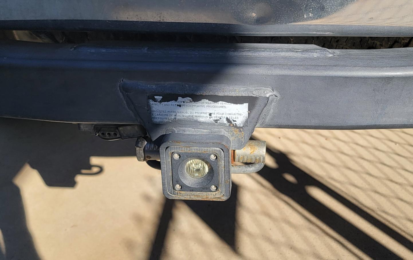

I have pretty dark tint and couldn't see much behind me so I took a 2" LED pod and shaved it down to fit into my rarely used hitch receiver. The light is on a bracket that is held in with the hitch pin and the wires are on a 2 pin quick disconnect. Wired it to a switch next to the steering wheel. Also put drop in LEDs in the stock housings.

I like that led pod. These are so dim in the backup lighting.
