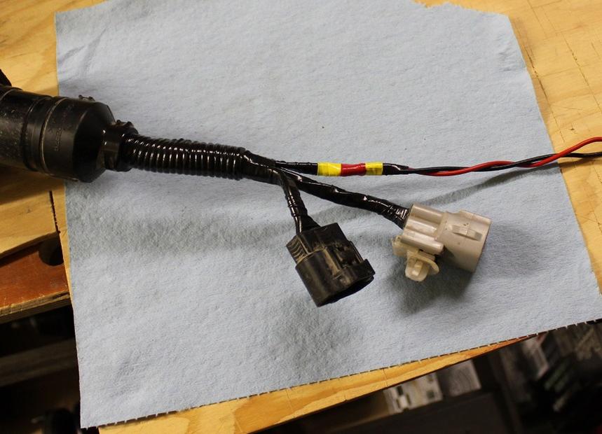

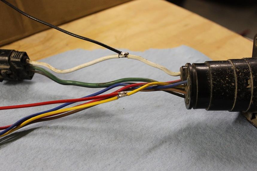

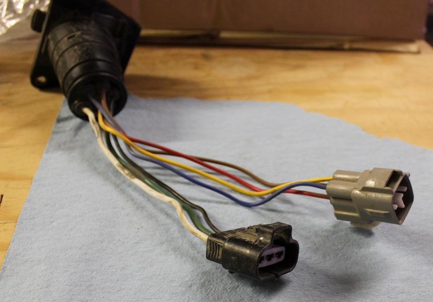

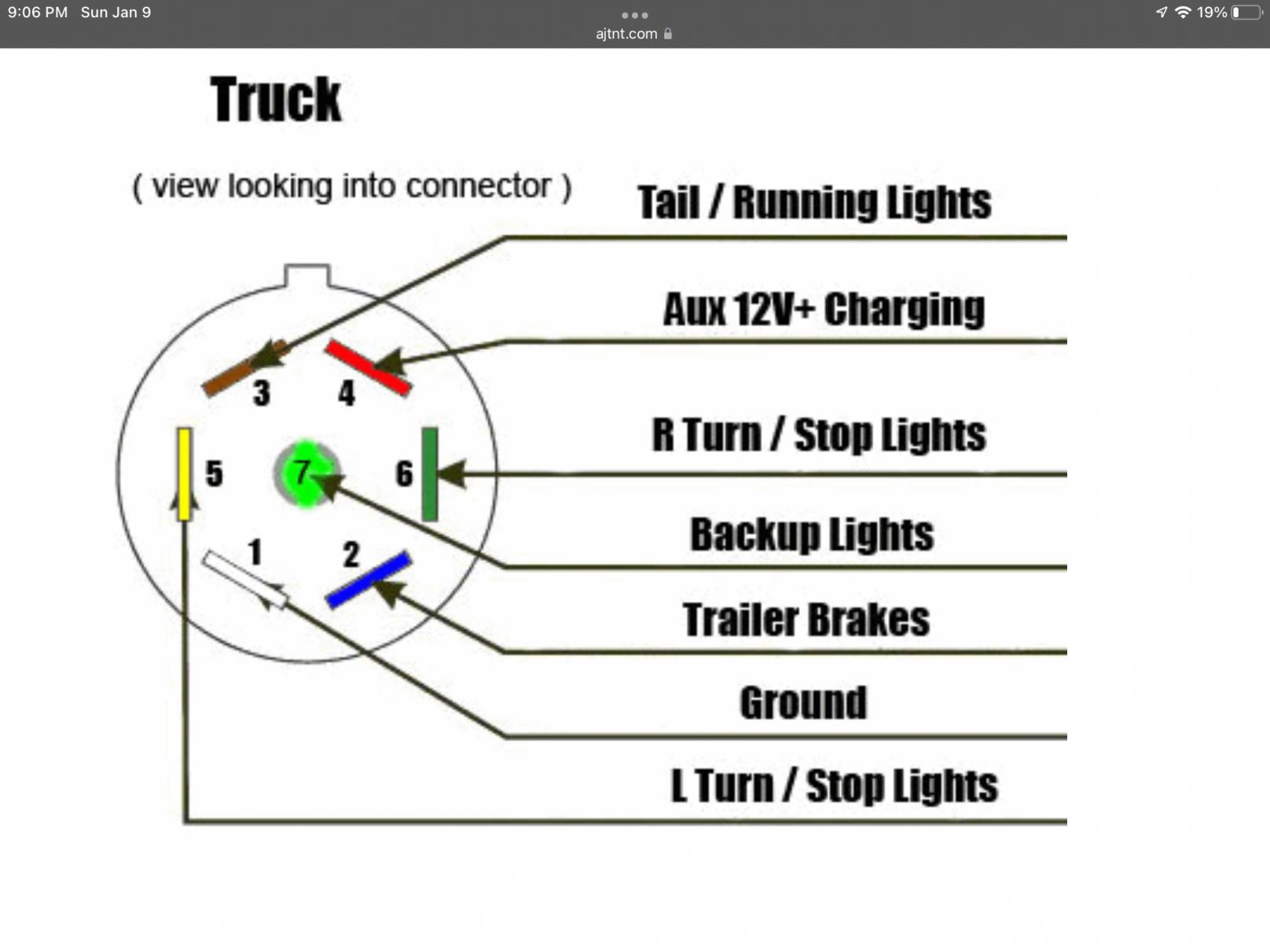

Trailer harness tapped for reverse. I used the correct colors.

Thanks. Thats what I needed to see. Should make wiring it a snap.
