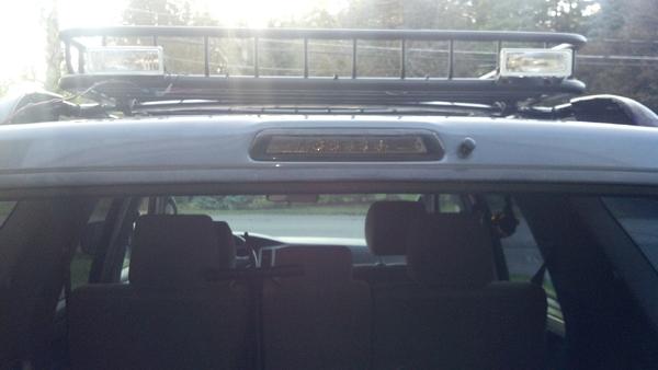

Here's my solution.

I picked up some 55w white fog lamps from Walmart. I originally mounted them about 12" on each side of the factory hitch. They help quite a bit, but I think they needed to be moved outboard. Last weekend, I installed a hidden hitch. That casued me to have to relocate my lights. I ended up putting them behind each wheel well using the existing bolt on the bottom of the side panel of the bumper and using the single middle mount hole on the bracket. Now when you put it in reverse and look in the mirror, I get much better light in the area most helpful. You still need to follow the threads on how to do this using a relay etc. I pulled the reverse trip from the trailer hitch wiring and the 12V from the rear auxillary. If I were to do it again, I would pull the 12V from the from battery or fuse box. Best regards, Doug
