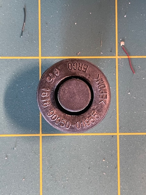

The reason I am posting is to ask if you actually found a replacement grommet. The typical auto parts stores have "general/fit-all" grommets that don't seem to fit right. Do you have a link or part number for the factory rubber grommet?
I wish I could help with the passenger side grommet but I've had no luck.
There's a part number printed on that grommet.

Take out and drill the rubber grommet from the picture above - not the firewall. Just make sure that opening is useful and lead somewhere accessible inside.
