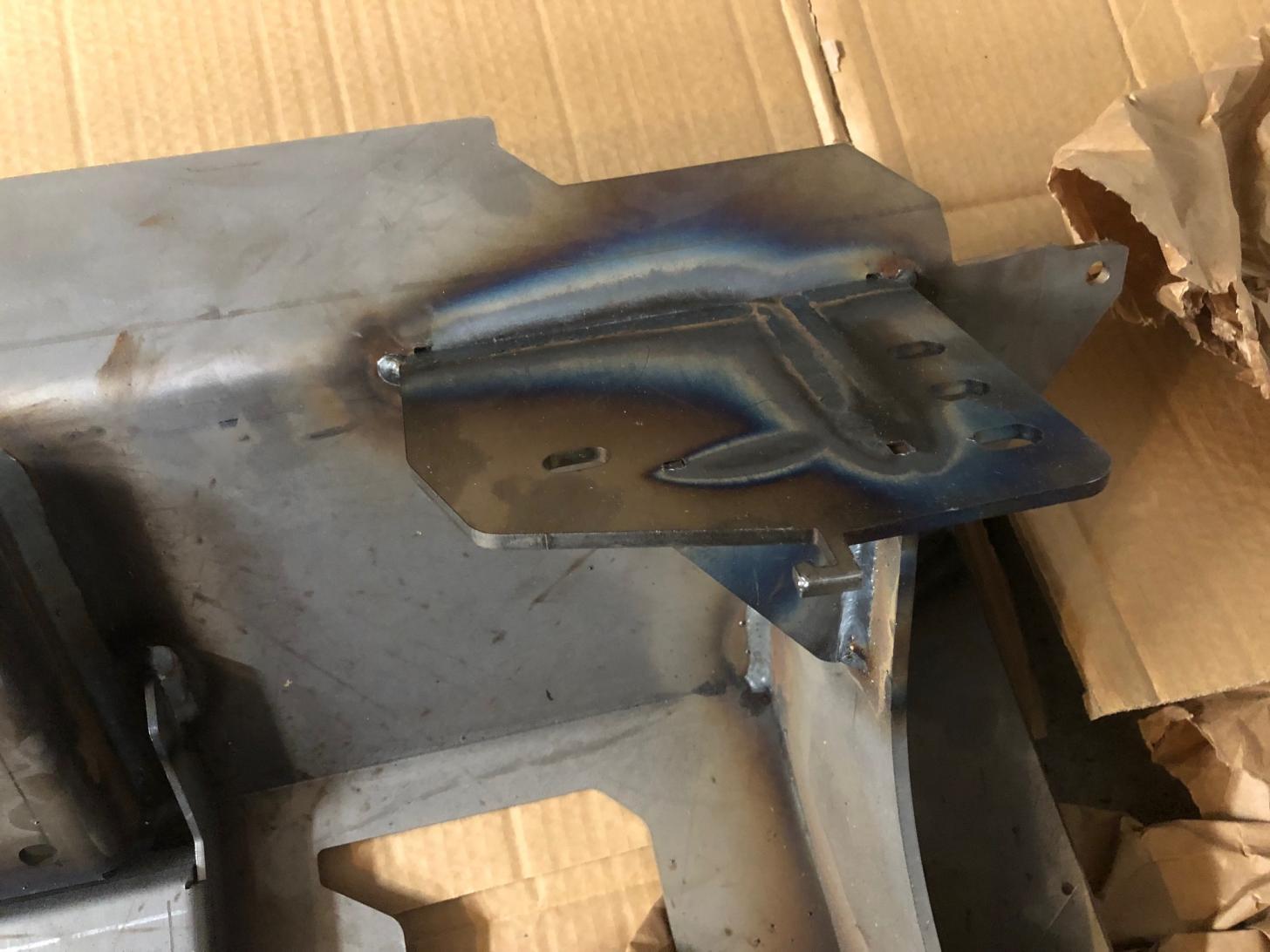

Upon receiving the bumper, I noticed quite a bit of weld splatter. No big deal, I was able to sand most of it down with my air grinder. Although I believe that's something that should have been noticed and taken care of by QA prior to shipping. Upon further inspection, I noticed the "hook" tabs were facing the wrong direction :doh: nothing a pair of pliers couldnt fixed. No big deal right? BUT wait! Theres more. I cant find the exact post where they stated it fits a Rigid 30" bar, but it doesnt. I had to fab up some simple brackets to mount the bar in place..no big deal I guess. Now onto the winch! For the most part, the winch fit but I did have to bend the vertical bar on my core support.
Now comes the part to install the bumper onto the car. Only 3 of the 4 holes lined up correctly on each side. :censored: Once I got everything on and buttoned up, I noticed the bumper was shifted a lot more towards the passenger side and not perfectly center. Pulled everything off and shifted the bumper as much as I could to the driver side. Still not center... :mad: Top of the bumper also sits pretty far in, borderline pushing up against the center mesh grille. Sides of the bumper sit right on the bumper itself and I expect paint to rub off over time. Eventually I will have to pull everything back off again in the future and widen/oval out the mounting holes and see if I can get it aligned better.

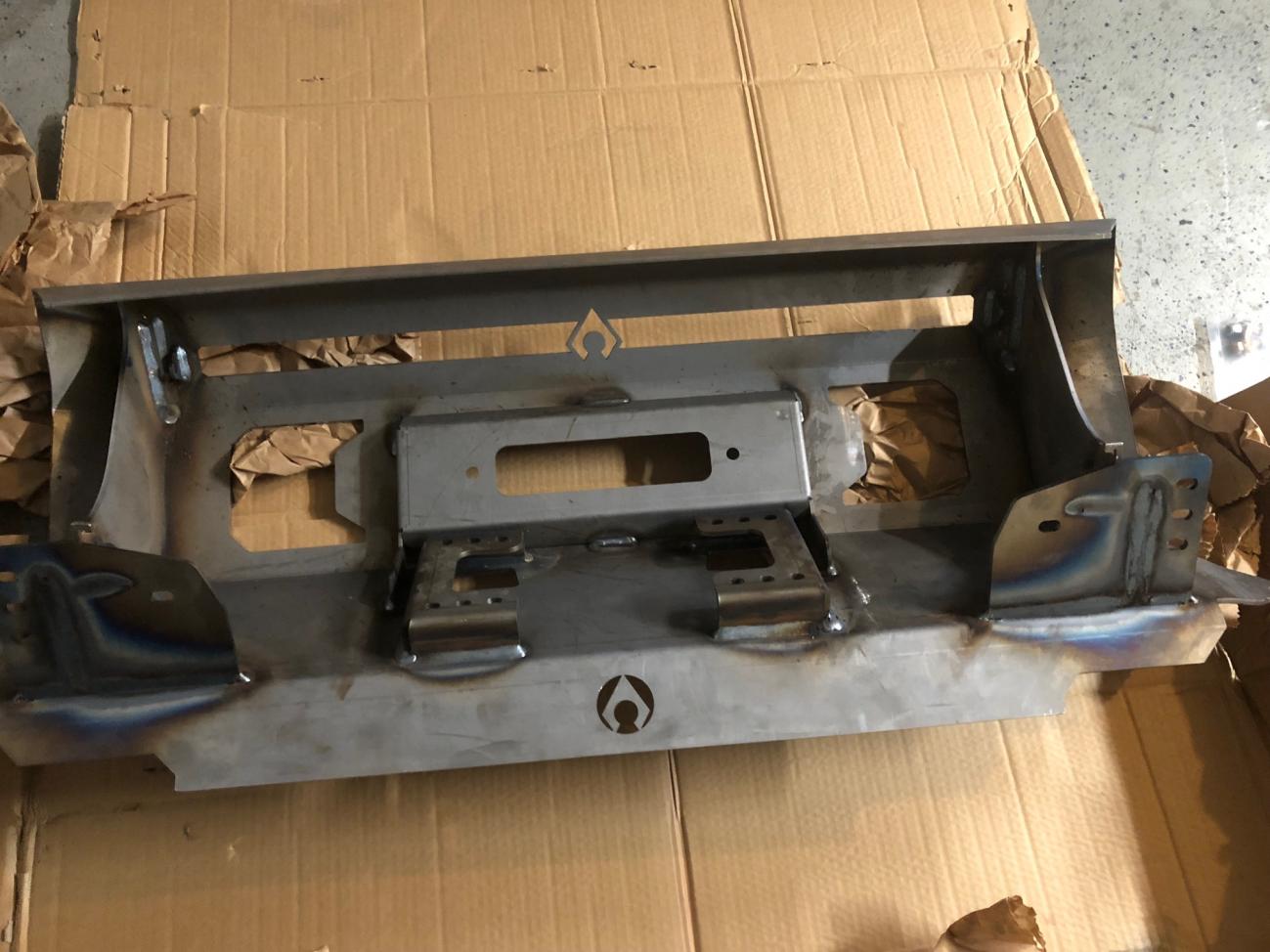

More pics. Check out the 3rd picture.
You can see that the bumper still sits more towards the passenger side. The mounting holes under the bumper also don't line up with the holes of the venture bumper on the passenger side as it does on the driver side. If I try pulling and flexing the bumper to line up the hole, then the bumper pops out of the mounting bracket along the fender.

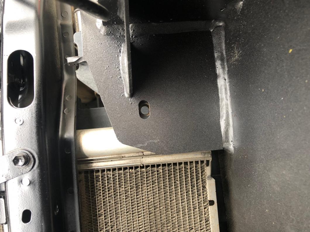

thank you for sharing your experience. it shocked me, because I just received my Artec bumper. I bought it from 4WP, having a shorter lead time(a week), but no free lower control arm armor.
The first one I got was found had a out of shape screw hole on the wing plate of the bumper as picture 1 showed. 4WP helped me change one.
The second one seems has the correct hook position(as pic 2 showed), and the 6 mounting screw holes are even distanced from the central logo according to a rough measure. But I still concern about the fitting now. I will take out the factory bumper and try the fitting before paint it.

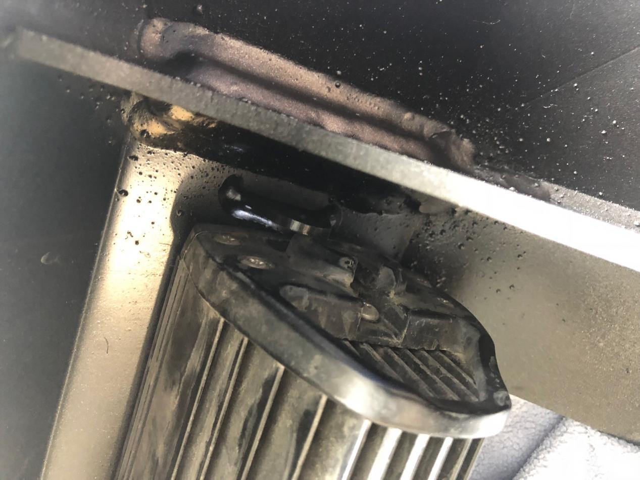

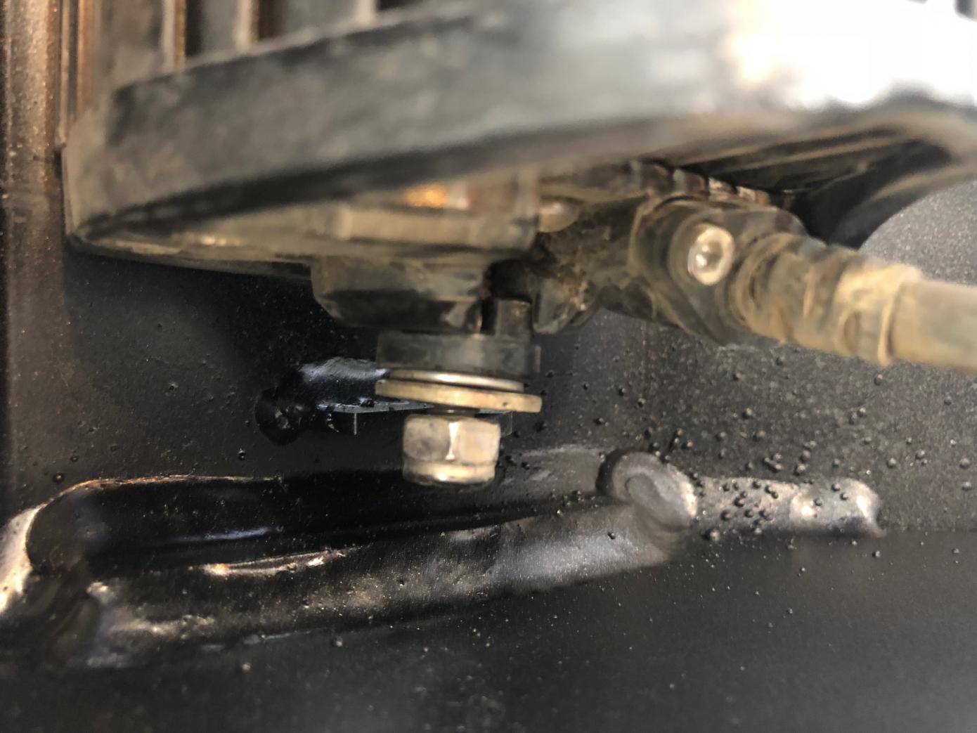

I haven’t posted a follow up to my install because I have been experiencing the same issues as everyone else. I had to cut and modify the hood latch bar in order to mount the bumper with a smittybilt 10k synthetic rope winch. No big deal, but I did some damage to my plastic bumper in the process even with masking tape applied. The hooks on the top of the steel bumper are too high for them to mount and align with the holes in the factory frame rails. I had to use a jack to prop the steel bumper in order to get the bolts back in. Once installed, the steel bumper sits too far into the plastic bumper and lower grille. I tried every adjustment and could not get it right. I could live with how close it sits because it looks like a factory snug fit, but it’s pushing so hard the bumper is popping out by the passenger headlight. I called Artec today and talked to Tom who then asked me to forward photos and an explanation of my issues and they would be getting back to me. From what I can see the easiest remedy would be to create a 1/16 - 1/8 spacer between the frame rail and the Artec bumper. I’ve already repainted my bumper once, and it looks like I will have to do it again. I will post an update once I hear back from them.

I went with the Smittybilt 10k synthetic rope. I mounted the control box on the side. You're going to have to shave down the hood latch bar and bend the a/c condenser line to fit the bumper. I can post a photo of what that will look like. I mounted a 30" Rigid light bar, it fit perfectly (someone previously posted it didn't fit).
