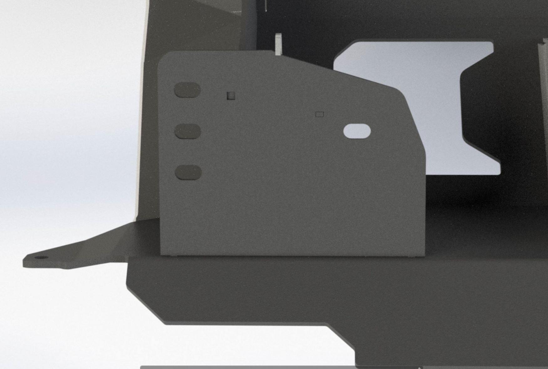

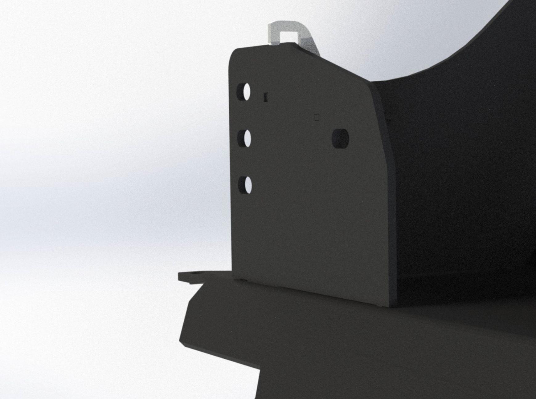

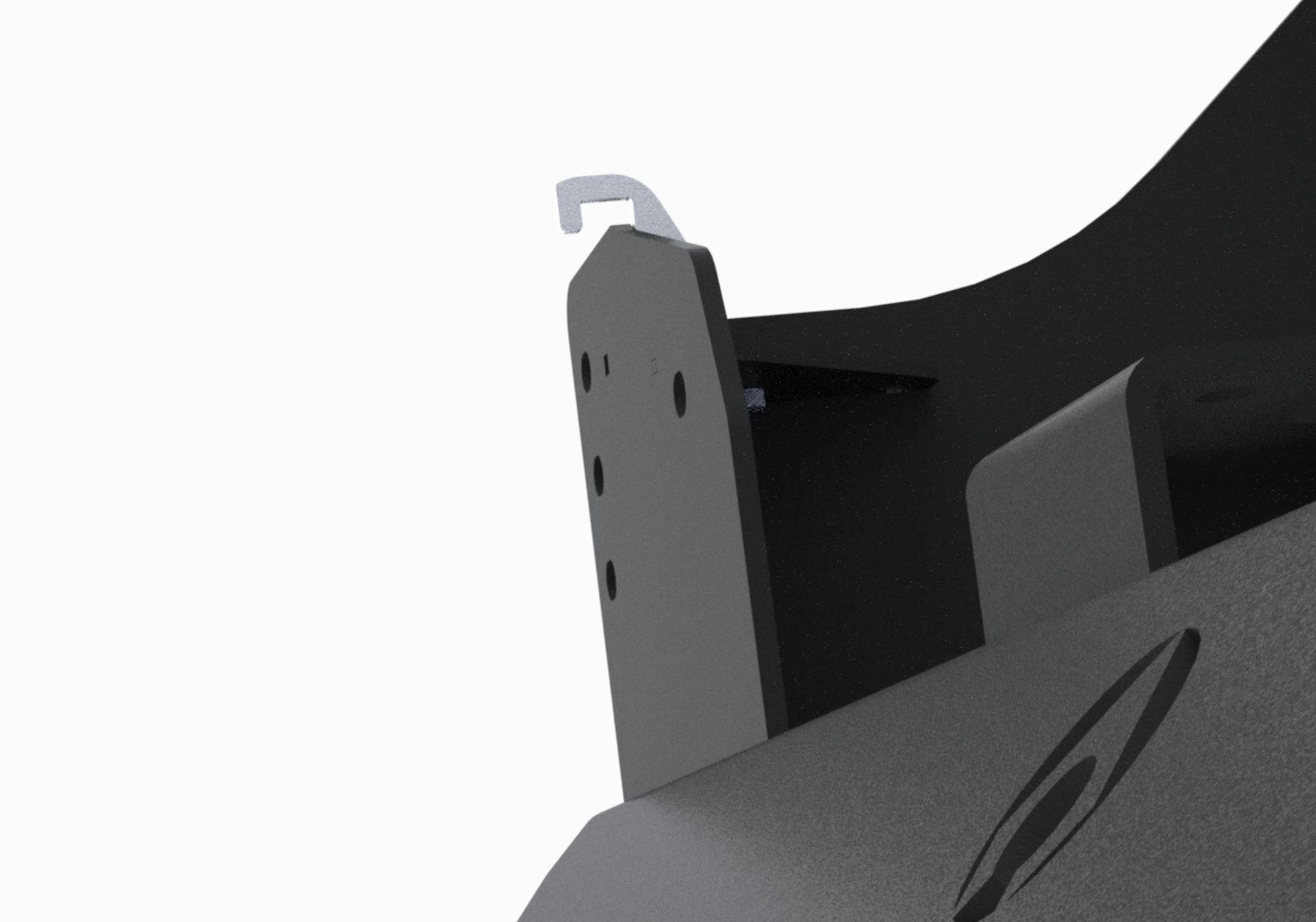

So over the past couple months as we have heard about some fitment issues with some 4 Runners (We had test fit 6 different versions with local companies and dealers prior to releasing these), but we felt with all of the feedback we make some drastic changes to the bumpers.
First and simplest change was the addition of the shims. These shims allow the bumper to be spaced away from the plastic and reduce the rub to the paint. We are including these shims in all new bumpers and will send to anyone with bumpers that are tight to the body and need a little bit if space.
Second, we modified the frame horns to allow more adjustment during installation. A lot of the feedback was that we had too tight of a tolerance here, when we needed those holes to be more open to allow adjustment when installing.
Lastly, the small tab that was cut and bent, which was causing some damage to our shipping boxes has been made as a separate piece. This should considerably help with damage to the tab, as well as excessive damage to the boxes in transit.

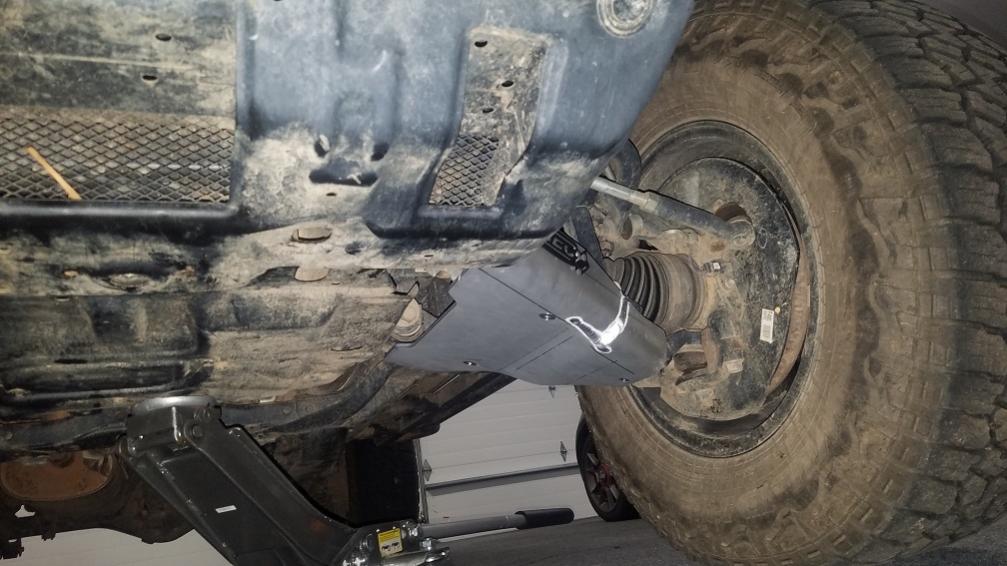

EDIT: Here they are!!! Well packaged and extremely well constructed, I couldn't be happier. LCA armor installed without a hitch though the factory skid did rub the ARTEC nameplate on the LCA armor everso slightly so I cut the OEM skid about 1/2 inch and all is well.
