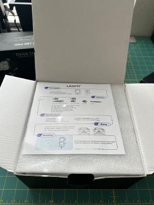

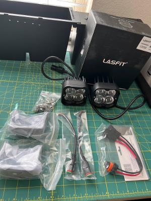

On to the pics (unboxing):
Extremely good packaging. Nothing will get scratched or damaged in transit, and everything is individually wrapped. Excuse the last picture, for some reason a extra connector made it into the pictures that i ordered separately. Also, the instructions, tech data, and pictures are all on one page in tiny print (which believe it or not, works really well when installing).

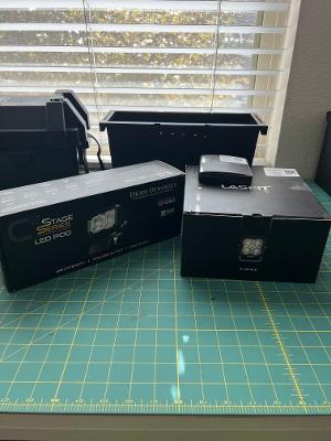

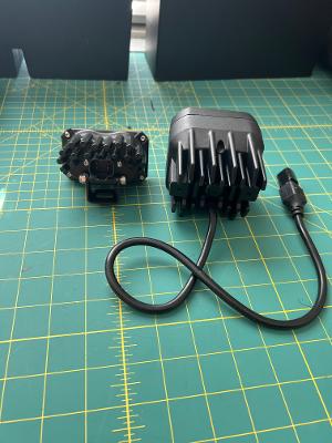

Here is a quick comparison to the diode dynamics SSC2 that I took off the vehicle.
1. Obviously, the diode dynamic is tiny, and has a tiny little bracket, and has a backlight. Honestly, the backlight is a bit gimmicky.
2. The build quality on the diode dynamic is SUPERB, but the wiring harness is not included, and the one you buy for $100+ is kinda crappy. I bought the wiring harness and wish i didn't.
3. Price point for the lasfit and the diode dynamic is very similar for just the light itself. The price for the diode dynamics wiring harness (plus shipping) is absurd. I DIY my own wiring harness (by chopping up my old wiring harnesses) for the lasfit cubes to save some cheddar.
4. Both Diode dynamic and Lasfit will require purchasing a wiring harness or DIY your own wiring harness. Lasfit is going to be cheaper to buy a wiring harness or DIY your own, due to not having a backlight feature.
5. Lasfit has a pigtail coming out of the back of their light. Not really a fan of this for the ditch light application. I run the wires through my hood for a cleaner install. I can't get the pigtail through the hole in the hood, which kind of bothers my OCD. I don't have a problem with the diode dynamics ditch lights because there is no pigtail connection. The connection is at the back of the lights on the diode dynamics. Overall not a big deal, since most people don't run wires through the hood. I'm one of the few that do.

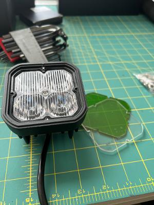

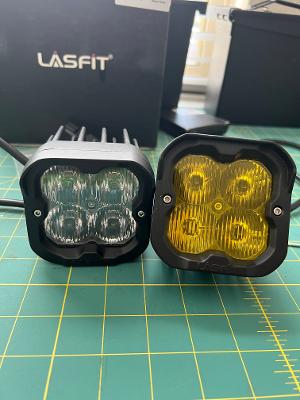

Build quality of the lasfit:
The build quality is superb.
1. There was no marks or weird powdercoating issues. The powdercoating was done evenly.
2. the lenses are individually wrapped and has a protective plastic to keep it from getting scratched in transit.
3. the lenses are interchangeable and DOT approved (although not in the ditch light location..) Don't be a tool by using this on a public highway now!!!!
4 .the lenses are held in by 4 screws (2 in the front/2 in the rear) that apply equal pressure to a metal frame, and a one piece rubber gasket that helps keep moisture out. Also, the lens is made of thick polycarbonate. The allen key is included with the lights to make changing the lenses very simple.

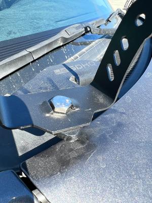

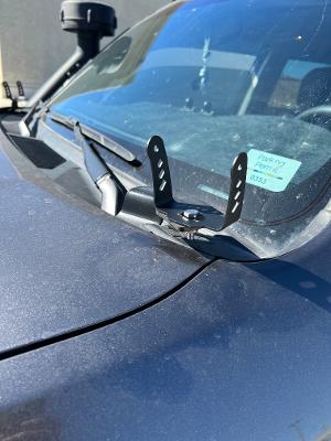

So onward to installation:
This is where Lasfit needs to improve upon. Those BRACKETS!!!!!
1. The fasteners appear to be stainless steel, so hopefully, they there shoudn't have any rust issues, unlike some of the other manufactures out there.
2. The way the brackets attach to the ditch light brackets (SDHQ) is pretty cool. I like that the bolt hole is boxed in. You don't have to use two hands or two tools to complete the install, so no complaints there.
3. The way the bracket attaches to the cube/lights can be improved upon. There is too much space between the bracket and the cube/lights. You really have to crank down on those bolts to get it where the light won't move (down) on its own. It's easy to fix if it does become a problem...a big, giant washer or a small, tiny nut. I'm going to leave it alone for now. I plan on some dirt therapy in a week or so, and hopefully, I'll have an update for ya'll.
4. The brackets are powder coated black, which is pretty awesome. It's the little details!!!!

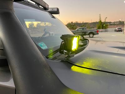

Yes, I am afraid of the dark, and yes, I don't know how to park, and the mall parking lot was full so this random parking lot will have to do.
1. The picture was taken in a parking spot that slopes downward (towards front of vehicle), but the view from the lights is pointing up at a parking ramp (upward) and I didn't actually have the lights in its final position (passenger side needs to move up).
2. also, the headlights and my biga$$, roof mounted, light bar were kept off.
3 Light output and beam pattern is VERY GOOD. The beam pattern was focused and wide (left to right) and narrow (top to bottom), with very little light scatter on the hood. Basically, the light pattern falls on top and to the right/left of my headlight cutoff. Very easy to set up, due to how focused and even the beam pattern is. No hotspots so I'm very happy.
