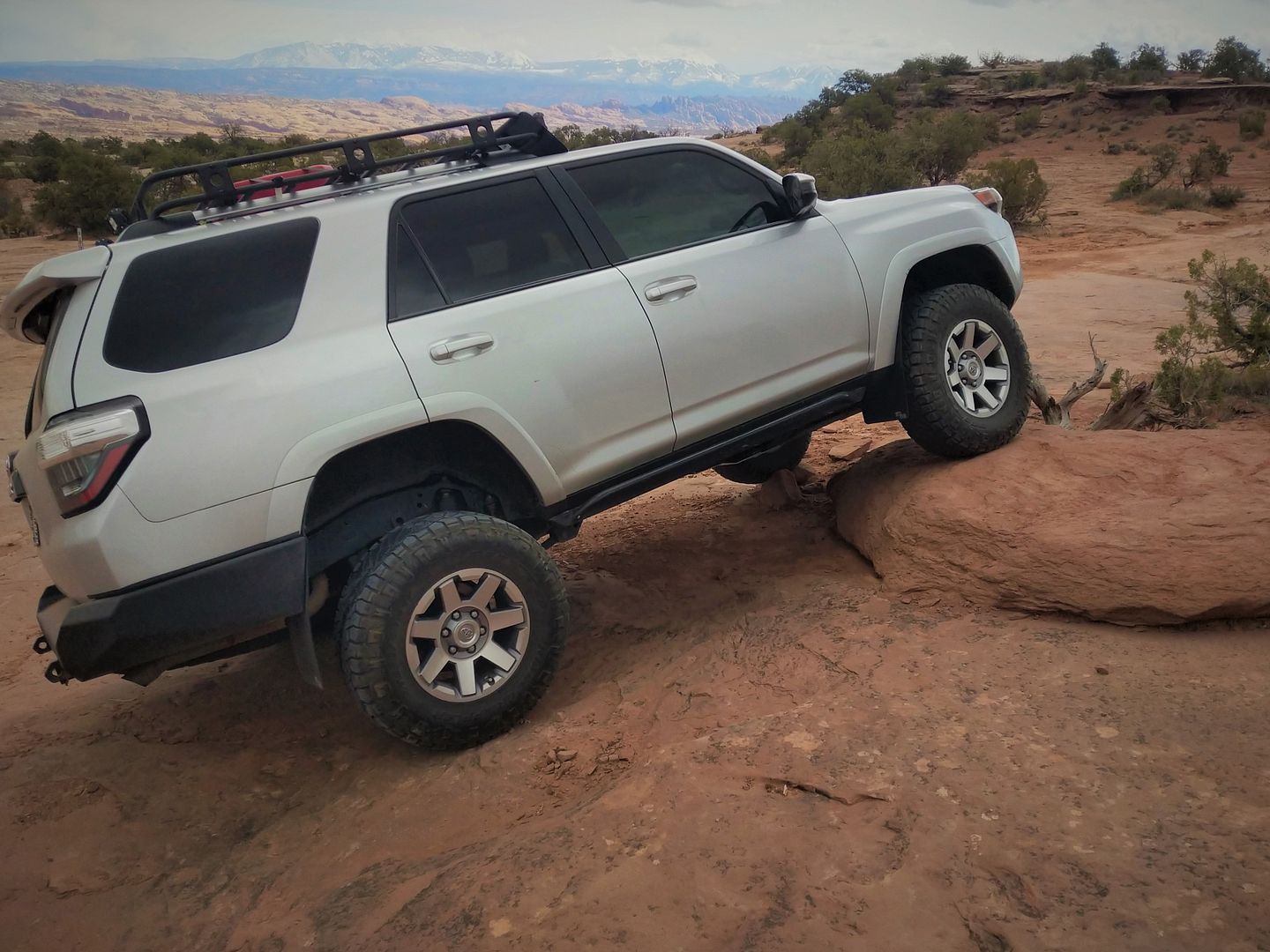

A 10 day road trip to Moab last week for social distancing gave me a great opportunity to test out the new bits. Everything performed flawlessly. Also, no more popping or squeaking.

Thanks! Did you notice any upgrades in off-road performance? Did clearance improve? Are you able to push the wheels forward to clear larger tires without having to chop the body mount? Are you getting better articulation? I’m just trying to understand if these aftermarket LCAs can make the 4Runner better at rock crawling.
Thanks.
