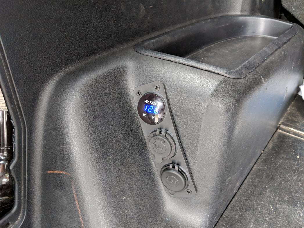

I just did this over the weekend, but is off my solo Northstar 27f AGM. Fused connection run down the kick panels.
What I did, and what I think is easier, is to just do this: Buy some 12v outlets on Amazon for cheap and just run a fused wire directly to that from your 2nd battery. Simple, clean, and effective.
