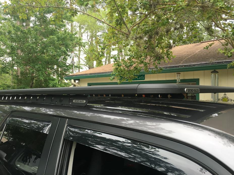

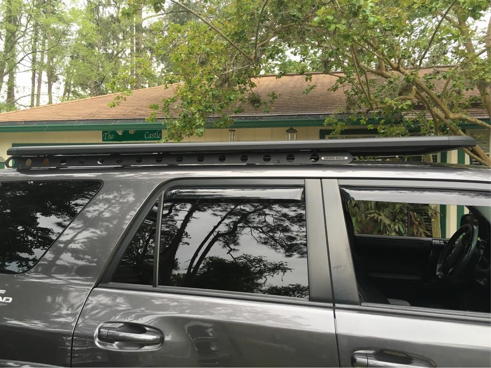

Can you and On Point post a side pick of your racks? I see online a bunch of angled picks, but not a true side pick. I am trying to get a gauge of where the 84 and the 76 stop towards the front of the 4Runner near the driver's side door. If you can post, try to get a near and far pick so that I can really see for sure. Thanks!
i'll post up some pictures tonight for you.
