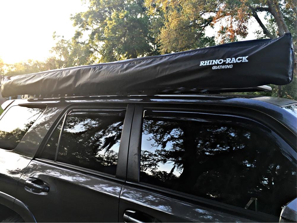

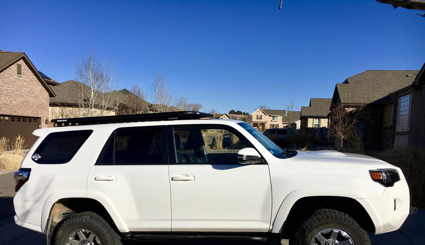

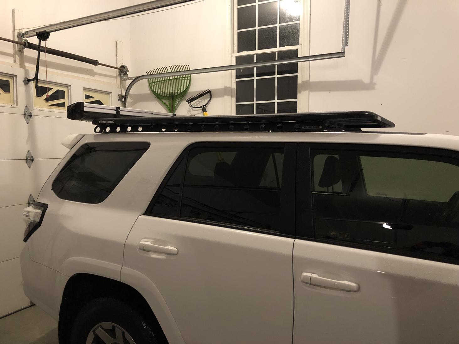

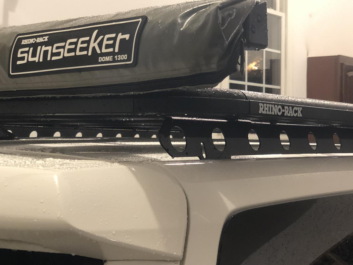

I haven't logged in here for a while, sorry. The only pictures on this computer I have were from the night I started mounting things up and I took it for a quick test drive to check for wind noise in the rain. This is the smaller platform but it seems to fit really well, without a lot of overhang up front. A lightbar will fit under the rack up front but may interfere with the sunroof. I have a friend who has the same rack and the Rhino-Rack lightbar mounts holding a curved 30" bar under his.
Looks fantastic! How do you like the awning??
sneak peek...
I'll be doing a full write up soon! Stay tuned!

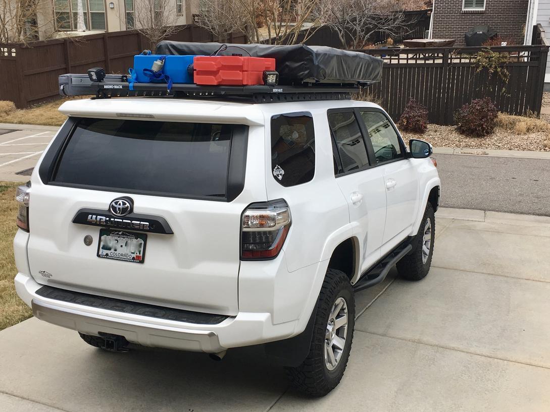

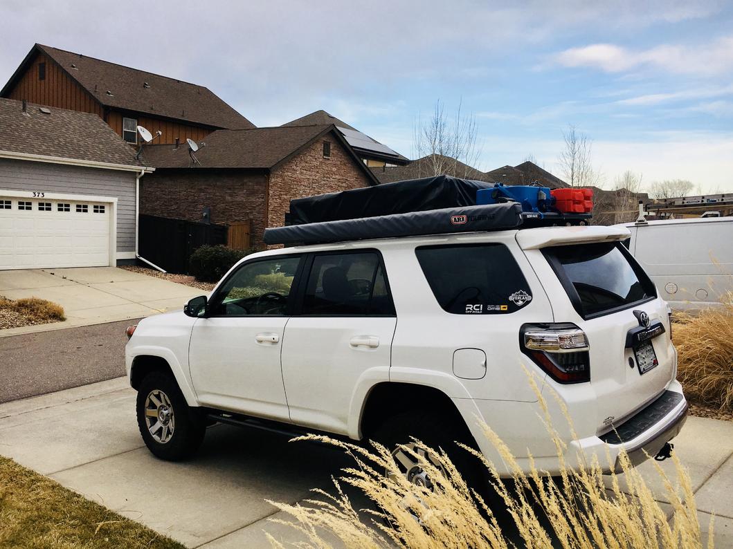

Here is my Rhino-Rack Pioneer Platform. I went with 3/4 length as a no drill compromise for extra storage but still gives me the use of my sunroof. The rack does not interfere with either the rear shark antenna or the sunroof opening. Pics are bare and then loaded for a recent Overlanding trip. No change in MPG or wind noise over the standard roof rack.

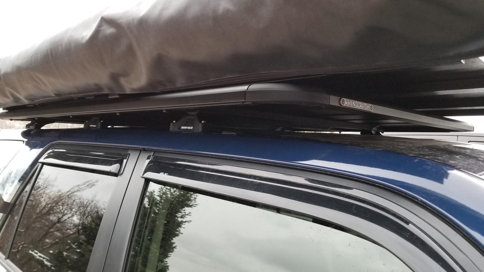

Installed the wider 49" x 76" on 6 of the lower (2-1/4" high) legs and set the Alucab gen 3 and Shadow-Awn on it. Thanks for the write up, helped me choose the Rhino-Rack!

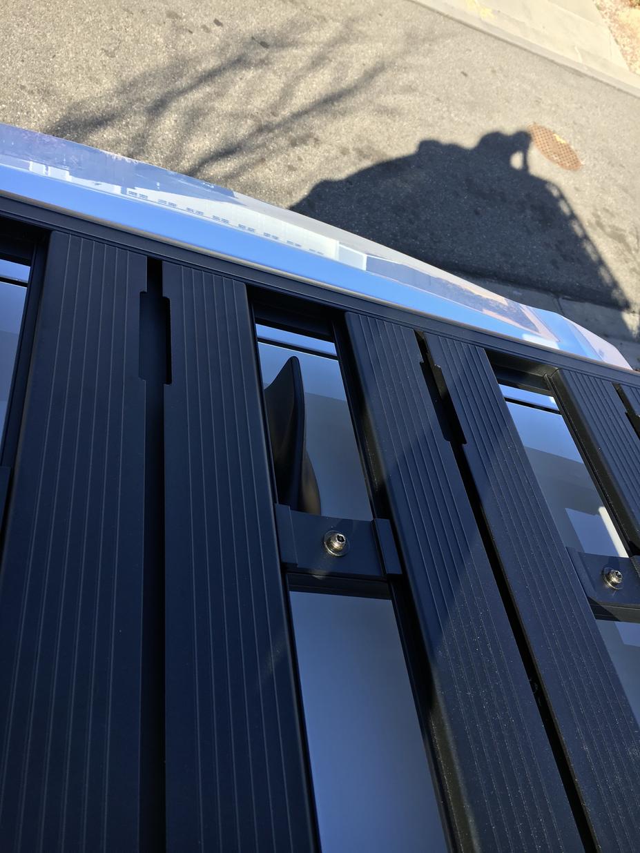

Thanks for the pics. I’m thinking about buying the 3/4 rack too. However, I’m concerned with how much of the sunroof is covered. I’ve searched all over to find a picture of the overhang from inside the vehicle.
If you have time, would you mind posting pictures from inside and on top of the vehicle near the sunroof?
