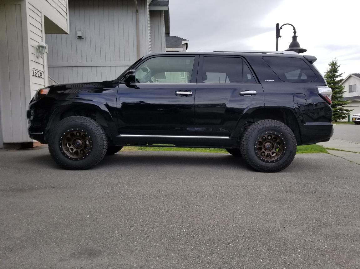

Hi guys. I'm looking to buy a Rhino Rack Pioneer Platform for my 2015 limited 4runner with a moonroof. In not sure which size to get. I want the biggest rack I can get without having to drill the front and or cover my moonroof.
Anyone have pics of their Rhino Rack regardless if you have a moonroof or not. Just want yo see how it will look. Here's a pic of my rig

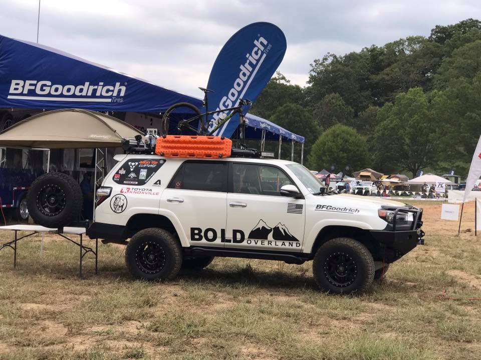

Hey this is Scott from BOLD Overland, as a 2014 Limited owner myself, I was conflicted with the size I wanted to run as well since I had a sunroof. Ultimately I looked at the different lengths and originally went with a 76x49, however this will still over the sunroof. The smallest length you can get will be a 60x49, this will be a tiny footprint and no drilling will be necessary. You need to decide what gear and how you will utilize the rack. Currently we are running the 84x49 pioneer platform to maximize our footprint for all the gear we carry. I can still open and use my sunroof, but the rack does cover it. feel free to contact me if you have more questions, as RhinoRack Ambassadors I will do what I can to answer your questions.

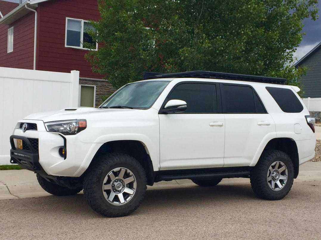

I have the 76" version mounted using the Backbone system. Excellent product, and straight-forward install. Covers about 1/3 of the moonroof.

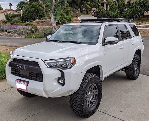

I got the 60 x 49 on my new 2021, looking to probably get the snowboard/ski add-on for winter. Anyone used that accessory or have any other recommendations?
Side note- please ignore my front plate, haven't had a chance to remove it and get other good photos yet :biggrin1:
