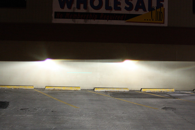

LO beams - the left headlight has been adjusted slightly lower than the right so help eliminate blinding to oncoming traffic. But the difference is minimal. How can anyone argue that when these are "aimed correctly" they don't scatter light EVERYWHERE.
20111123-IMG_0701 by Headlight Hookup, on Flickr

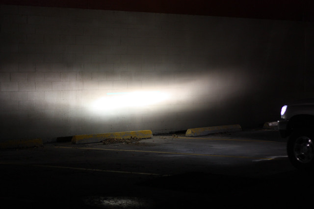

HI beams
20111123-IMG_0704 by Headlight Hookup, on Flickr

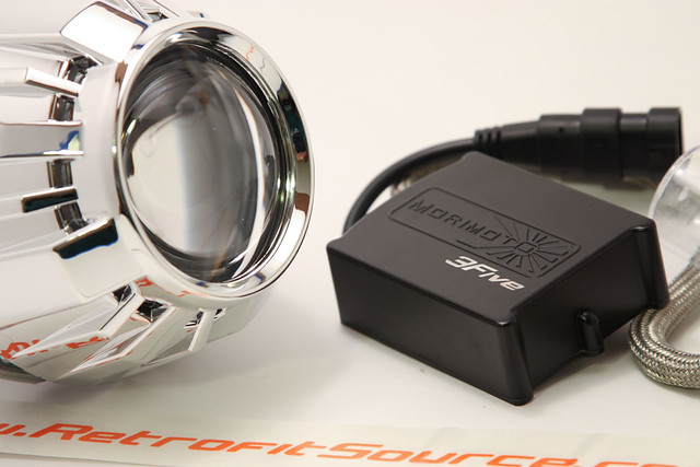

Playing around with my light tent:
20111123-IMG_0710 by Headlight Hookup, on Flickr
20111123-IMG_0707 by Headlight Hookup, on Flickr

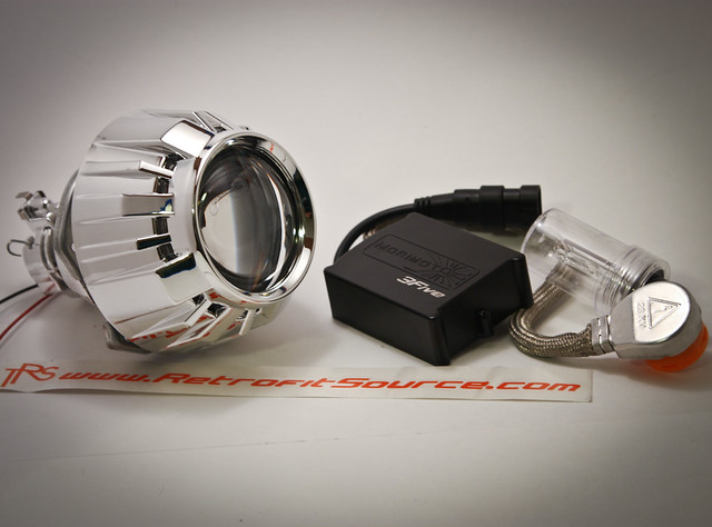

I forgot to post the specs on my new setup above, so here it is:
Projector/headlight specs
- EvoX-R 3" Bi-Xenon Projectors
- 4300k Philips 85122+ bulbs
- TRS HD wiring harness
- Morimoto 3Five ballasts (Gen.2)
- Gatling v2. shrouds
- 90mm angel eyes
- Headlight paint?
- LED DRL's?

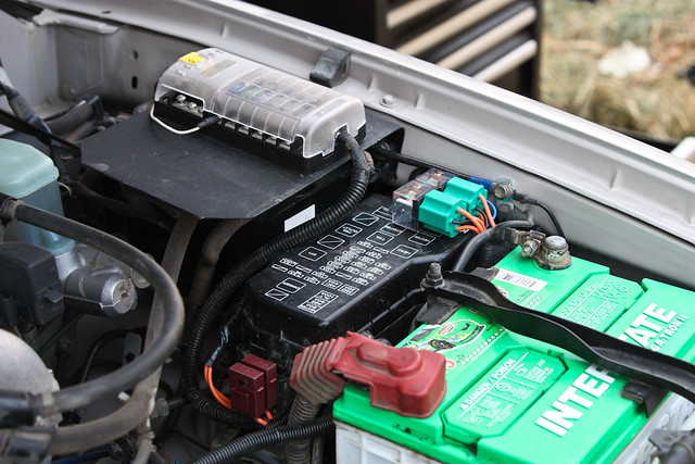

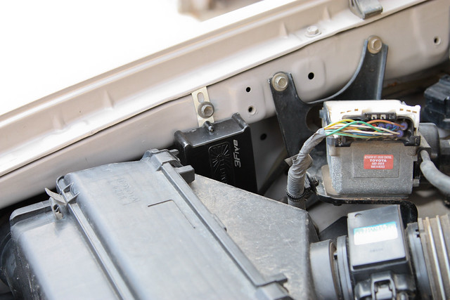

My progress for today: I got the wiring harness and the ballasts installed and ready to roll. Now when it's freezing outside all I need to do is put in the retrofitted headlights and plug them in.
You can see the HD harness has dual relays and fuses. I tried to tuck everything as much out of sight as possible, I like clean and tidy wiring!
20111124-IMG_0728 by Headlight Hookup, on Flickr
Passenger Ballast mounting location:
20111124-IMG_0727 by Headlight Hookup, on Flickr

A little off topic but what kind of fuse box is this?
Blue Sea. More info in my build thread I believe. Got it off ebay, tons of guys on Expo and ih8mud use them and thats where I got the idea. It's a great fuse block!

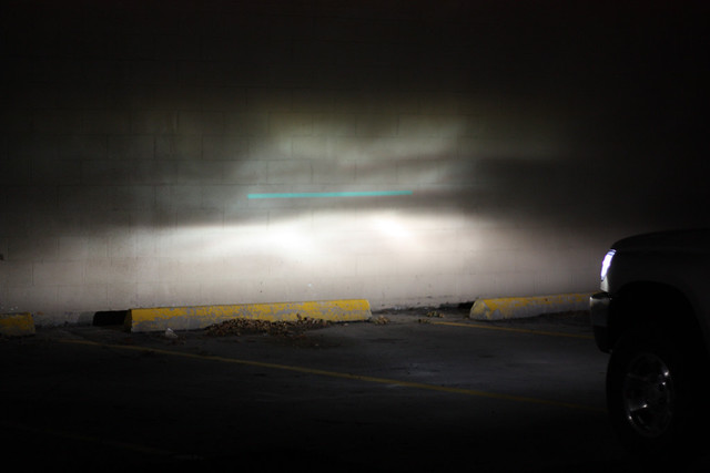

Now I am kind of a perfectionist at this projector stuff. I am VERY imprssed with the dispersion of light and the amount of foreground these have. Here is the output of both projectors side by side when I first turned them on(distance ~30-35ft):
20111129-IMG_0750 by Headlight Hookup, on Flickr

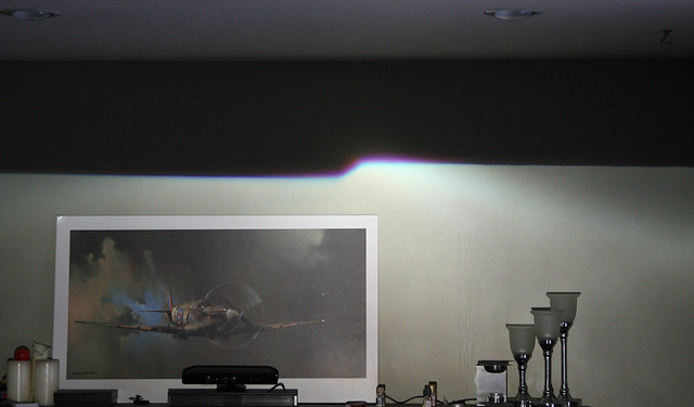

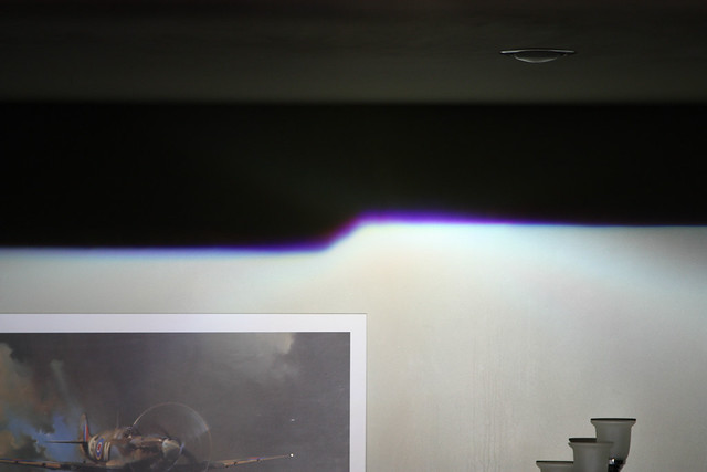

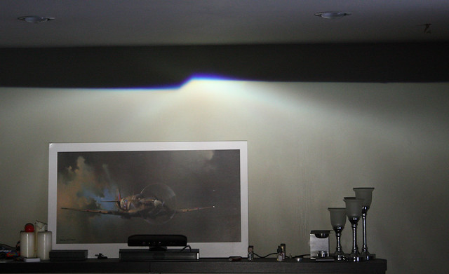

I didn't like the "flare" up of light on the left cutoff and also wasn't happy with how the colour on the cutoff is a little different comparing left vs. right. I am now in the process of "tinkering" and have gotten them pretty close to how I want them. I had to re-adjust the alignment and spacing of the bowl relative to the lens and shield (these particular projectors split in the center, and the two ends are bolted together) I also did some very very minor tweeking to the shield to get more colour. It's a little too blue right now but I can adjust it back. Like I said, getting close, just need to put a little more time in with them.
Here are two comparison shots of the projectors now @~20 ft. (inside my house!) Sorry not side-by-side as I only have one spare ballast currently to work with when these aren't on the truck:
This one is just about perfect...
20111204-IMG_0781 by Headlight Hookup, on Flickr
Just a touch too blue and un-focused still...
20111204-IMG_0780 by Headlight Hookup, on Flickr

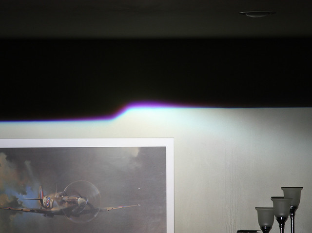

I also had some time a couple days ago to tweak my cutoff sheild a little more, check the matching color band!
20111205-IMG_0786-2 by Headlight Hookup, on Flickr
20111205-IMG_0782-2 by Headlight Hookup, on Flickr

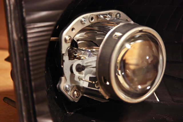

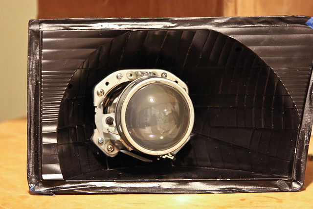

Anyways, after my exam I rushed home eager to get my projectors mounted. I have one test-mounted and the holes drilled for the second, but I ran out of long screws so I couldn't test-mount the second one. Here are a couple pointless photos of my progress:

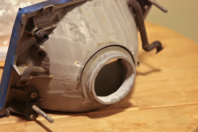

Here is the back of the housing. You can see how I cut all of the H4 mounts out of the way and used my Dremel to get a relatively smooth surface.
20111207-IMG_0787 by Headlight Hookup, on Flickr
Projector mounted. I'm really liking the big 3" lens and how it fills the boring space in the 4Runner reflector bowl. Paint is after 2 coats of primer and 2 coats of low gloss black. Then I did a wet 600 grit sand. Waiting for the projector mounts to be complete before I spray the final black coats.
20111207-IMG_0790 by Headlight Hookup, on Flickr
Close-up. One thing I really like about these EvoX-R projectors is the various mounting holes on the outer edge. Makes it easy to choose the best mounting point.
20111207-IMG_0791 by Headlight Hookup, on Flickr
