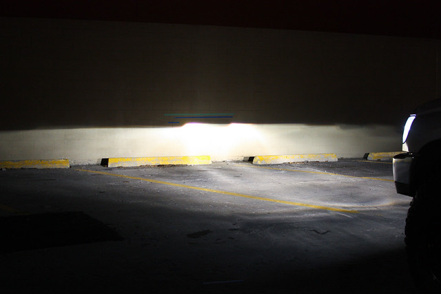

Before (Low beams):
20111123-IMG_0701 by Headlight Hookup, on Flickr

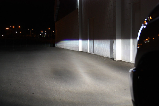

After (Low beams):
20120109-IMG_0960 by Headlight Hookup, on Flickr
Before (High beam):
20111123-IMG_0704 by Headlight Hookup, on Flickr

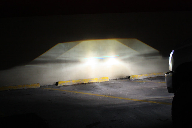

After (High beam):
20120109-IMG_0979 by Headlight Hookup, on Flickr

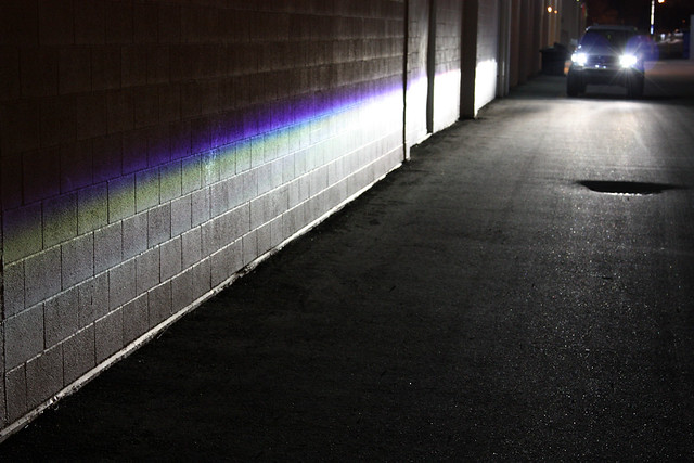

mmmmm cutoff shots.... you can see why it's "cool" to tinker with the colour on the cutoff step, just looks BA!
20120109-IMG_0966 by Headlight Hookup, on Flickr
20120109-IMG_0964 by Headlight Hookup, on Flickr

How far away are you from the wall and whats the height of that piece of tape? I for got to take measurements for mine prior to doing my lift. Retrofit is currently in the works.

You should not need this info at all white doing the retrofit. The distance and height of tape is used AFTERyour retrofit is complete and you are aiming your headlights properly to avoid blinding oncoming traffic. Pull your headlight out of your truck and set up a jig on a table or chair. Shoot the halogen beam pattern on a wall about 10-15 feet away and match the beam pattern with tape on the wall. The retrofit your lights and match the projectors output to that of the tape on the wall. Do this for both sides. And that's the real quick and dirty version of how to do a retrofit haha....

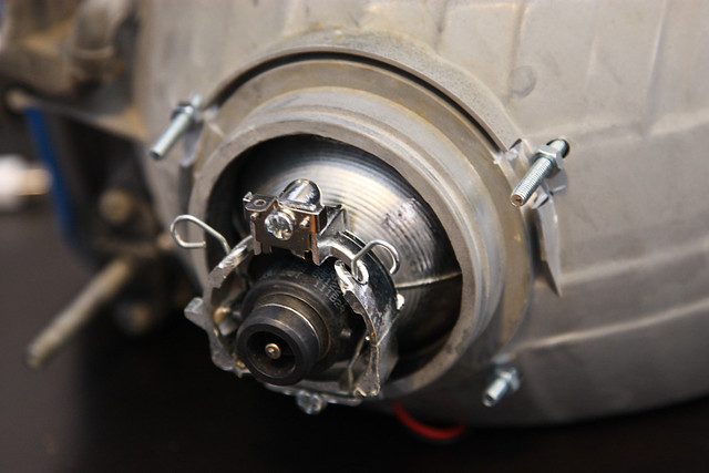

1) It is better to use the OEM Kioto (sp?) housings if possible. It's not a complete deal break but they are better made and generally, have less play in the mounting mechanisms. The "play" (if any) on a non-OEM housing will cause your horizontal alignment of the projectors to be off. Buy some DEPO's and pull the brand new DEPO lenses off. Then retrofit your Kioto headlights and put the new DEPO lenses on the Kioto housings upon completion.
2) Yes, I did Dremel out the back of the housings. If at all, or how much, will depend on the projectors you choose. Which PnP kit from TRS are you looking at? I like the Morimoto Mini H1 v4.1 for an "easy" projector. If you contact TRS they can probably create a PnP kit with whatever projectors you choose.

Edit: You can see in the pic below, where I cut the housing. I trimmed all the excess off the headlights that was inside the diameter of the circle ring on the back of the housings. Where the projector pokes through, it was trimmed all around. Also, I filled that gap between the back of the projector and the circle shape on the back of the housing, with Silicone II. (I completely filled that space with silicone, as I wanted to make sure it was 100% sealed)
20111214-IMG_0815 by Headlight Hookup, on Flickr

Sure, grab some from the junkyard but you DO NEED some 99+ clear glass lenses to go with the retrofit. The 96-98 headlight lenses will not work. Also you dont want lenses with chips and scratches as that will diminish light output.
Cutting is easy, just go slow and even use the Dremel sanding bit so you can do it little by little if you want. Look at the pic above, there is a large circle ridge already on the housing and you pretty much just cut along the inside of that edge. Also remember it doesnt need to be perfect as the projector will be covering up the hole from the front and you will never see it. Although cutting it cleanly, will make it easier to seal up afterwards.

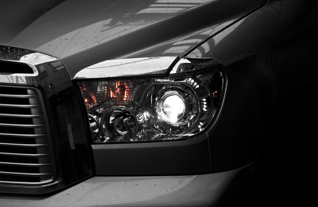

update
Instead of starting a new thread, I thought I would just keep posting some of my other retrofits as I complete them.

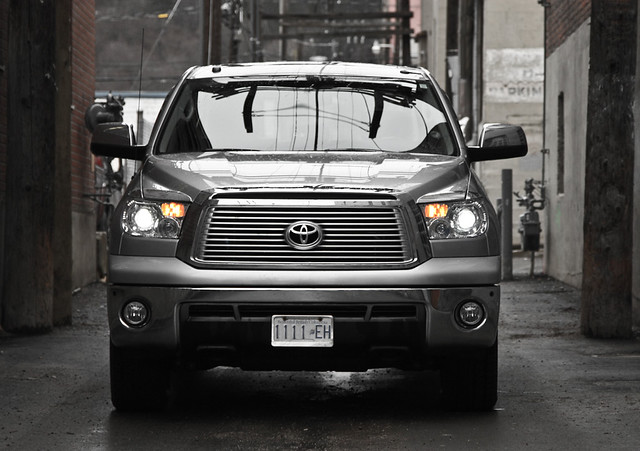

This weekend I headed back to BC for a few days to retrofit my Dad's 2010 Tundra Platinum. I think they turned out great! I wanted to keep them super clean and low profile, or OEM looking and to match the silver theme going on his truck. My Dad wanted something a little special to make them stand out and convinced me to do some custom LED driving lights.
20120221-IMG_1034 by Headlight Hookup, on Flickr
Retrofit specs:
FX-R projectors
Apollo Shrouds
Morimoto 3Five 5000K bulbs/ballasts
Custom LED DRL's
Tinted parking lamp lenses

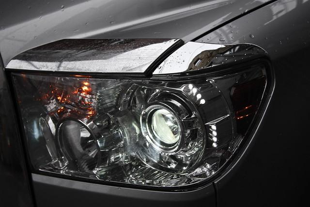

A couple more:
20120221-IMG_1036 by Headlight Hookup, on Flickr
20120221-IMG_1037 by Headlight Hookup, on Flickr
Pretty cool too that these trucks have a small motor attached to the headlight adjustment screws so you can actually adjust the height of the headlight from a roller-switch inside the cab. I may even try to make this work with my 4Runner headlights.... When the truck gets loaded down you can adjust the headlights back towards the ground to avoid blinding people, or in our case, aim them farther down when we lift our trucks higher. lol
