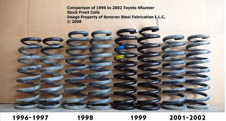

You should be more specific on which Bilsteins you want to use. (HD 4600's, Tundra, 4th gen, 3rd gen, etc) Use your stock front coils with new 4runner 5100's until you find a set of 99's. There's not much difference between the 2. 2000's are around the same height as the 98's.
