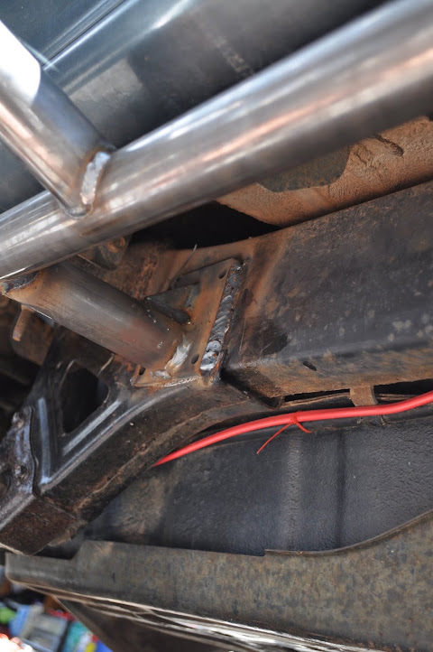

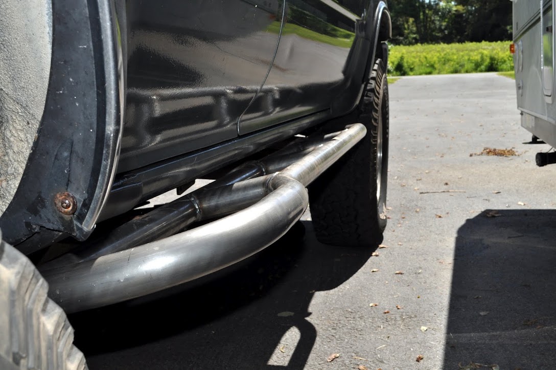

After I got Honey Badger breathing better I hit some trails. Ended up getting some dents, and decided that it was time for some side protection. Shopped around, and found 4xInnovations. Really liked the engineering, and looks of the sliders, and rear bumper.
Since I'm not a welder I took it to a local shop, and they did a great job of installing the sliders.
They are the DOM steel with kick outs.
Nice welds! Welded to the frame.
On the top of the tube you can see where the shop welded on the biscuits. Be sure and use them if you are installing them yourself. It helps to reinforce the sliders.
Next step - cover up the bare metal! I used Dupli-Color bed liner, and applied five coats. Reason for this - when they get scratched it's very easy to touch up, and gives a non-slip surface for those times when you or someone else is using them to either get in or out of the vehicle, or out of a stuck situation.
