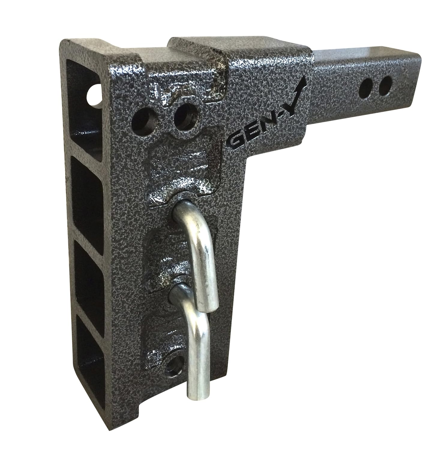

The Hitch Gate installs in the 2" receiver that was built into my 4xInnovations bumper. Problem - could not lower the tail gate all the way. Here's my solution:
GenY Drop Hitch,Dual Receiver,Adjustable 2" Solid Shaft,Dual Receiver Hitch,drop/raise 7.5",with two 5/8"Pins "Hitch Only"
It does put the Hitch Gate out back a little more, and may hit when going over obstacles, but the whole thing is easy to remove for more serious wheeling. For Over Landing - perfect.

Initial test fit - can't lower the tail gate. Hmmmm... What to do....
This should do the trick!
You can see it's still higher that the rear diff

Here's the final installation - along with the optional gas can carrier. Should do the trick. If there's any problems I'll update as necessary.

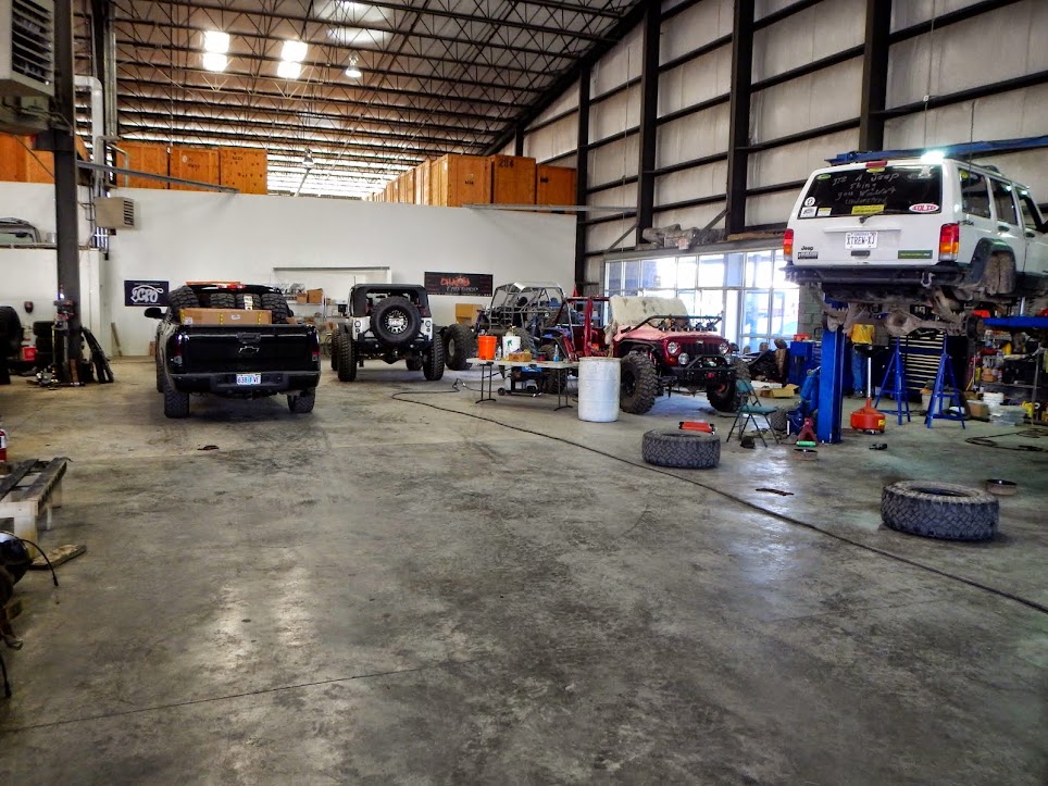

The Rough Country rear control arms just aren't up to any type of serious off roading adventures. This is the second time I snapped an upper control arm.
Time to get serious! So I drove on down to Chaos Off Road to get some control arms.
These should do the trick!
Also snapped the rear anti-sway bar (no pictures -- yet) so they are going to fab up something a lot stronger.
I'll take more pictures next week when everything is ready for installation!
:high5:
They also own and run Chaos Off Road Park near Capon Bridge VA. After the installation I'll be heading over there to test out the new installs.
