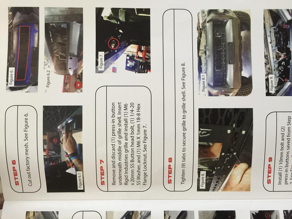

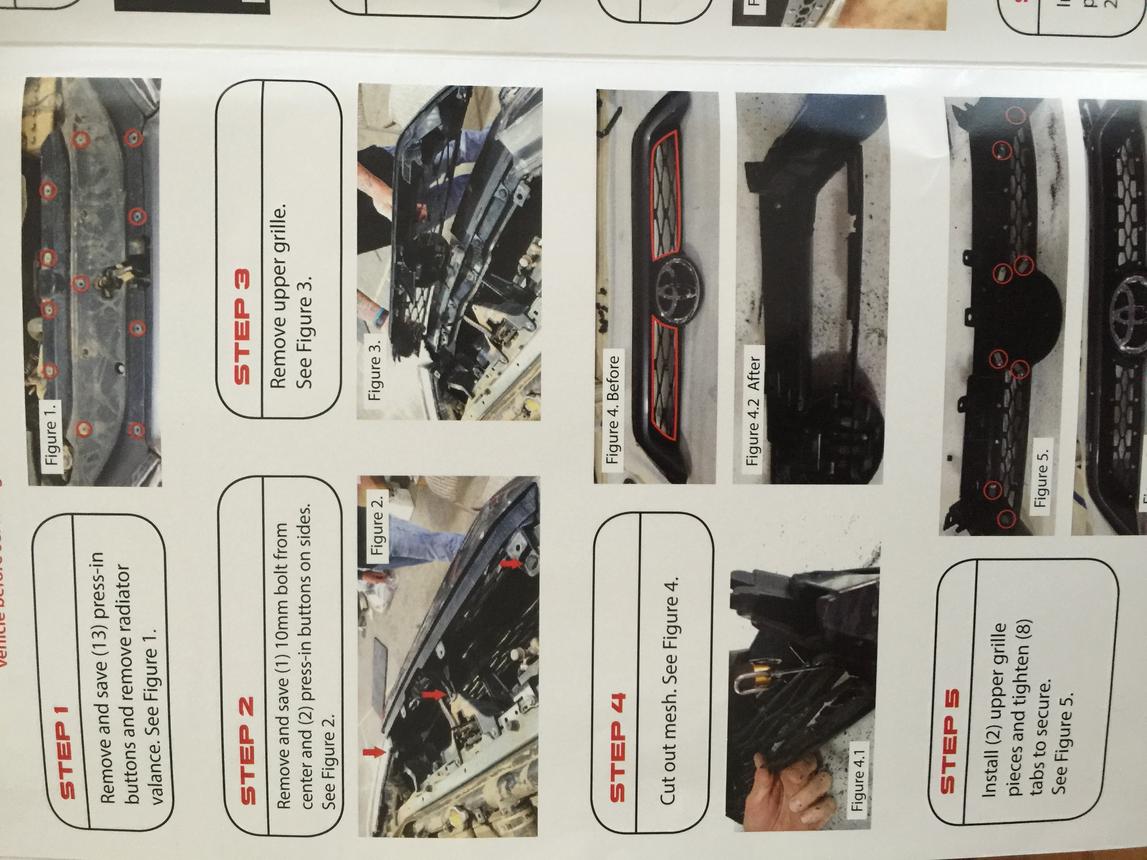

Are they going to offer a version of the upper grill for the TRD pro? Because I see the upper part is included with this but I have the TRD pro grill coming now. Also instructions say I have to mod my $150+ OEM grill to install.

Installation generally requires cutting out the grill to reuse parts for installation, it's not just popping out the old and putting in the new. It's not hard but you have to commit.

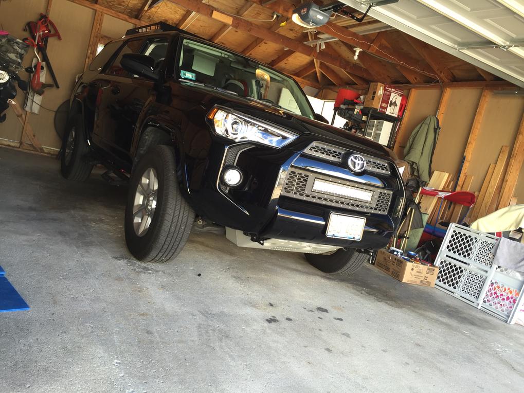

Got mine installed about a month ago.

Just installed on my 2016 SR5 looks great if not for the insane stupid price for three pieces of sheet metal and shiny bolts, which is why I bought mine used on Amazon along with my review and comments. I'm sure some of us have the means for such items but we're not stupid to know what's not a fair retail price So most will not buy because of this. if it's exclusive now it will be copied for much less and lose out in the end, rant off. Also from Amazon is the Nfab roof rack and Nfab nerf bars and spydertraxx spacers. Installed TRD skid plate from eBay.Saved a lot using Amazon points on one item and flipping them on new item, Amazon plays the price game so today it's one price and next day 50 bucks less. So after purchase wait to install if a better price comes up return it and get the better price, Amazon doesn't post price match!. FYI. Have the Toytech ultimate lift kit already not installed but new wheels and tires are pricey so waiting for more overtime. Oh the instructions are crap if I wasn't so crafty it would of been a solid waste of money and a grill. Install took 6hrs total over 2days to do a great job with crappy instructions. So professional install is not a option!!!!
