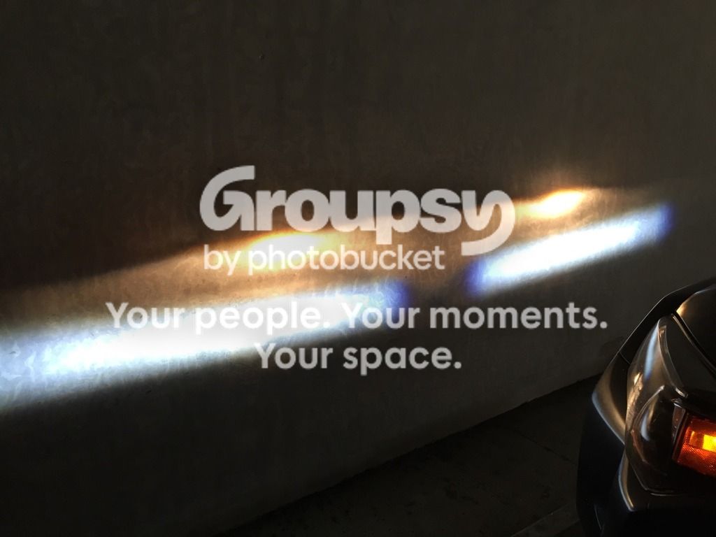

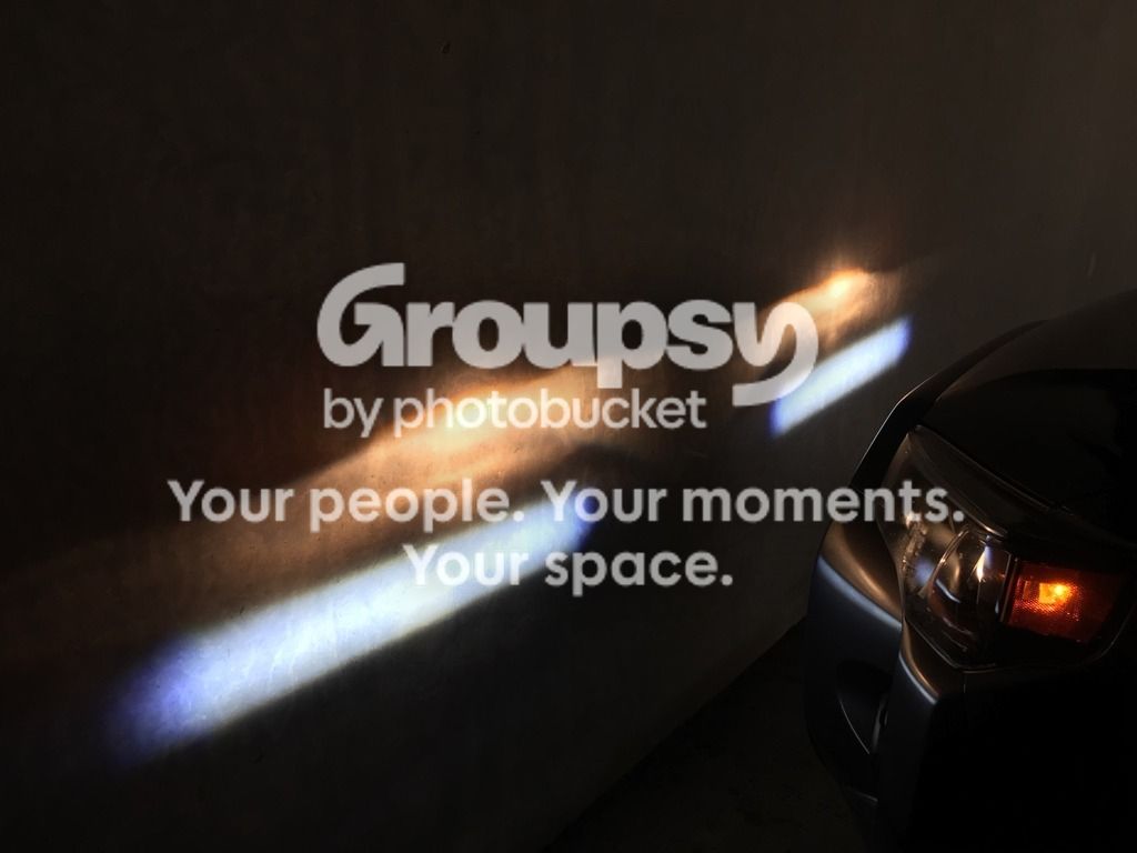

Well it didn’t make too much of a difference. Actually I made it a bit worse cause the driver’s side is angled up now so I need to fix that. Judging from other forums, it seems my fog lights are roughly aimed about the same distance underneath the headlight beam.
2.5 feet

4 feet

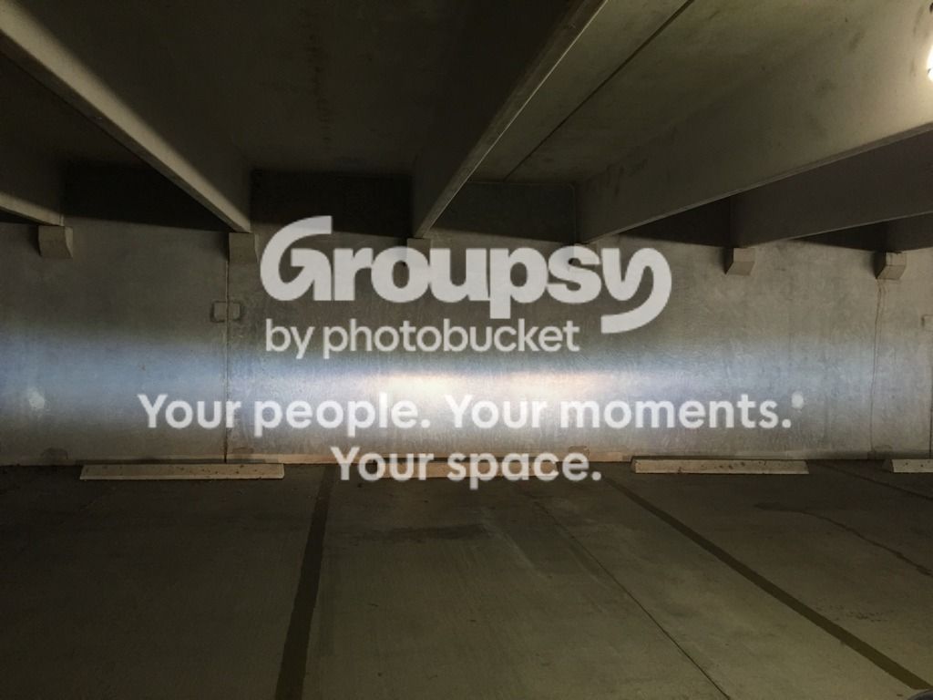

However when I go further back, about 30 feet away (disregarding the angled up driver’s side fog light), you can see the fog light cut off start to be around the headlight beam cut off. I’ll have to adjust it a bit more.

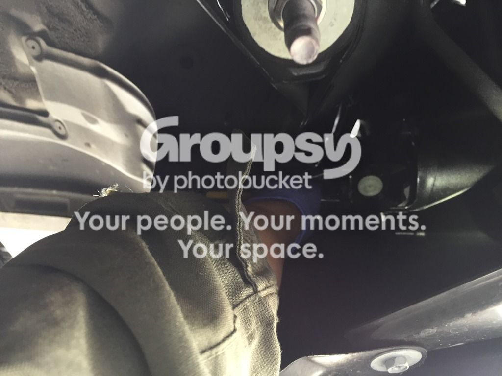

Although you can work from under the car on this side, I recommend removing the wheel well plastic liner. Just removed the bottom screw and then the following 3 screws going up the side of the wheel well.
The amount room you have to work from under the car:
IMG_4650%20copy_zpsoljzmmpg.jpg~original
Not terrible.

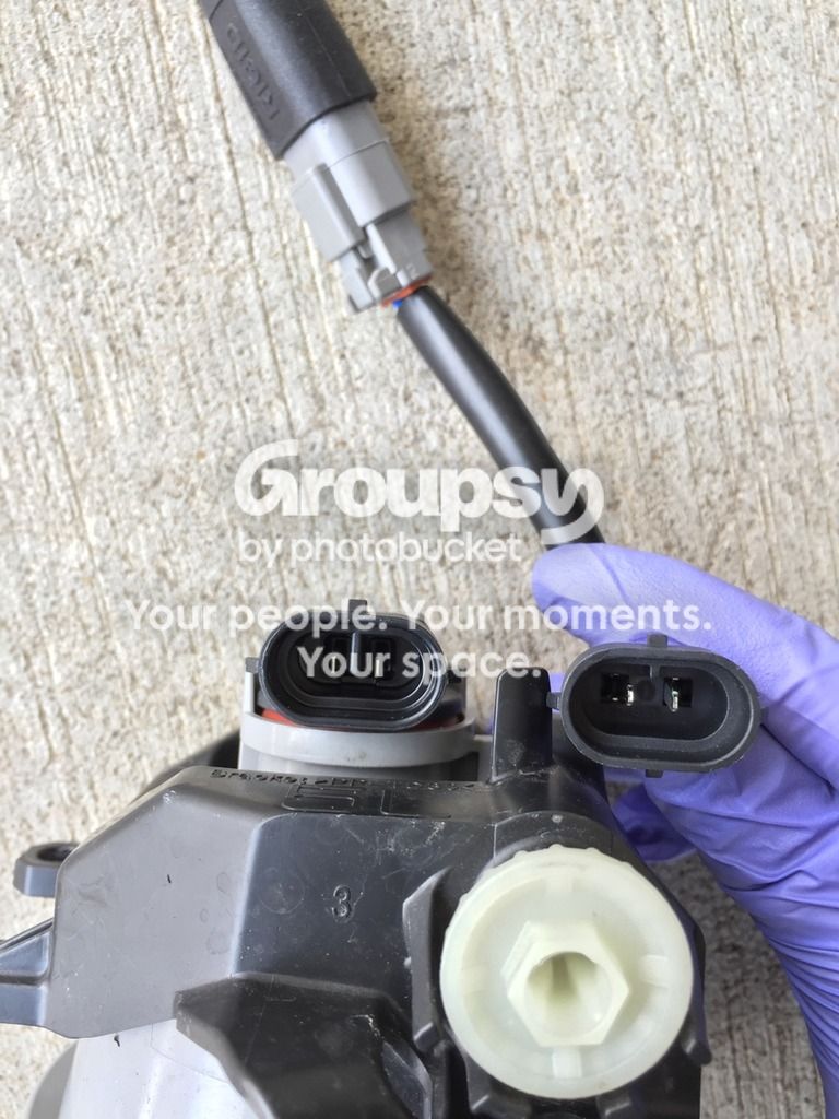

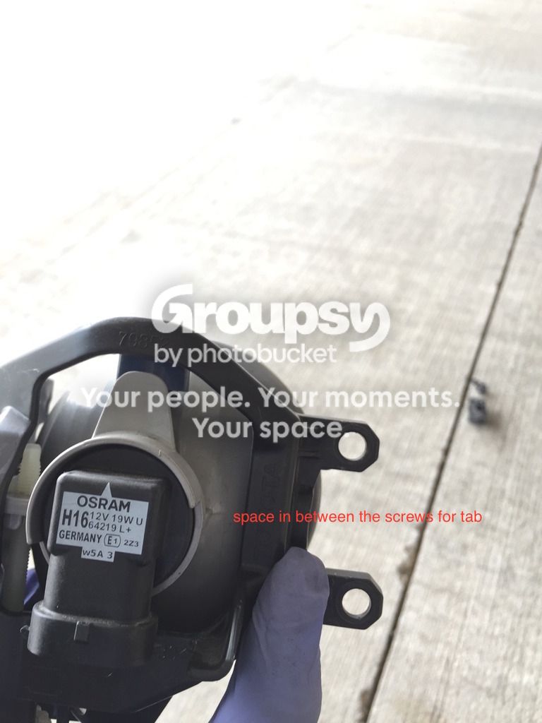

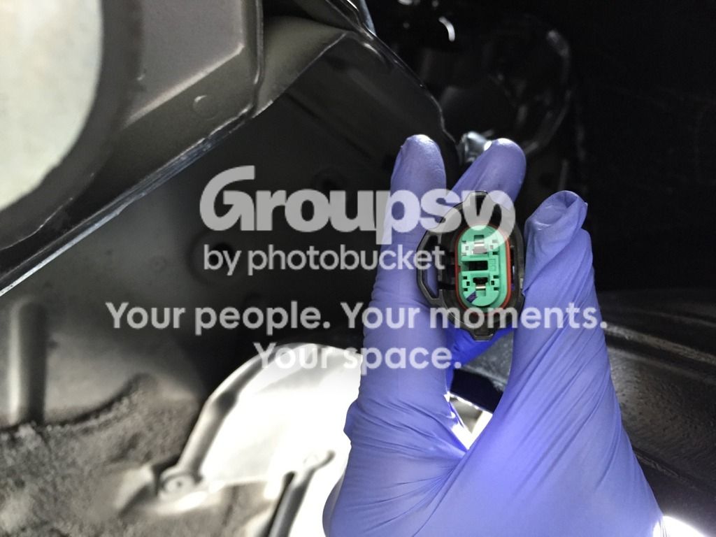

If you use the MRT harness form TotalAutomotiveLV, it plugs right in like this.
OEM H16 connector on the left, H16 adapter on the right.
IMG_4655%20copy_zpspbda5eew.jpg~original
Match the “groove” to the vehicle fog light H16 plug.
IMG_4657%20copy_zpscc2w5f4s.jpg~original
This is the “plastic fog light housing groove” you want the Rigid bracket tab to insert “in front of”/anterior to:
IMG_4668%20copy_zpsw0rylpn7.jpg~original
I didn’t take a picture of the front view of the driver's side “plastic fog light housing groove” but I’ll show the front view of the PASSENGER side
IMG_4673%20groove%20copy%20_zpsexf3iitm.jpg~original

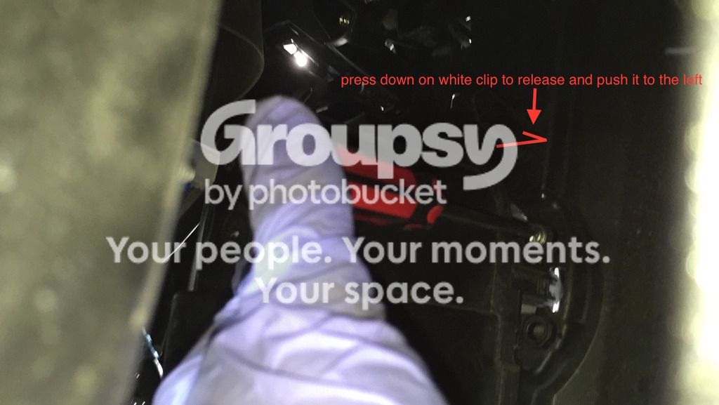

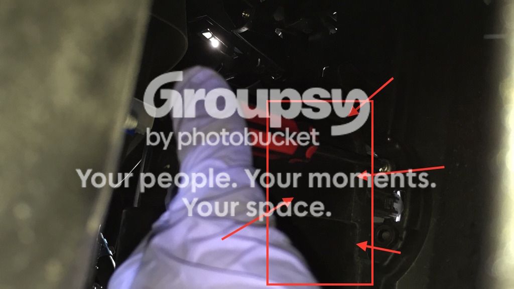

I tried removing the OEM fog light from under the car on this side – very difficult. I’d go ahead and remove 5 screws on the wheel well plastic liner. Like on the driver's side wheel well, removed the bottom screw and then the following 3 screws going up the side of the wheel well, BUT ALSO remove another screw on top (it will be above the actually bumper).

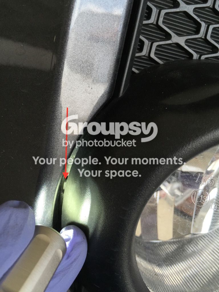

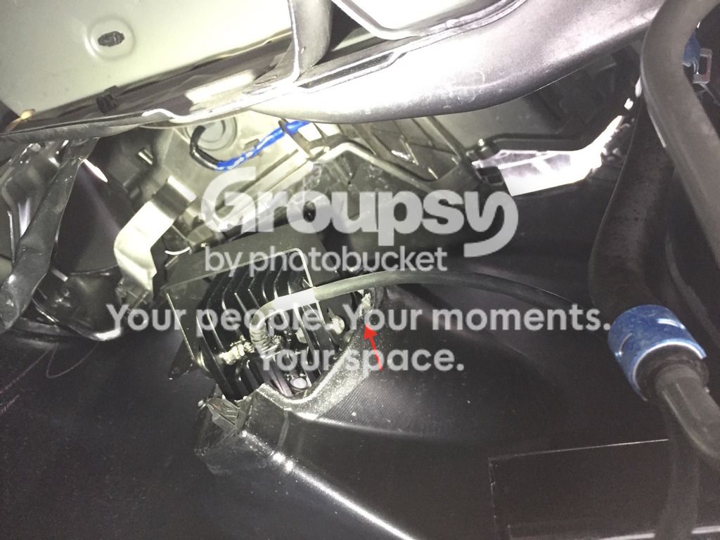

Looking towards front of car from inside the passenger side wheel well. This will be the white clip that helps hold in the “front boomerang plastic piece” of the outside of bumper. (red imaginary clip in the picture because I took out the real white clip before I snapped the photo)
IMG_4670%20copy_zpsv6xqazvy.jpg~original
**In hindsight maybe it was better to take the “boomerang piece” out in the first place like kevinmai712 did. I didn’t so I can’t tell you how to, but I don’t imagine it to be too difficult.

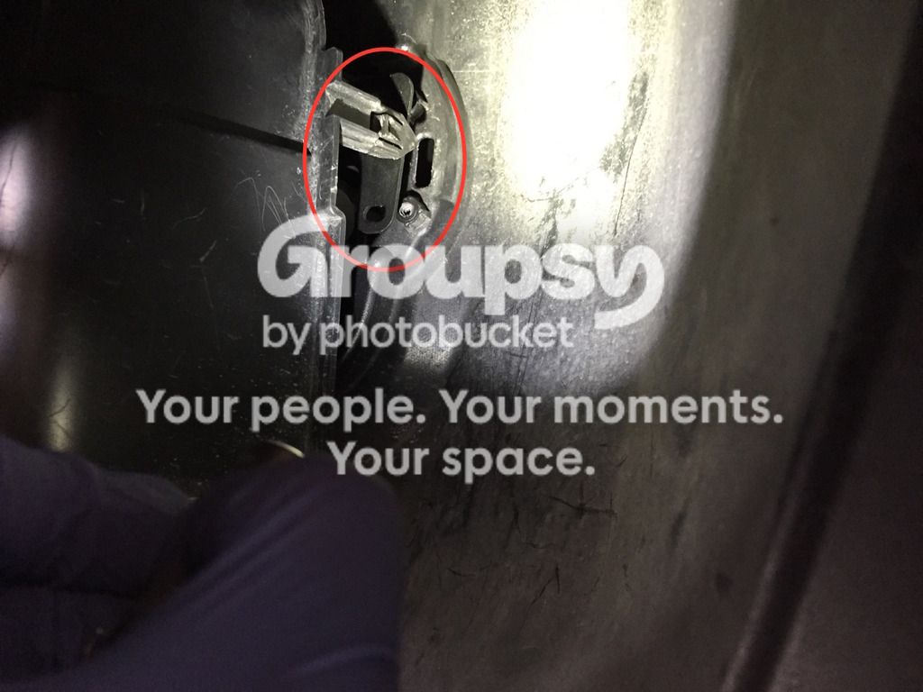

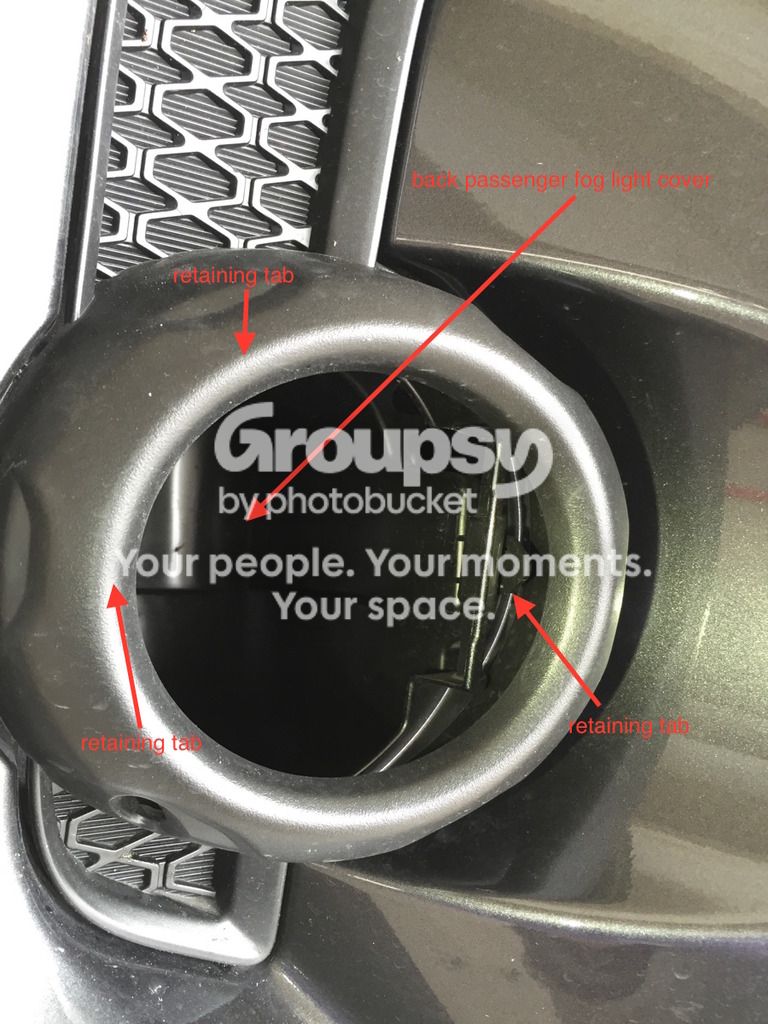

Remove the white clip so you can wiggle the “boomerang” more easily. Then you can access the retainer tab of the “back passenger fog light cover” on the left (left as in when you are facing the front of the car). I used a screw driver to press down on the retainer tab to release it. Be careful not to scratch your car.
the cover retain tab:
IMG_4669%20copy_zps1jc8t7fq.jpg~original
Back passenger fog light cover (view from back):
IMG_4671%20copy_zpsa8mgtwjc.jpg~original
After you release this retainer tab, you should be able to take the passenger OEM fog light out now.
2.5 feet

4 feet

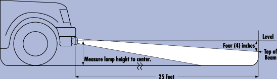

Let's look to the guy known for lighting expertise on aim: Daniel Stern. here
If the fog light is 28" or more from the ground, then a 4" lowering at 25ft is appropriate. If the fog light is 18.5"-28" from the ground, then it is only 3". I'm not going to measure it out right now, but those are the regulations.
