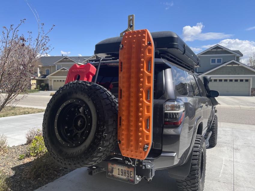

Awesome setup!
Can you actually install a bike rack on that hitch where you have that D ring shackle?

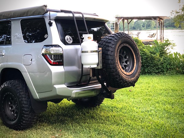

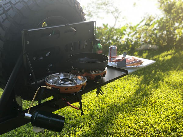

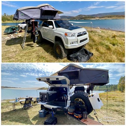

The ultraswing has two 2” receivers. The part that actually inserts into the receiver for mounting will accept a receiver hitch thats acceptable for towing WITH the ultraswing. Theres a second non tow rated receiver on the swing arm. This is for accessories like bike racks that allow the entire rack to swing open for access to rear hatch. I had a mount built for mine that allows me to put a 2.5 gallon propane tank there for cooking on the included table.
I have been extremely pleased with this product and they are prompt with answers to questions and are a pleasure to do business with.
Like others, I wired lights in using a trailer harness with two of the led bolt lights in the unused top license plate holes. Simple enough.
Departure angle... it very well may be more drag prone than stock, but not having to wrestle a ~95lb wheel/tire under the vehicle is reason enough for me. The table is super convenient, and I was able to add the propane bottle. I do a lot of offroading but little to no rock crawling. It suits my needs. If I were using the truck differently Id have built it differently.
I know...pictures or it didnt happen.

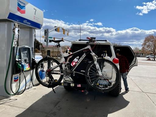

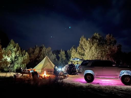

Just wanted to share my experience with the Rigd Ultraswing. In short, I love it. Yes, it was a chunk of change to purchase, but I absolutely love the convenience it provides. I almost always have my 1UP bike rack with a mountain bike on the back of my 4Runner. It was becoming a quite a pain to always have to lean over the bike rack to access the rear hatch. When the bike was on it, it was impossible. With the Ultraswing, it's so simple to swing the bike and rack out of the way making it much easier to access the hatch. I can now actually sit on the rear bumper to change into my bike shoes, etc. Makes putting big items in it much easier as well. It may sound minor, but I cannot tell you how much more convenient it is now as I ride several times a week. I also upgraded to 285/70 tires and it's nice to have the spare mounted on the Ultraswing. Love the table also. Also know that their customer service is excellent. I had a minor issue with how my bike rack fit and they were very responsive by providing a part to address the issue. The only issue is you do have to pay attention to the position of the handle as you open and close the rear hatch, etc. Would highly recommend if you can swing it! (Pun intended).
Hey what kind of issue did you have the 1up ? I run the same rack and am considering this as well.
Also does the offset hitch make your bike hang over one side or do you compensate for that with the 1up arms ?
Would love to see a pic with the rack & bike on from behind your rig.
Thx
How did you like how your bike rack mounted to the ultra swing ? Did you use the Wobnoy ? I read in the reviews that one person said it still wobbles ?

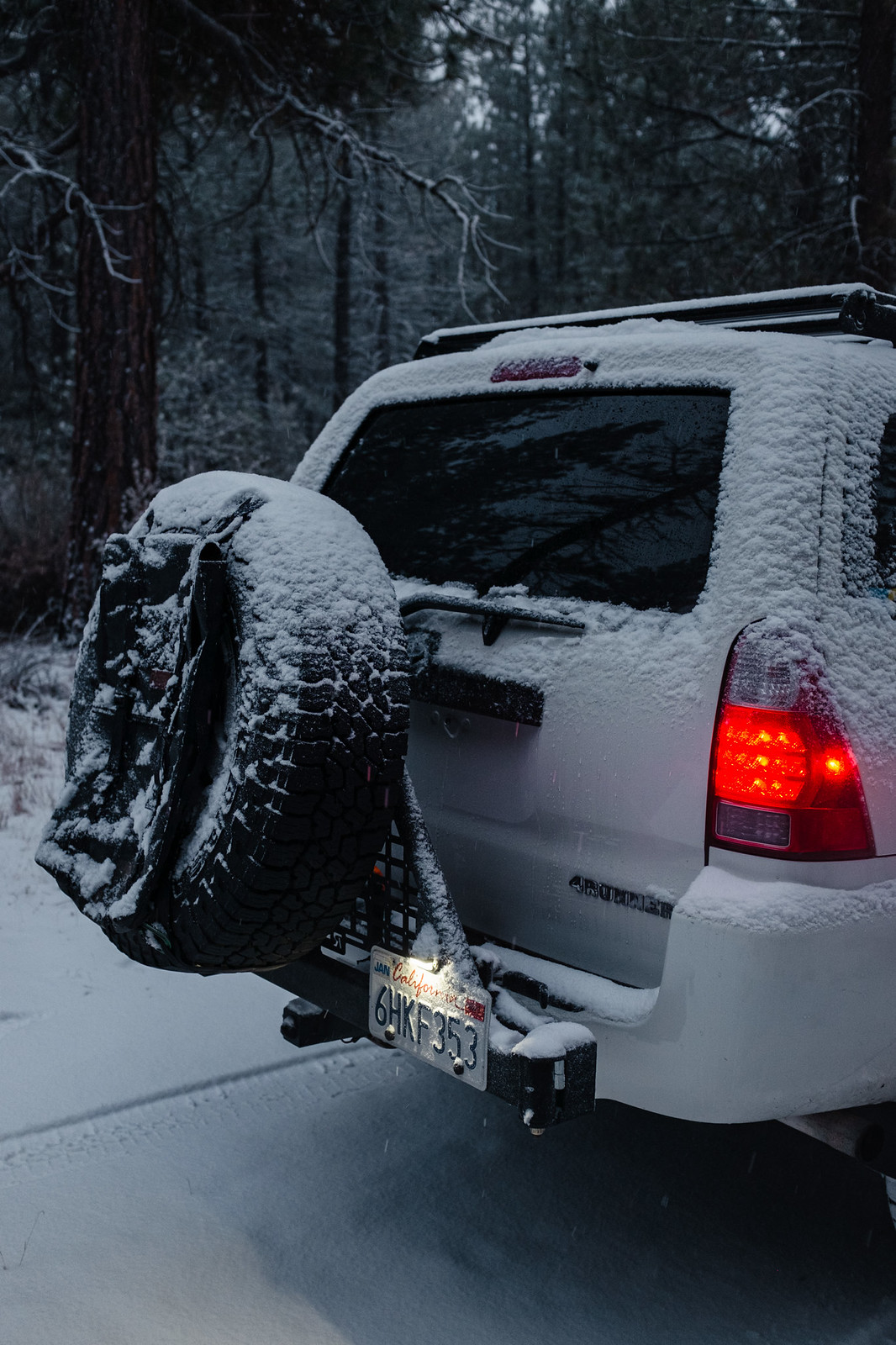

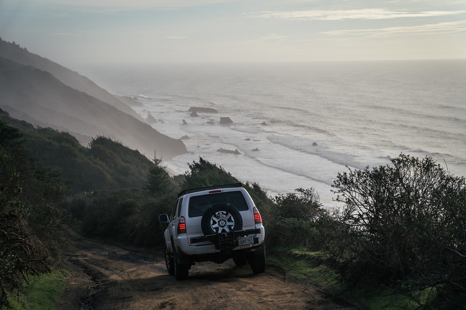

Mine is mounted on a 4th gen but I think all these things apply. I love mine! The main reason I got it was to haul bikes on camping trips and not have to fuss around and unload them to access the cargo space. I got mine right when they were released, so reliability-wise - top notch!
[url=https://flic.kr/p/T5Xejb]

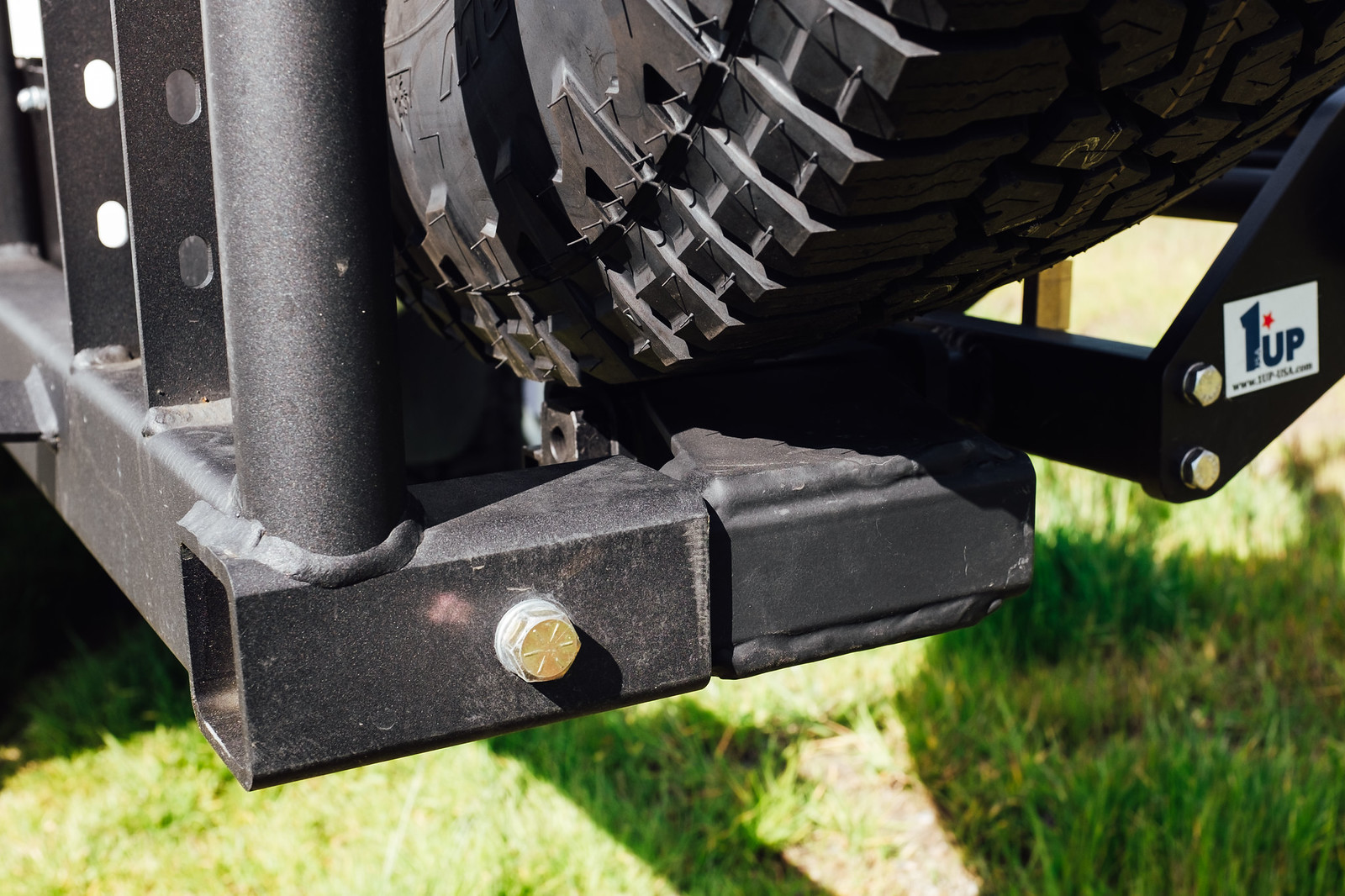

Since I'm using a 1-up rack, I wanted to recenter the rack. I got [URL="https://www.amazon.com/gp/product/B003YJK3R4/ref=as_li_tl?ie=UTF8&camp=1789&creative=9325&creativeASIN=B003YJK3R4&linkCode=as2&tag=ccbelisle-20&linkId=7e597748f9aeaca3237fbc1502e549fe"]this
to recenter the rack. I mount it sideways and drilled some new holes for the pin. No issues at all.

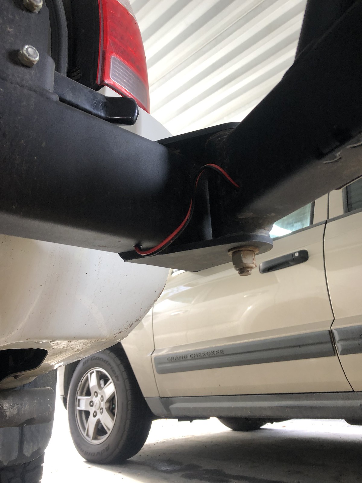

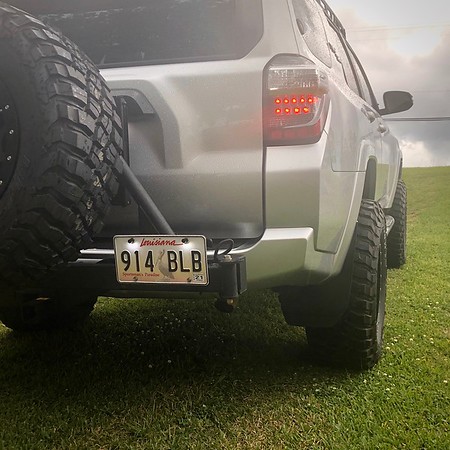

I also ran some license plate wires internally. I'm sure it's not recommended, but it works great and is super clean.

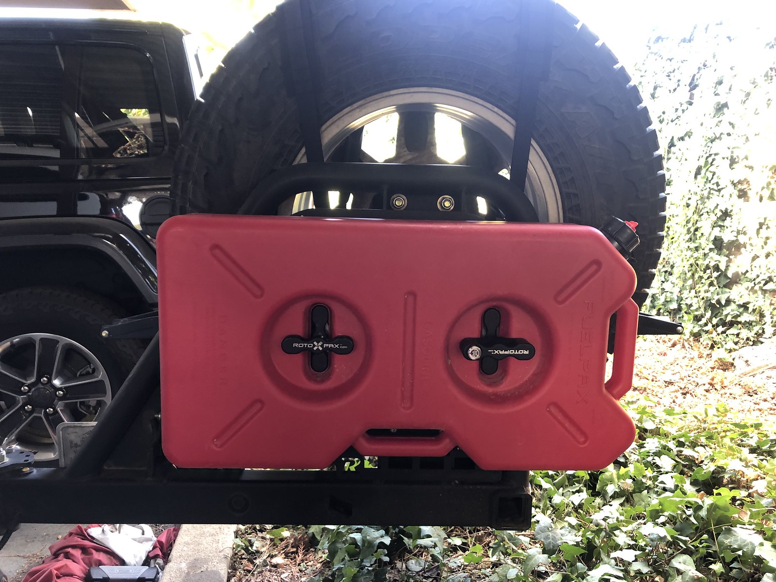

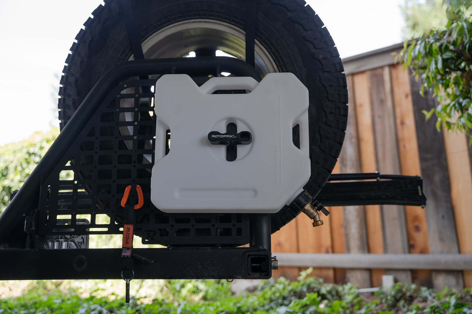

And I also use this to haul water or gas, depending on the trip.
