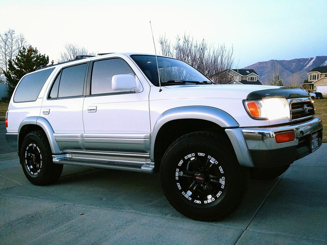

AGREED!!! the limited flares with stock tires makes it look like a grandma should be driving it lol 285s on 4" backspacing fill the fenders really nicely honestly. I even have some extrusion from my rear tires past my fender. just the sidewall though. BFAD's rig was the reason that i got my PC 7069s lol I love that rim as i cant run spacers in utah. (damned stupid safely laws) they had a great backspacing.

I've got 16x8 s with 4.5" BS and -6 offset. On road and off road I don't have any significant rubbing. The only rubbing I have is at full lock, the very bottom of my bumper valance will catch...but no damage has occurred from the rubbing. And I'm running 285s...I have the black SR5 flares, and my tires stick out about 1" past the flares...I love the stance.
