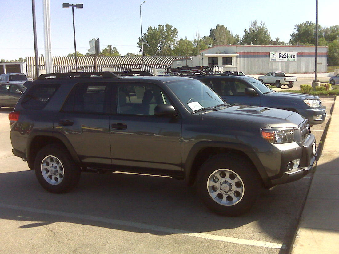

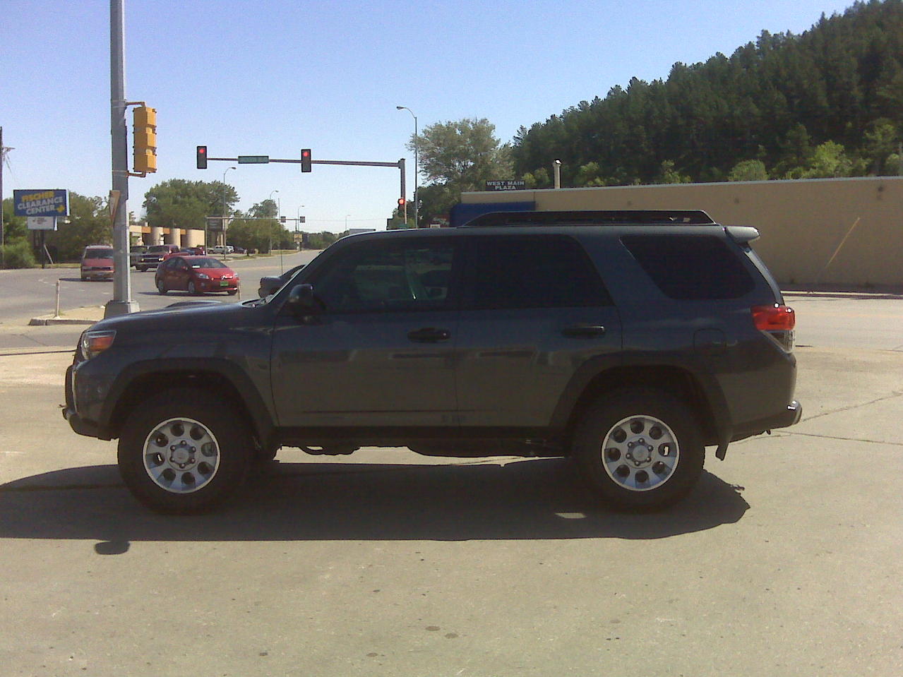

Ok well here are the results the top out spacer from toytec actually lifted the front 2in from 34 1/4 to 36 1/4 at the fender well as mentioned before it doesn't affect the ride since it is a topout spacer took them alittle longer due to the huge sway bars next week the rims should be on. Let me know what you guys think

that does look better! would like to see some more (less dark) pics!
What's the measurement to the rear wheel well? Would you consider it "leveled". Are you happy with the spacers?
The rear is at 37 1/4 the spacer isn't a big preload spacer it is actually only about a half inch think and gets bolted to the top of the strut so it rides like just as good as factory I had the same spacer on my 04 for about 2 years or so never any problems. It must be the photo for you sandcrawler but it is defiantly 2 inches higher up front then stock.
