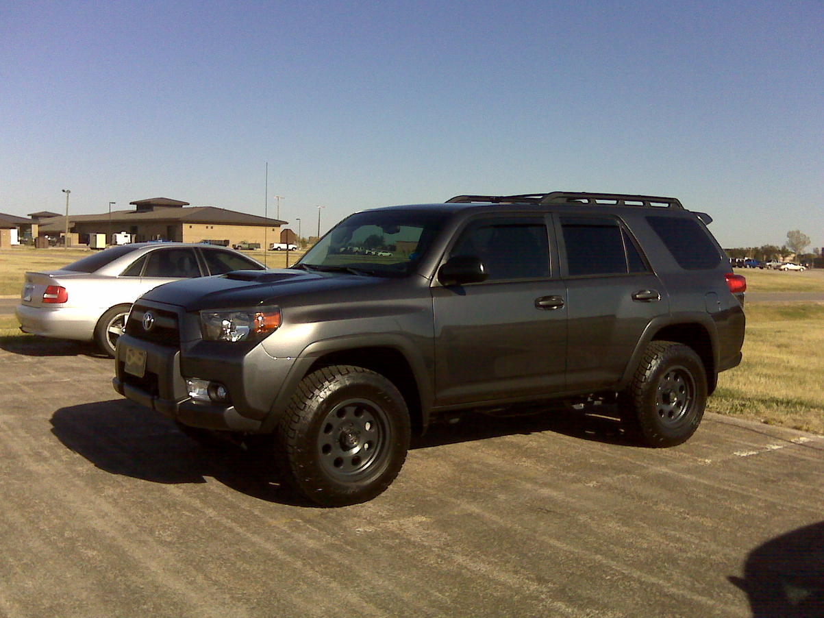

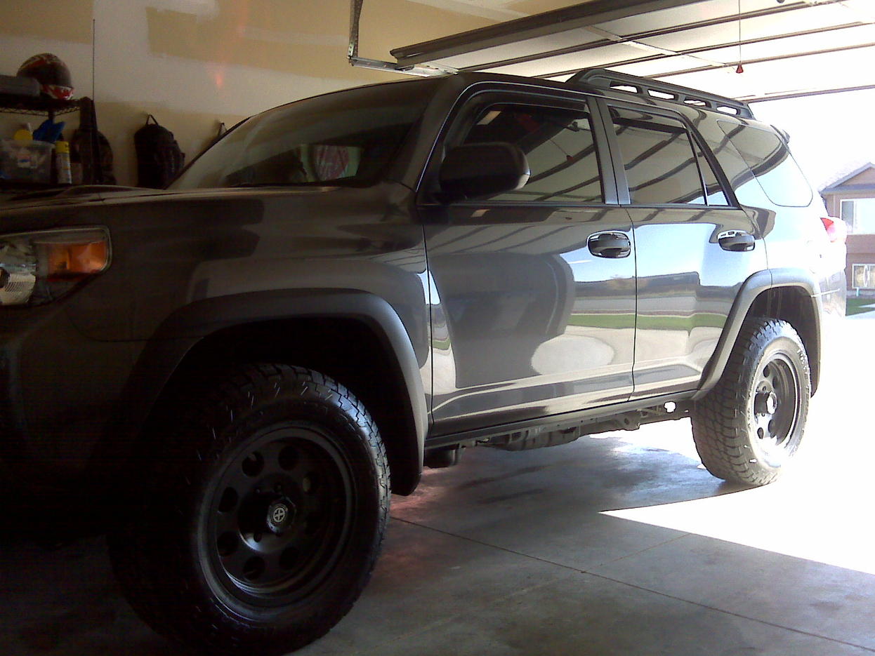

Pic with some center caps finnaly!

Thanks alot Not sure what part# they are they are just american racing rims mojave teflon coated 17x8 4.5 backspacing with a zero offset. However tonkat said hers don't rub with her toyo open country m/t's without a lift or leveling kit in the same rim but my 4runner is leveled and I rub at full lock when backing and the steering wheel is cranked all the way to the right. I basically just went on tire rack and looked at rims and had my friend who owns a tire shop here order them for me.

I mentioned earlier in the post that the toytec topout spacer gave me 2 inchs of lift on my Trail and 1 3/4 inchs of lift on my 04 SR5. I honestly have no idea why toytec says they only lift it 3/4 of an inch. Honestly it depends on how level you want your 4runner which kit you order.
I would also try and find a shop that will install these for you for a resonable price to one member was quoted 450 which is nuts. I know the limited is differeant as far as front suspension but Harper7 has mentioned it can be done. Good luck with your lift post some pics after your done. Thanks for the complements on the ride.
