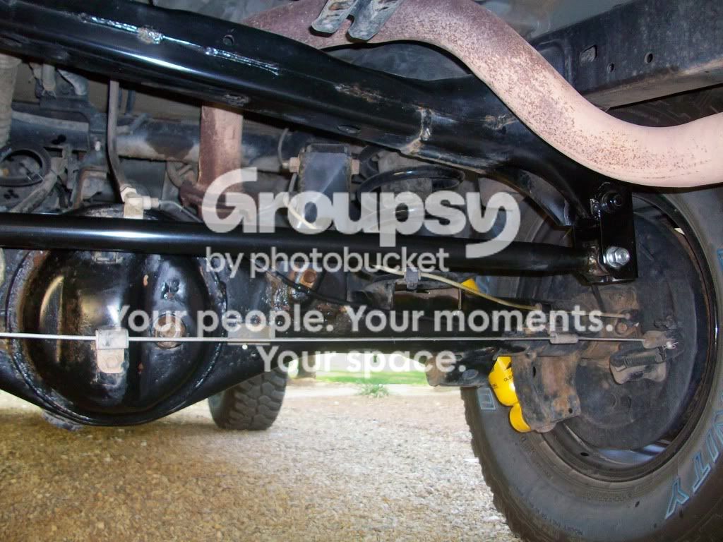

Panhard drop bracket:
100_0581.jpg~original
Did you buy another Panhard bar....or just have a new drop bracket installed???

Ripcord, I have been looking at these parts and am not sold on them yet. What exactly did this do for the truck? Did you notice any difference?
The more you lift the rear of the truck, the more the axle shifts to the passenger side. 3" of lift can see about .5-1" of displacement.
This is becuase of the panhard bar. Its simple geometry. Think of the panhard bar as the hypotenuse of the triangle. When the Hyp stays constant and you increase the length of one of the legs of the triangle (being the vertical leg when you lift) it causes the other leg to become shorter. And that pulls the axle over.
The panhard drop returns the panhard bar to stock or near-stock geometry to keep the rear axle centered.
Thanks Ripcord. I will maybe have to look into getting this done, looks like an easy install with the exception of the fact that my welding skills are not up to par probably!
Was it worth the money? See any differences in handling or anything?
Don't you have the Sonoran Steel 1.2 Ameining??? You should have an adjustable panhard bar under there, which would make getting a panhard drop bracket COMPLETELY redundant.
Yes I do, good memory. I do have the adjustable panhard bar, but I have never adjusted. Maybe I need to look into doing that? Thanks for the clarification, it makes more sense to me now.
