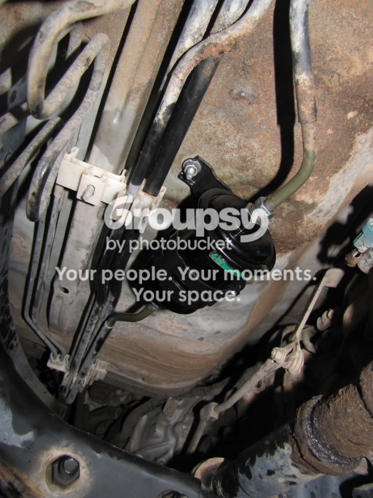

Fuel Filter/ Fuel pump
After the seafoam, it is important to go a step further and change the filter too. I also changed the fuel pump with a Walbro 190 Lph fuel pump that was supplied with the URD 7th injector kit.
I used this write-up, it was the best I could find and very helpful:
5VZ V6 4runner fuel filter write up with pics
Old fuel filter:
IMG_0015.jpg~original
New one in:
IMG_0016.jpg~original

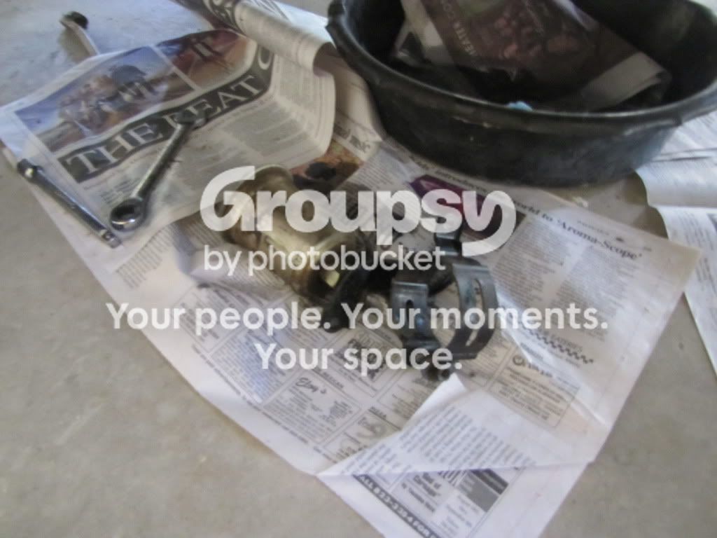

Fuel Pump:
Support the tank when you are unbolting it..
IMG_0045.jpg~original
With the tank down, changing the pump:
IMG_0047.jpg~original

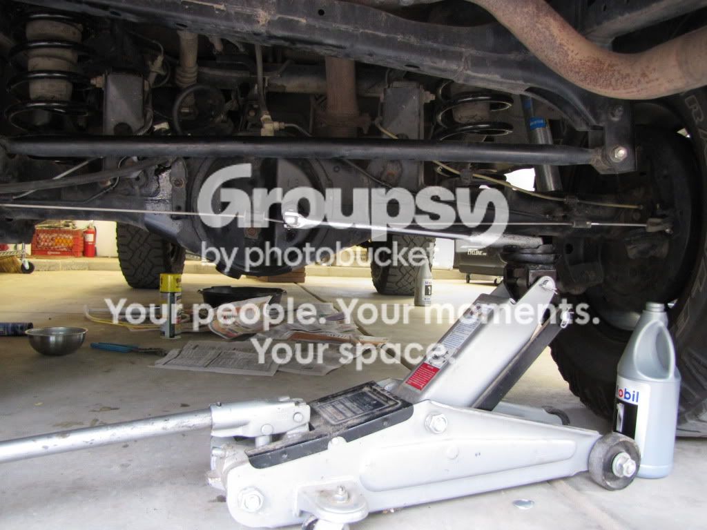

Full Mobil 1 Sythetic fluids change
After the fuel stuff, it was oil time. I didn't take any pics of the engine process because.. who cares about that. I did take a few of the diffs though.
I had to go out and buy a $6 socket for the job. I needed a 1/2" drive- 15/16" 6-point socket to get the bolts off the diffs. I had a 12 point in that size, but that would have stripped the bolts.
I thought of a way to apply lots of force with little amount of effort :D
IMG_0049.jpg~original

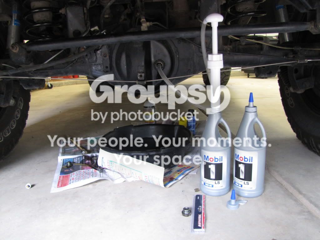

Filling the diff:
I also had to buy a new $8 hand pump for this part.
IMG_0048.jpg~original
