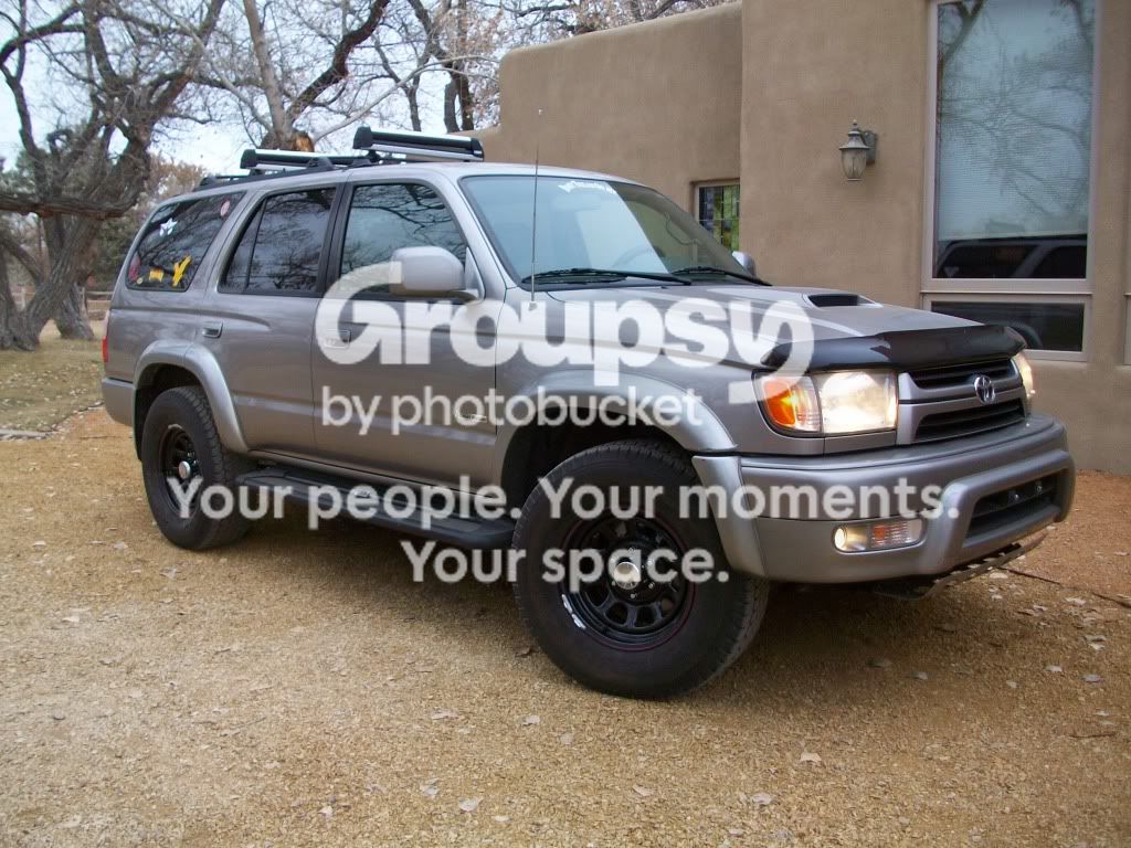

Most recent picture as of December, 2012:
IMG_0008-2.jpg~original

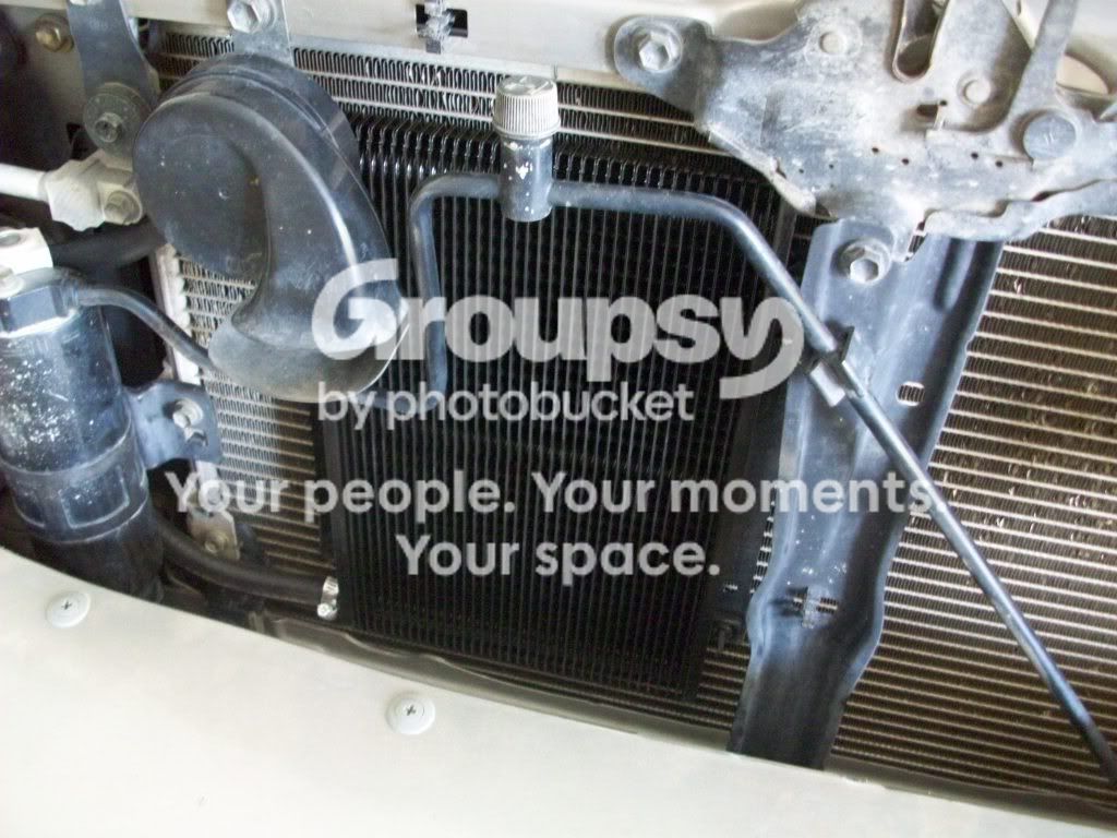

-B&M 70268 Supercooler Transmission cooler (in-series w/ Rad!ator) (PG. 2/ Post 18)

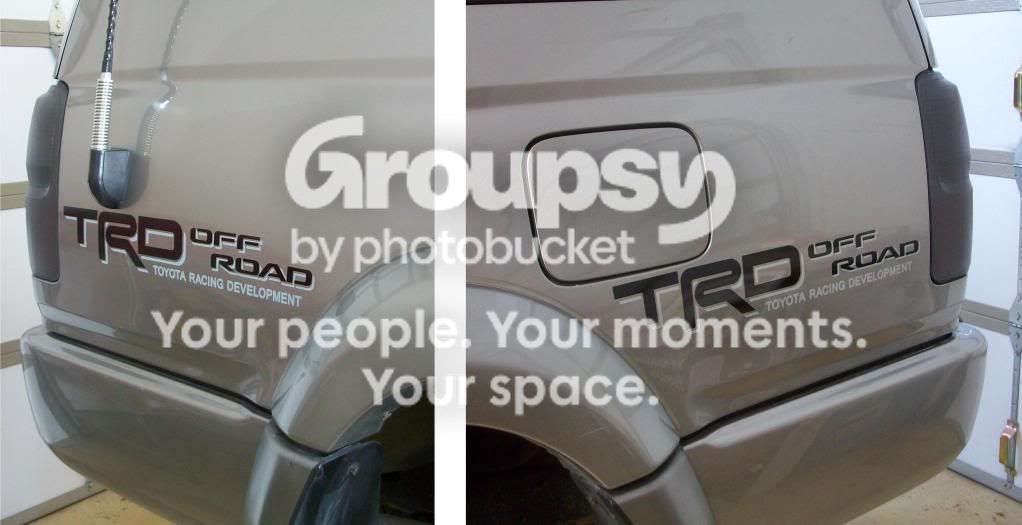

-Black/Silver TRD off road decals. (PG. 1/ Post 6)

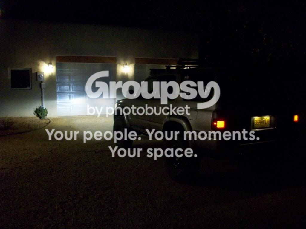

-Sylvania Silverstar Ultra headlights (PG. 1/ Post 6)

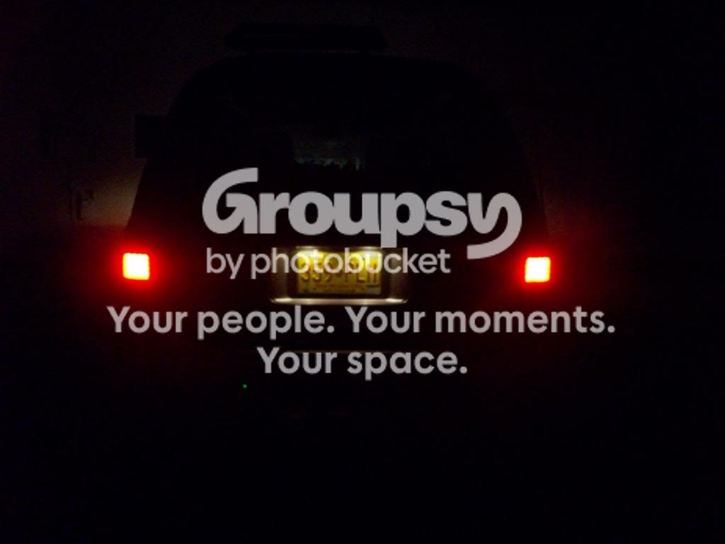

-LED Tail Lights (Black & smoked) (PG. 1/ Post 6)
-LED License Plate Lights (PG. 9/ Post 113)

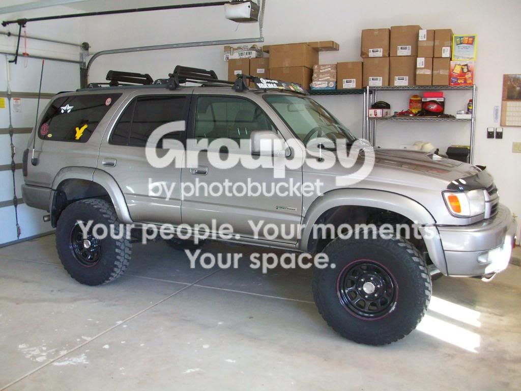

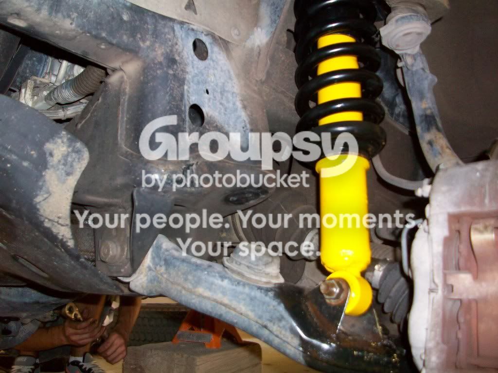

(5-20-2010): Called Toytec and ordered my 3” OME lift from a nice man named Darrick, got a forum member discount too.
Toytec Lifts: 1996-2002 Toyota 4Runner
I ordered the ‘Complete OME suspension’ Kit.
I specified for the 883 front coils and Nitrocharger shocks (Pre-assembled and w/out topout spacer) and 891 rear coils with HD Nitrocharger rear shocks.
The total was $820 after the discount.
-A few weeks later, I also ordered a 1” diff drop and a Panhard Bar drop bracket.
(5-26-2010): Complete lift arrived, even with rear shocks on ‘back order’.

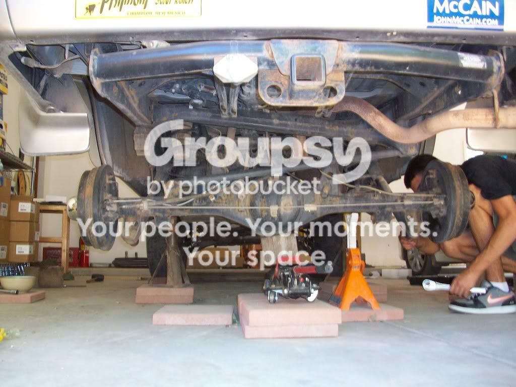

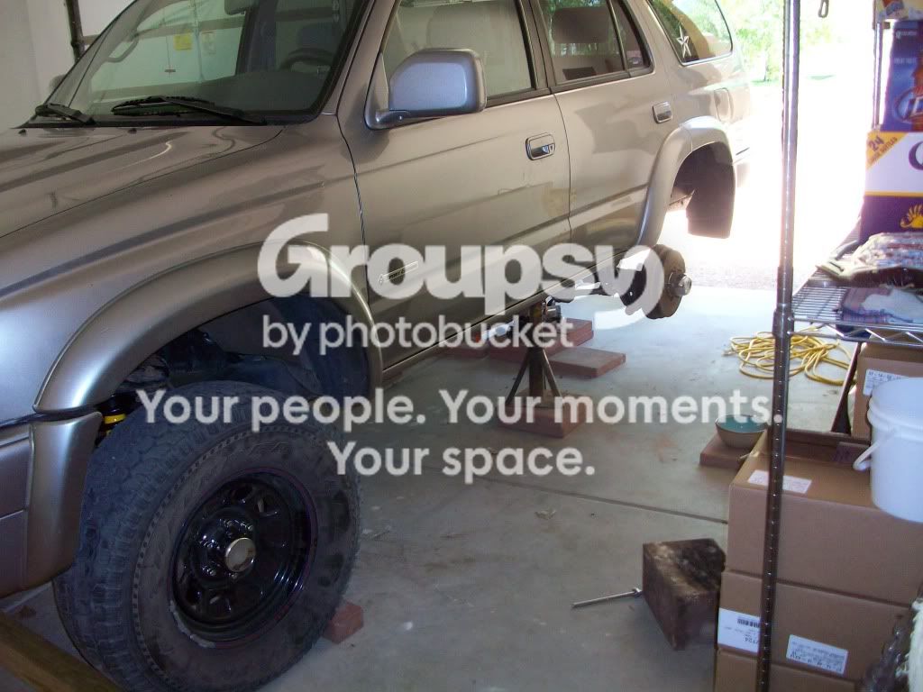

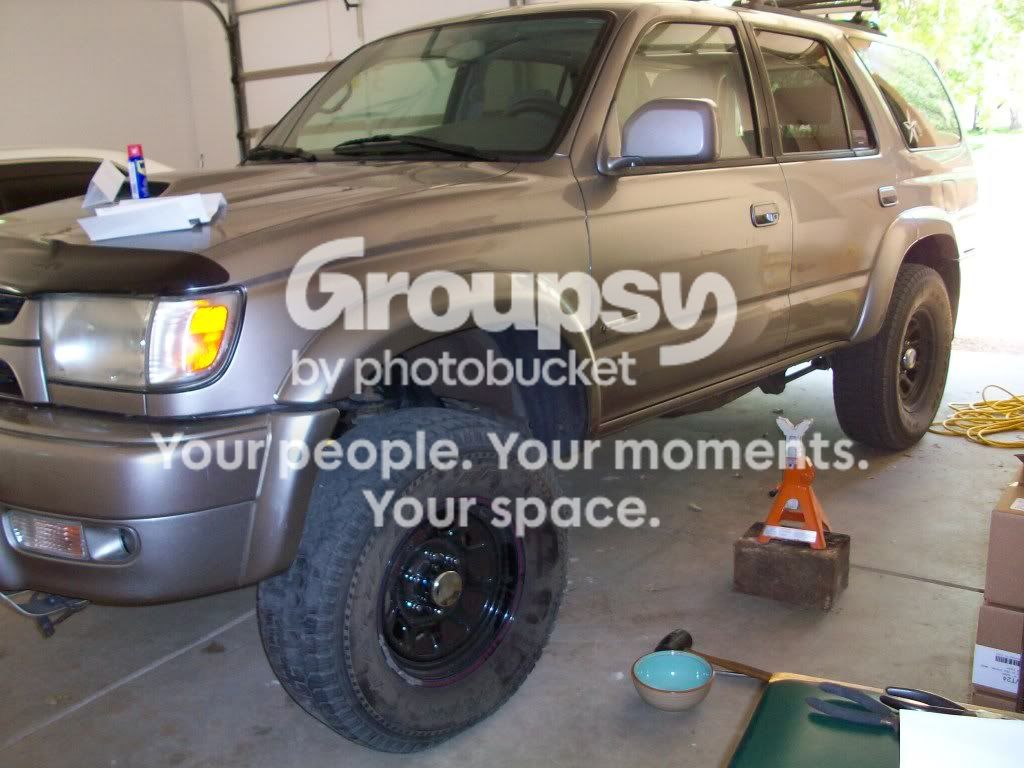

(5-29-2010): Lift installed with help of two friends.
-Time: 7 Hours (including 2 trips to Auto Zone to rent spring compressor and torque wrench.
-Tools: Socket set, floor jack, jack stands.
Before the lift, I bought some new wheels. American Racing Steel-series wheels w/D-spokes.
16x7 - 6x139.7(5.5) - 4.5" BS
100_0363.jpg~original

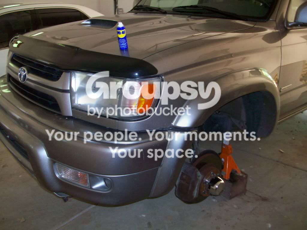

Working on the front:
100_0475.jpg~original
100_0480.jpg~original
Front done, Bro lean central.

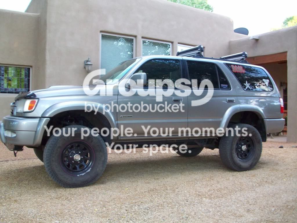

Done:
100_0500.jpg~original

I also swapped the OME 891's for LC 8 Wraps.
The 891's were too stiff for me, so I am going to try a coil I know is very comfy. I will just have to deal with the 4.5" lift I have gotten from the new 8 wraps though.
89415793_photobucket_46382_.jpg~original

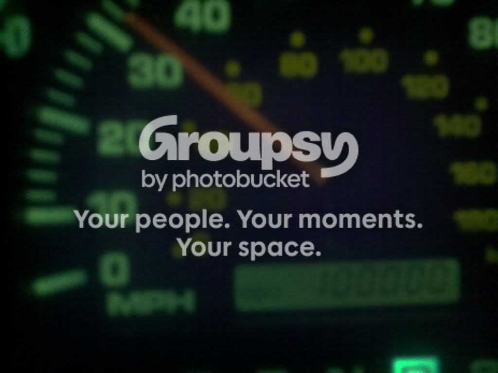

Hit 100k miles.
2011-01-14_22-06-49_667.jpg~original

Smoked LED tail lights:
Ordered a set of LED tail lights off Ebay. I bought the ones that have a black housing with a clear lens. Total was $140.00 shipped. I also sold my old tail lights for $80.
To smoke the tail lights, I first sandpapered the lenses with 1000 grit sandpaper. Then, I used a spray can of lens tint, let it dry, then clear coated them.
250~original
working on install:
89415793_photobucket_57814_.jpg~original
Just with parking lights- No brake light.
100_0635.jpg~original
Sylvania Silverstar Ultras
100_0648.jpg~original
100_0644.jpg~original

TRD Decals:
Purchased from eBay, such a good selection there. Got the EXACT color combo I wanted.
For my decals, I moved them down a bit from the normal spot.
With the Gas cap on one side and the CB antenna on the other (both at the same height), I had no choice.

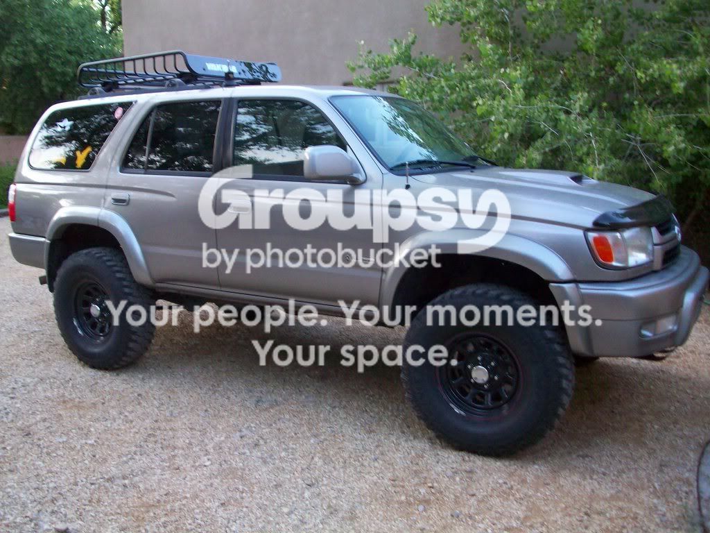

Nice work man! I may be mistaken, but I didn't see where you swapped your rear 891's for LC 8 Wraps?? Am I on glue?
Wow! Great build thread man. I don't think I've ever looked through it before. I like what you've done! What made you swap to the 8 wraps over the 891's? Wanted more lift? I've got 891's right now and may down the road swap them but I'll be towing boat around town so good to see how they sit with a similar boat.
Thanks!
With the 891's, I hated them, WAY too stiff. I still have the heavy duty rear OME shocks. Getting some nice Bilstiens when I can afford them.
How does your rig sit with the LC 8 wraps and the OME stuff?? Level? Raked?
Raked, it is quite noticeable. Here is a garage picture.
Also, in this picture I used MS paint to black out the fender flare sealer strips. Opinions on that?
100_0712.jpg~original
"Raked, it is quite noticeable. Here is a garage picture.
Also, in this picture I used MS paint to black out the fender flare sealer strips. Opinions on that?"
I think I would keep the sealer strips stock color....just my 2 cents....BTW, I do notice the rake, however, my Tundra Struts are lower even with the topout spacer.....Kinda wish I had the extra dough for the OME stuff....but got the Tundra stuff for a steal compared to what Toytec could sell me their stuff for with the shipping costs! Once again man, NICE RIG! :driving:

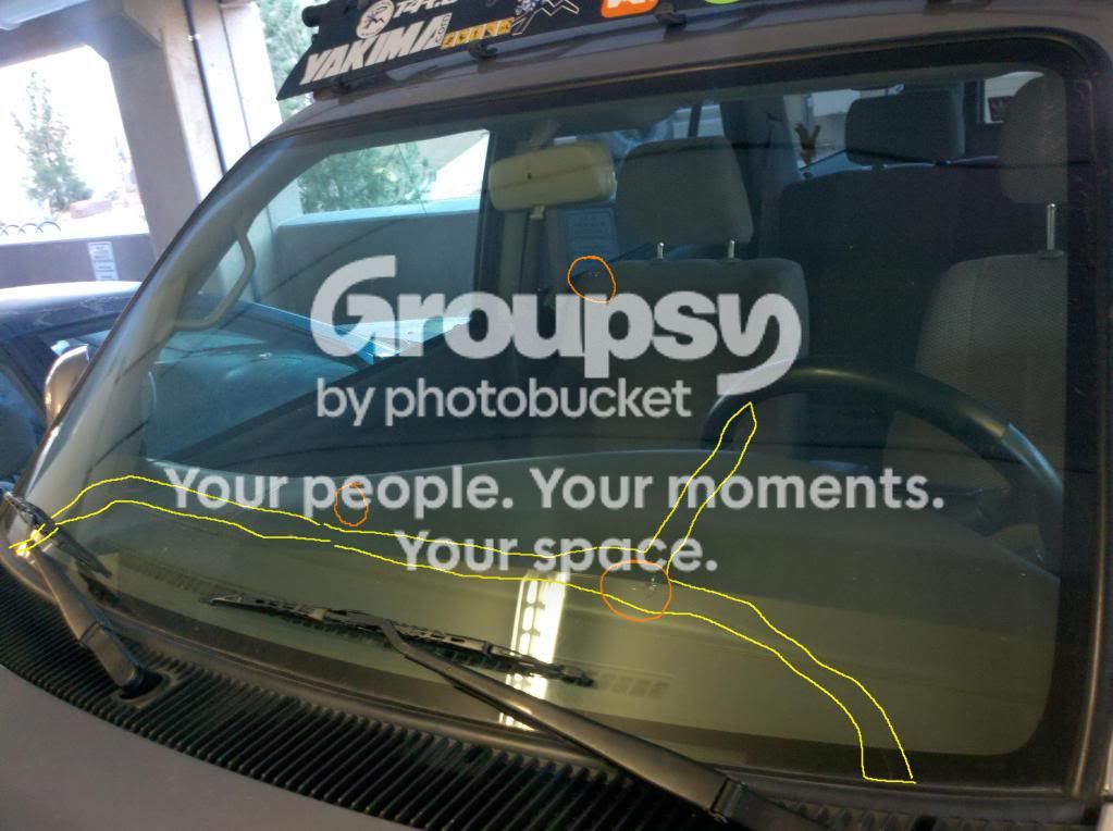

In January, my windshield got a HUGE crack through it. I had existing chips (one big one that was starred). I was driving to snowboarding in the morning, windshield was cold, had the defrost going, hit a pothole.. BAM. It wasn't blocking line of sight, but it was annoying.
Here is a picture from the day before I had it changed.
The yellow is the crack, the orange circles are the chips. The cracks stemmed from the main chip.
My insurance deductible was $100.
2011-03-11_08-27-55_797.jpg~original

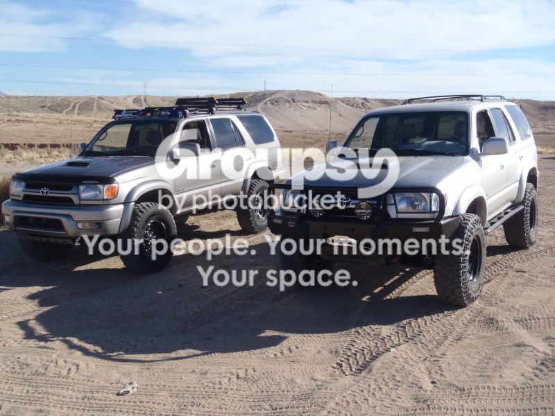

BigFishAllDay and I met up for some wrenching and offroading.
He is a really cool guy and is very patient and knowledgeable about 4runners.
He is the guy who wrote this thread: http://www.toyota-4runner.org/3rd-g...oler-transmission-cooler-install-3rd-gen.html

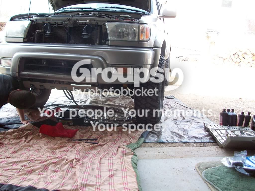

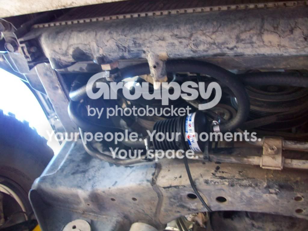

He has done 2 transmission cooler installs on 3rd gen 4Rrunners (make that 3 now). Needless to say, I was in good company.
First, we installed the B&M 70268.
100_0713.jpg~original
100_0730.jpg~original
Magnefine In-line filter.
100_0714.jpg~original
UPDATE 5-20-2012
After changing the radiator, the B&M cooler is now in series with the build in trans cooler in the radiator.
Hot from trans > Radiator cooling > External cooler > Filter > back to trans.

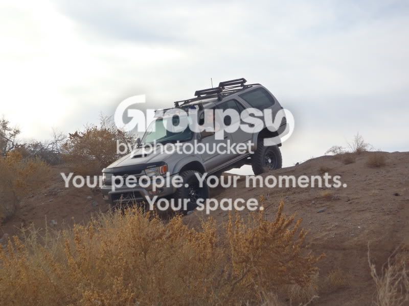

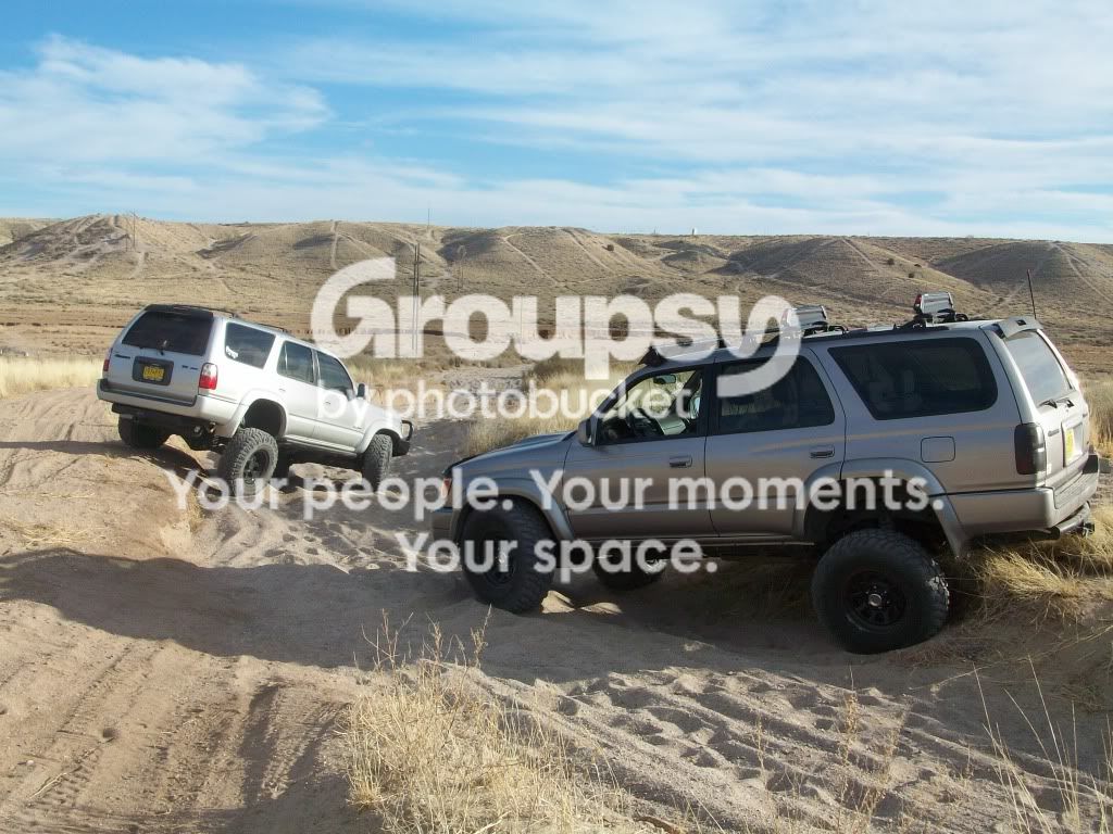

After the install was done and we cleaned up. It was time to head out. We went to a local off road park.
BigFishAllDay ended up taking most of the pictures.
100_0728.jpg~original
100_0723.jpg~original
100_0722.jpg~original
4ecbfea1.jpg~original
88e438f0.jpg~original
9695c430.jpg~original
5b49d231.jpg~original
0079dc59.jpg~original
Again, most of the pictures were taken by BigFishAllDay. He took all the good ones.
