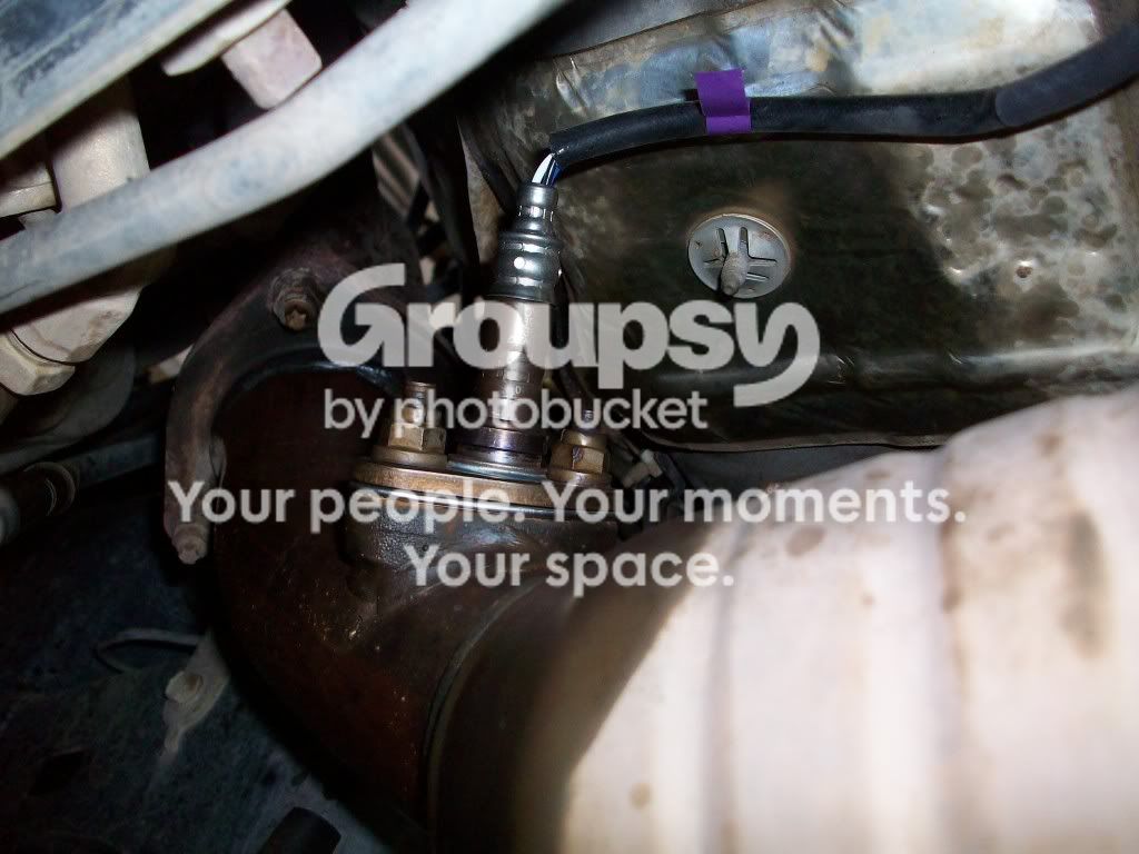

I also replaced my upstream O2 sensor.
I did not have the engine code, but my mileage had been a bit down recently. Figured this could help me get some of it back.

Old one:

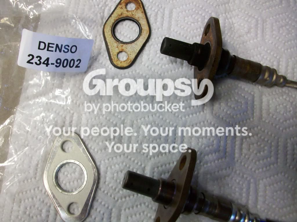

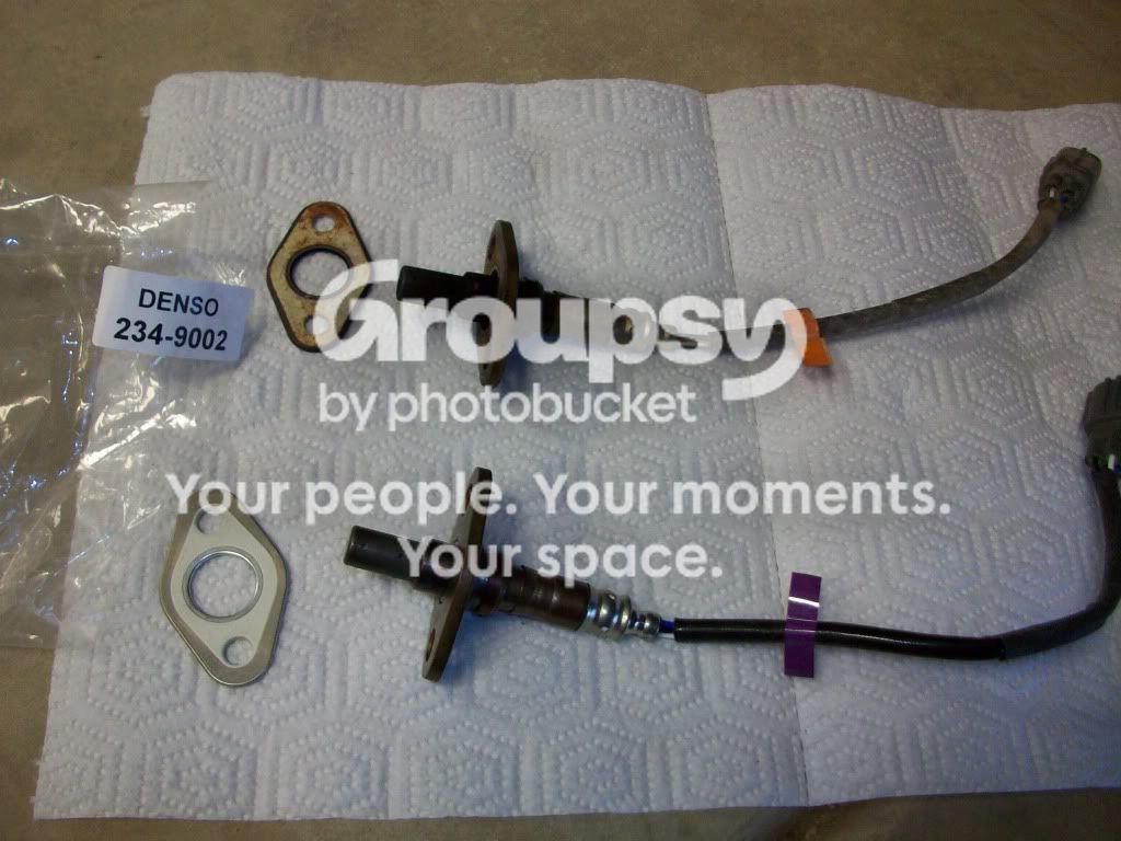

Old vs new:
You cant really tell, but the old one was quite coated in soot.
115_1099.jpg~original
115_1100.jpg~original

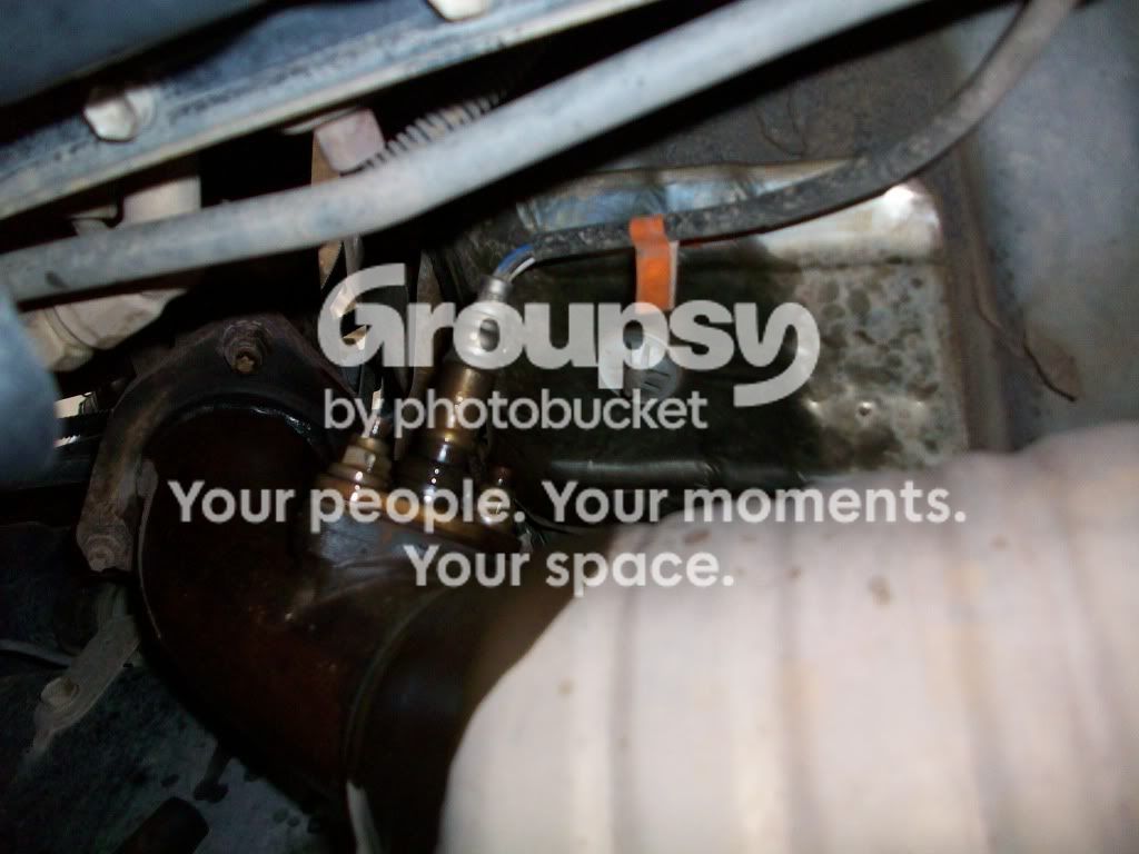

New one in:
115_1102.jpg~original

With the O2 sensor, you have 234-9002, and the chart shows a 9001 for the v6 and the 9002 for the 2.4. Any diffrence between those two stock numbers?
Take a look at that list again. For 01-02s..
