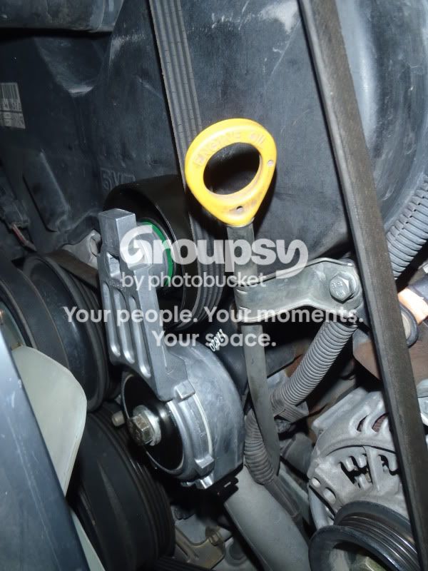

Which style tensioner do you have? I would wager to say you have belt slippage. Do you have the idler pulley like I do or the dynamic tensioner?
I have experienced some belt slippage in the circumstances you mention. Suddenly stepping on the gas, hard. When this happens, the engine losses a ton of power and barely keeps going. You need to let off the gas then go back into it a little lighter.
They dynamic tensioner is supposed to really reduce the frequency of this happening and its on my list..
This is the Idler pulley, its the one on the braket that is below the supercharger:
IMG_0002.jpg~original
And this is the dynamic tensioner:
Photo courtesy of BigFishAllDay.
fb2d07ff.jpg~original
I have the dynamic tensioner but I have been thinking about replacing it because I have a squealing noise when cold and I think that is where it is coming from.
When it downshifts it is more than a power loss you can hear an audible popping sound like detonation (which it might be).
Thanks for the quick response.
Ben
Are you running the plugs that came with the URD 7th kit? Did you properly install the IAC controller computer?
If yes to both, then sounds like you need to get it tuned.
