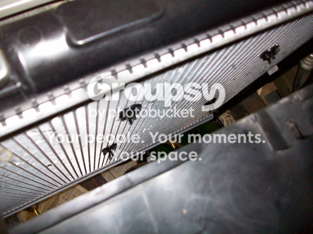

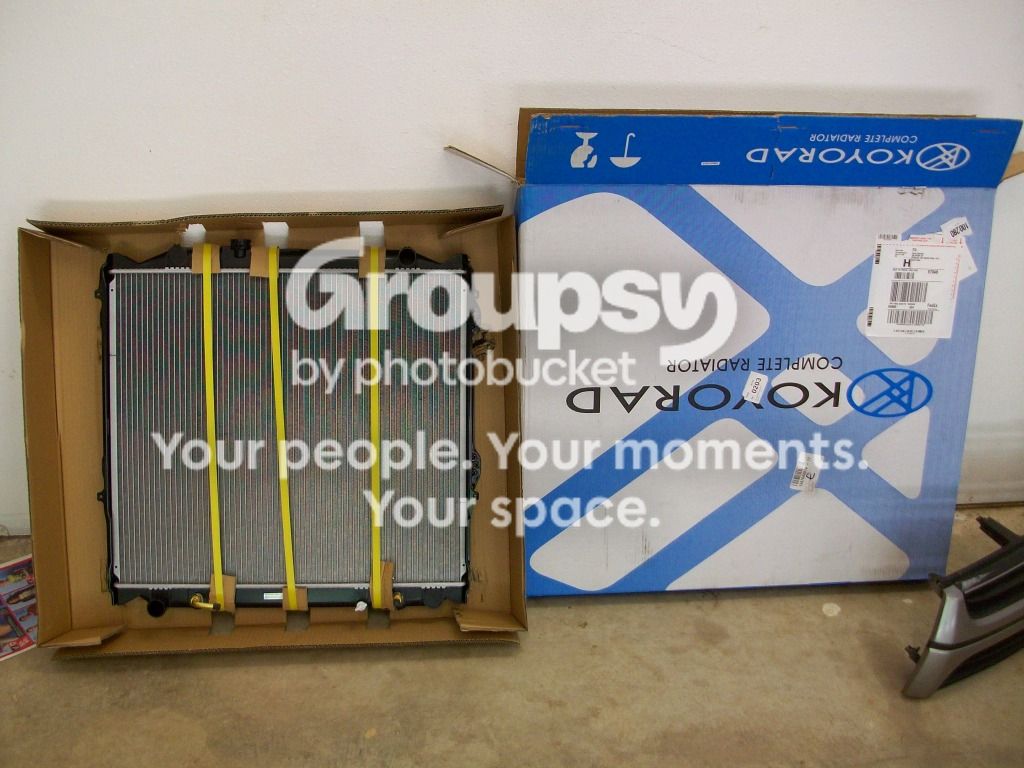

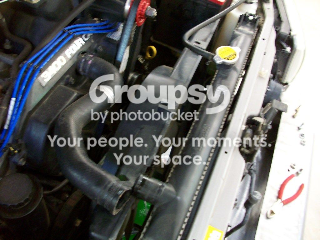

There were a few reasons I wanted to change the radiator before this trip. Reasons like:
-I was already running temps I would consider "too high" during the winter.. The summer would only make that worse.
-I wanted to put the trans in series with the radiator and the B&M, and I couldn't do that until I had a new radiator.

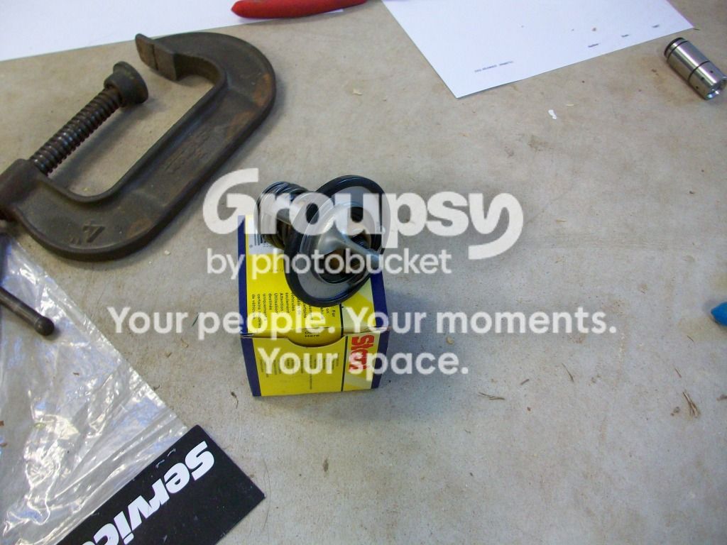

-I wanted to also install a cooler thermostat to help with temps, and the perfect time to do that is when you already have the radiator out.

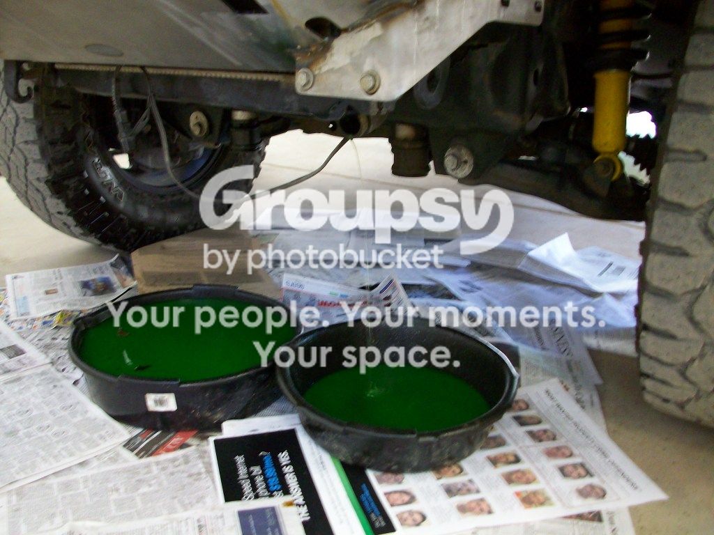

Yes I use green coolant. I like apple milkshakes..

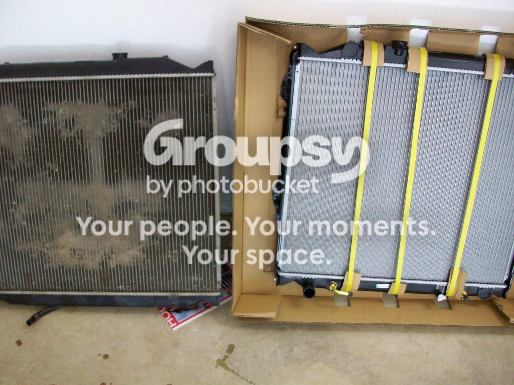

Old vs. New.

Old 180* thermostat out, stant 170* is now in.

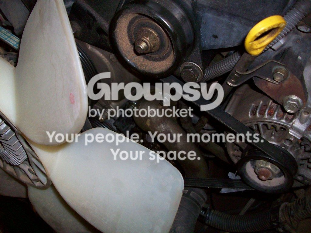

Dang stripped bolt was a pain..
119_1226.jpg~original

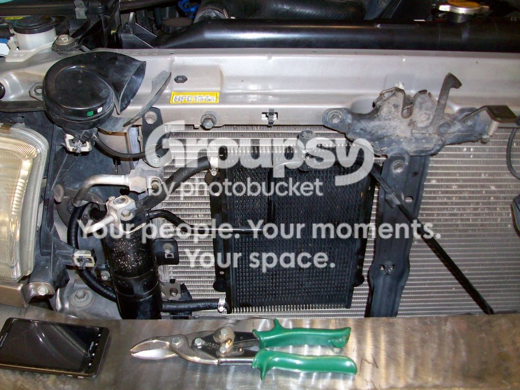

B&M install is much easier without the fan shroud in the way!!
119_1227.jpg~original
B&M back on.
119_1228.jpg~original
My new setup with the trans cooler is:
Hot from trans > Temp sensor for gauge > Radiator cooling > B&M cooler > In-line filter > Back to trans.
Having driven around for a day or two with this setup, my temps are much lower! Where I used to see 197 for water temp I am now seeing 185. And where I used to see 170 for trans temp, I am now seeing 150s.
I am confident that without this setup, I would easily overheat the transmission in MOAB. I am now not worried about it at all.

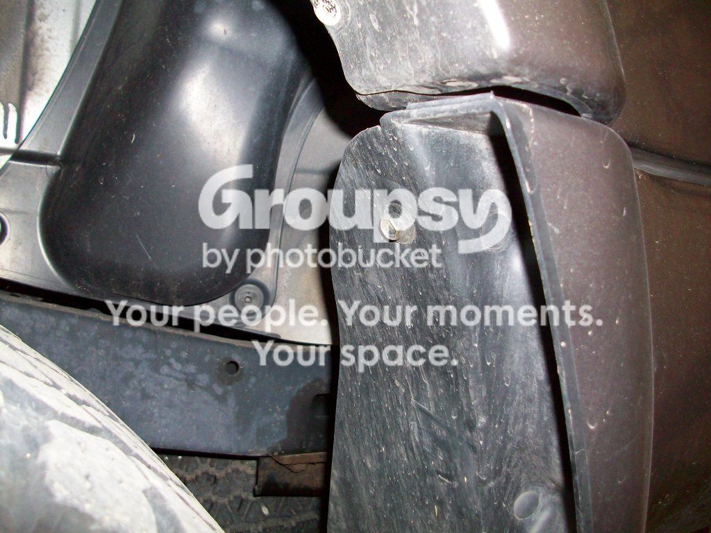

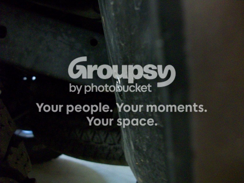

Low profile wheel well bolts..
Taking the initiative from BigFishAllDay yet again, I installed low profile wheel well bolts.
These are the ones you want, but you don't need them quite this long..
119_1235.jpg~original
BEFORE:
119_1233.jpg~original
AFTER:
119_1237.jpg~original
119_1239.jpg~original
This should take care of my rubbing.
