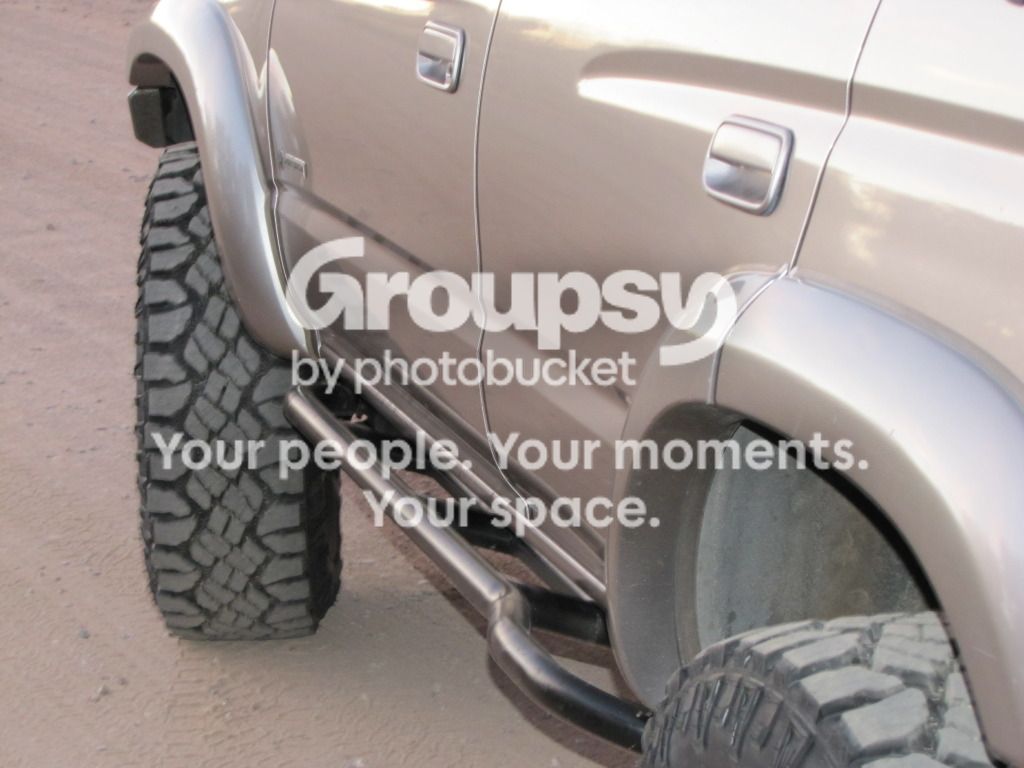

New Tires!.. Finally!
Well I finally got new tires!
Same thing, 285/70-17 Duratrac D's
$1236 out the door, with $200 in rebates heading my way plus whatever I get for the old ones..

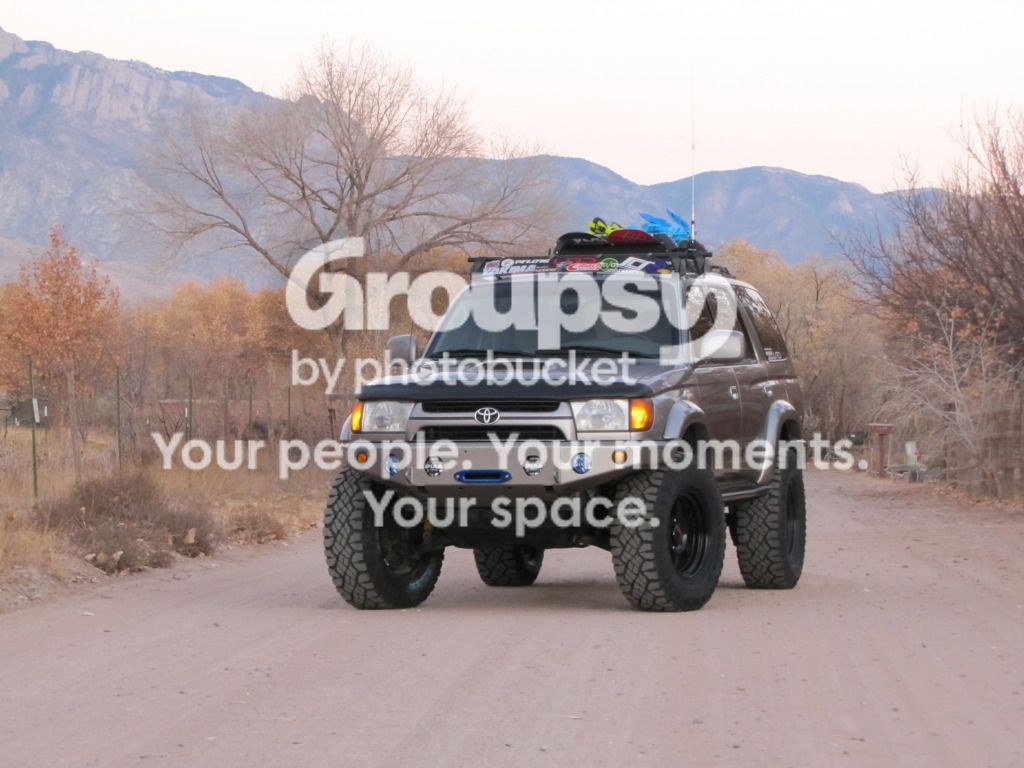

Got my new shocks installed
1A77A7C3-CB87-47CC-977C-4ECB606EB4DD-15172-0000133248CBFB16.jpg~original
Where'd you get the Duratracs again? just that a friend is looking for a spare and maybe I could point him out to a better source...thanks bud.
Second pic^ is sick too!

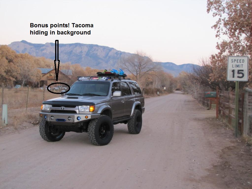

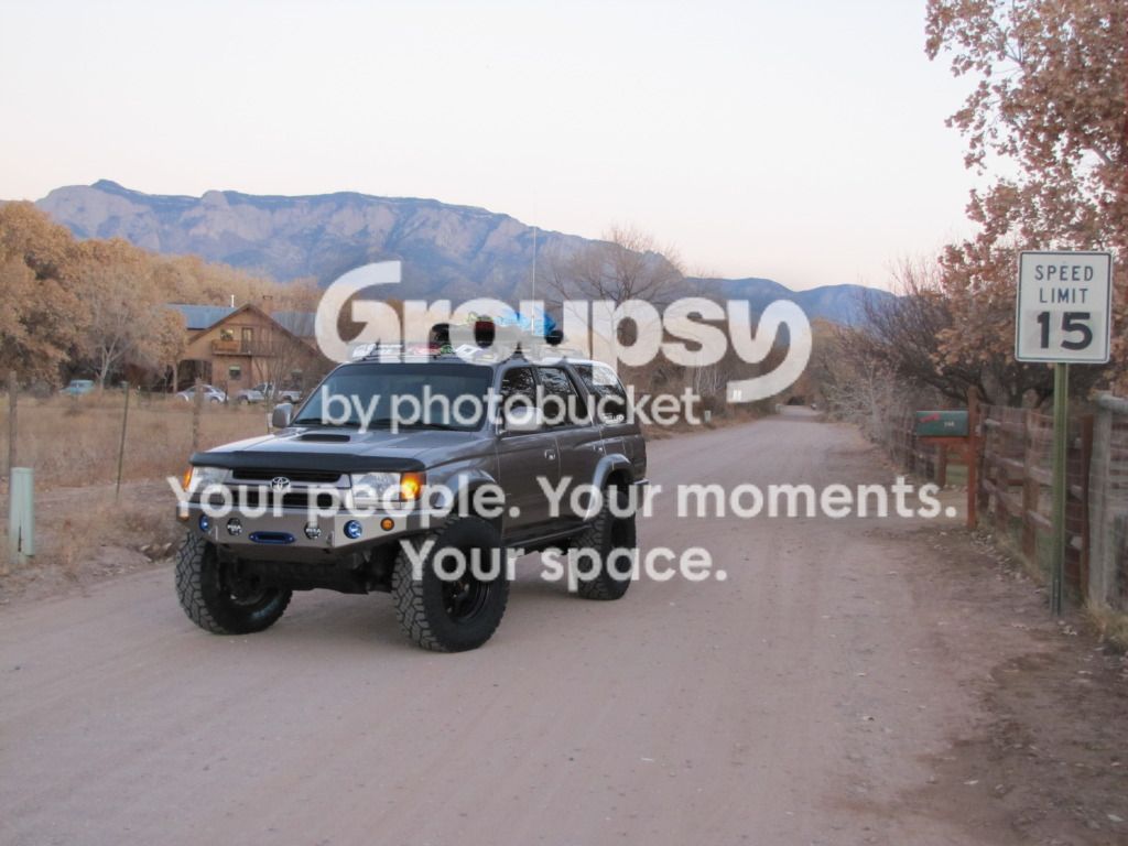

Lol you sure? looks like an older F-150....! :bigok::D
Otherwise, those duratracs are looking sick on your truck Rip!!
I thought that too. BUT, look closely at the shape of the wheel wells
Edit: Sorry to cloud your thread Ripcord. Gotta have some fun ya know
^It's a 2nd Gen Tacoma.
