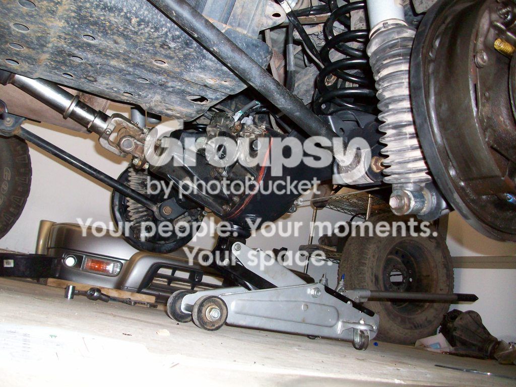

More axle/diff updates,
I went to the U-pull it junkyard the other day after Bigfish mentioned he found a few noteworthy items there. I picked up an E-locker housing and an extra CV axle.
The 4runner I pulled the elocker housing from had extended bump stops in the back and I meant to pick them up, but I completely forgot after I got the axle out and just left. Ill go back and get them later.
This housing is SUPER clean, there was not a spec of rust on the entire thing. I cleaned it up a bit and will paint in the next few days. The Elocker diff is supposed to be here the 9th (tuesday) and the new Front clamshell from ECGS is supposed to be here on the 11th (thursday). So I should be up and running by saturday!

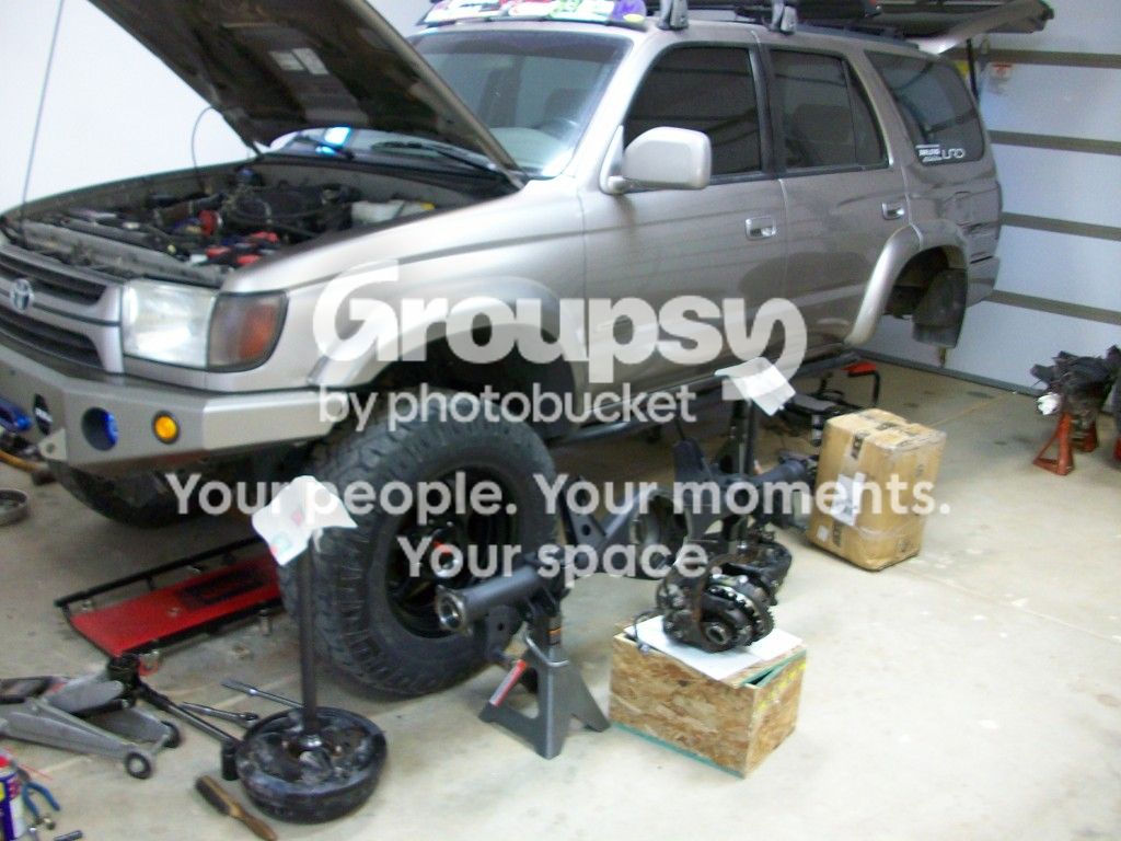

Front done!
|October 17, 2012|
Wrenching time has been VERY limited lately. Classes are really taking all my time so I only have maybe 1 afternoon every WEEK that I can work on my truck.. which sucks because I keep having to get rides everywhere.

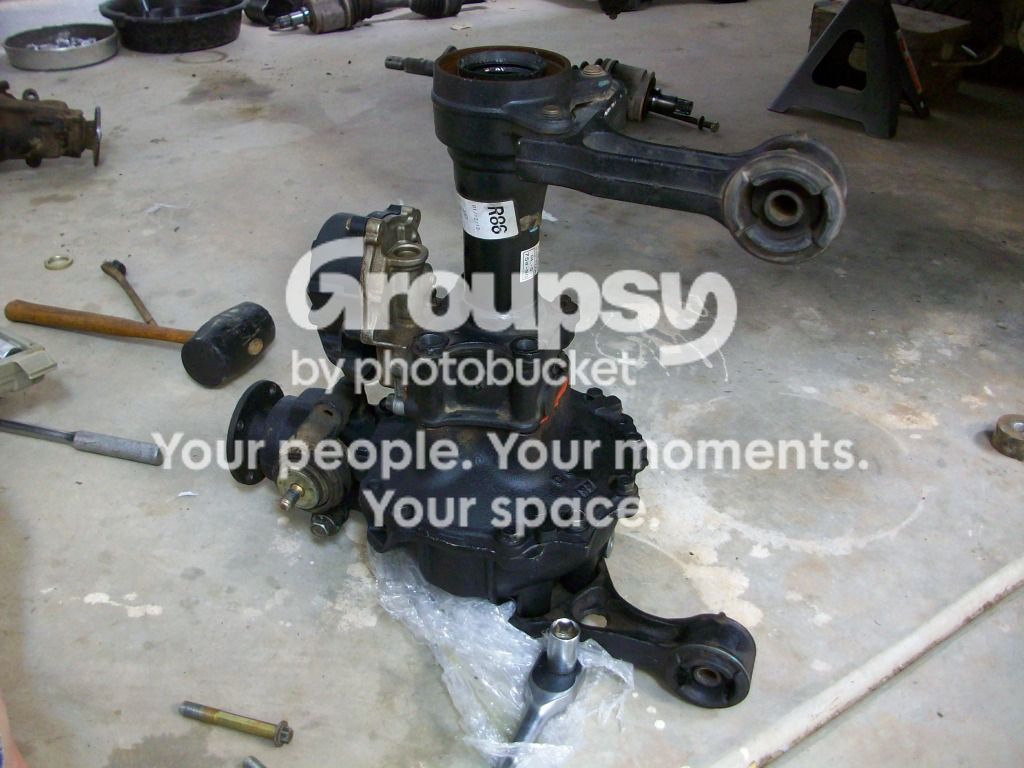

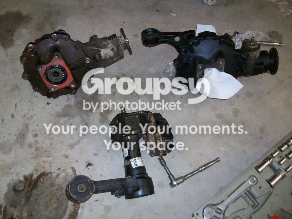

Anywho.. the front is all done. Got the new 4.30 clamshell from ECGS, gave it a once over and tested the gear ratio to be sure, then started swapping parts.
The Clamshell they send is just the barebones differential. No mounting arms, no ADD stuff, no main input shaft. So I had to transfer a bunch of stuff over from the old diff.
For those that didn't see the last page. This is what happened to the old front diff..
127_13491.jpg~original

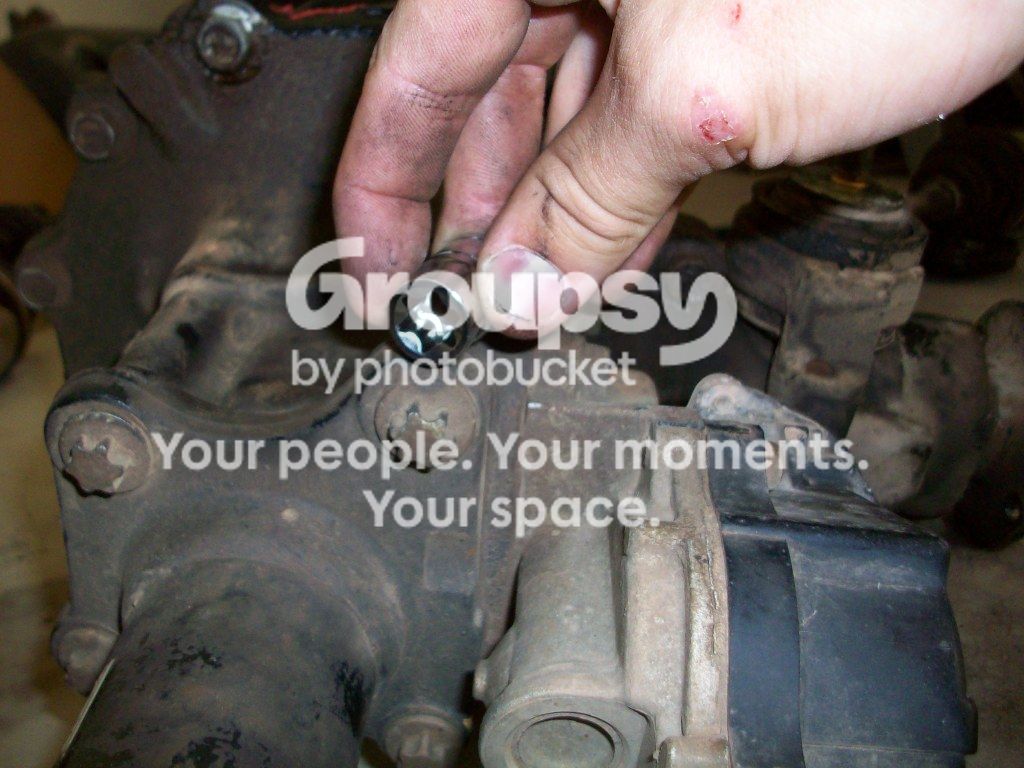

The only hiccup I ran into was that the ADD tube on the front diff is held in place with TORX head bolts. So I ran by harbor freight and picked up a set of torx sockets and bits.
127_1370.jpg~original
Its an E14 torx head if anyone cares.
127_1371.jpg~original
ADD tube off. You can see the main input shaft still in the old diff.
127_1372.jpg~original
I didnt take any pics of when I pulled the input shaft and popped it in the new diff..
But, here is the new diff all together ready to go in. After cleaning up the mounting surfaces and applying new toyota FIPG.
127_1378.jpg~original

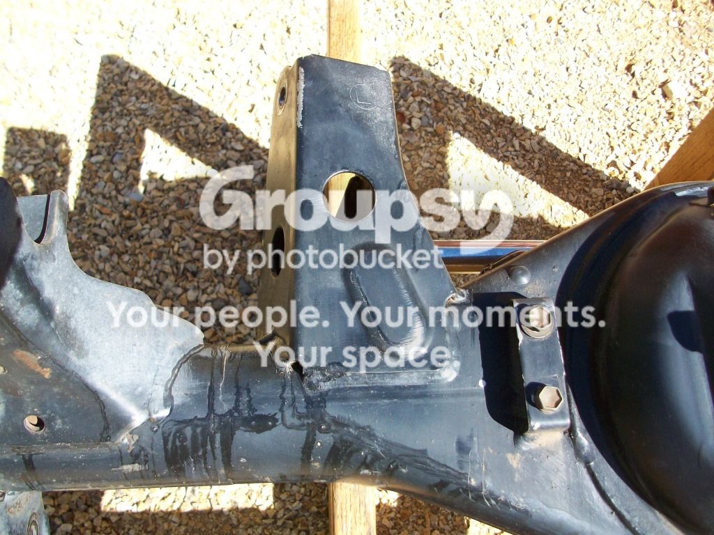

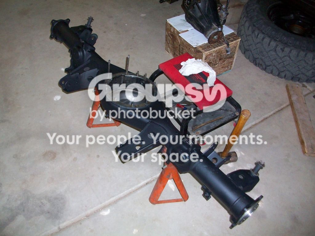

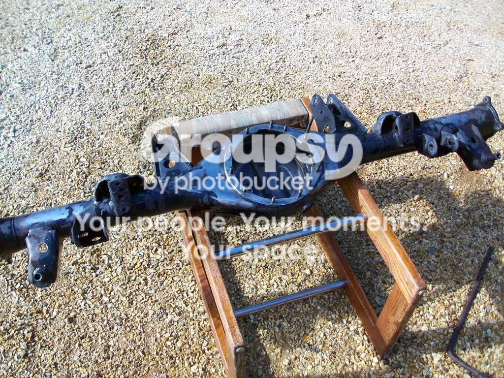

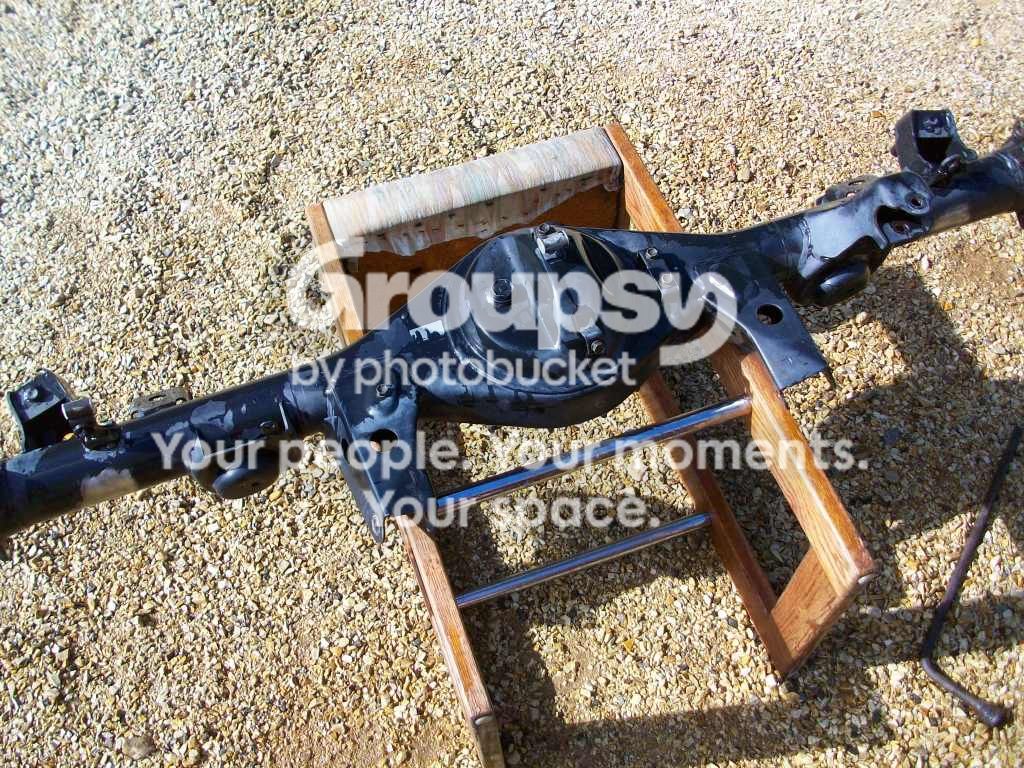

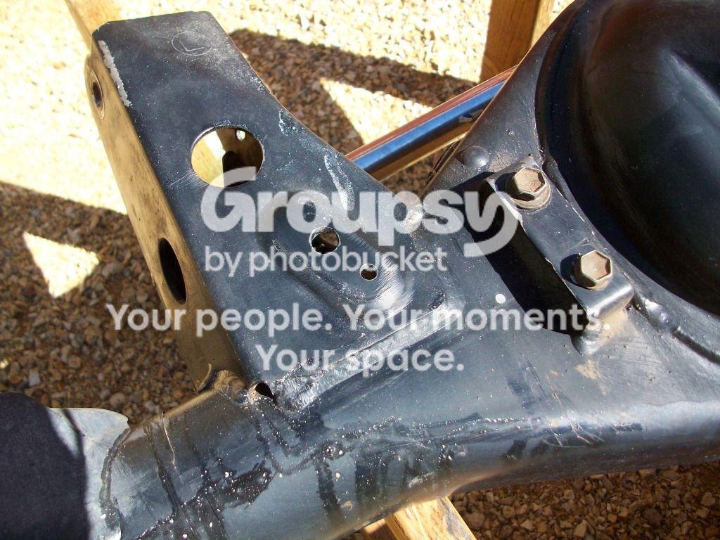

Also put in some work on the rear axle housing. As bigfish mentioned in his thread, the only difference between the 96-00 and 01-02 axles is the 01-02 have 2 rear brake lines so they have two mounting spots.
5 minutes, a drill, and a file fixed that right up!
127_1360.jpg~original
127_1362.jpg~original

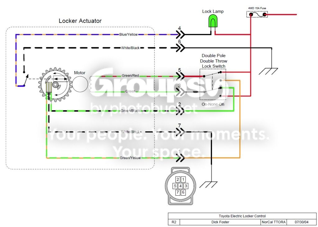

There are many ways to setup the wiring for the elocker. You can get the stock elocker ECU and go with that route. Or you can make your own in many different ways.
The method I went with was what I found in this write up:
http://www.norcalttora.com/~d*ck/Writeup Stuff/toyota_elock_control.pdf
(replace the * with an i for it to work)

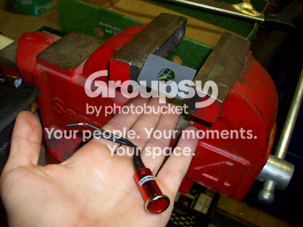

In this write up, all you need is a 12V LED, a DPDT on-none-on (aka. on-on) rocker switch, and a length of 6 conduit trailer cable.

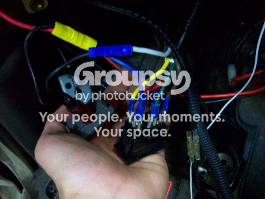

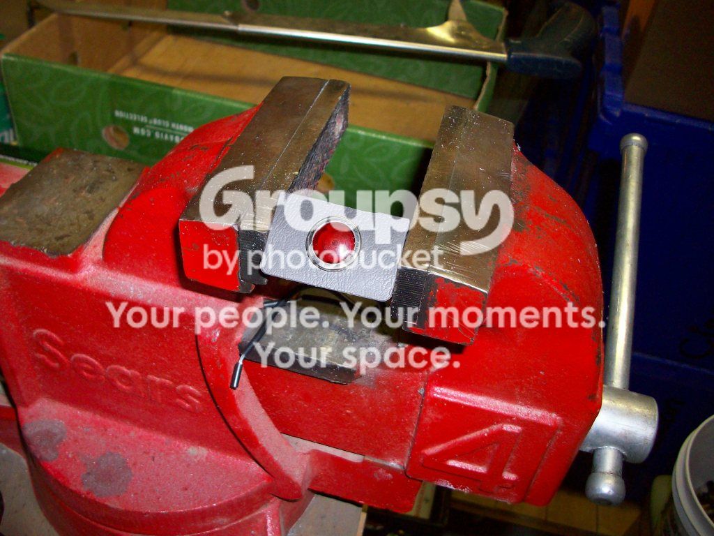

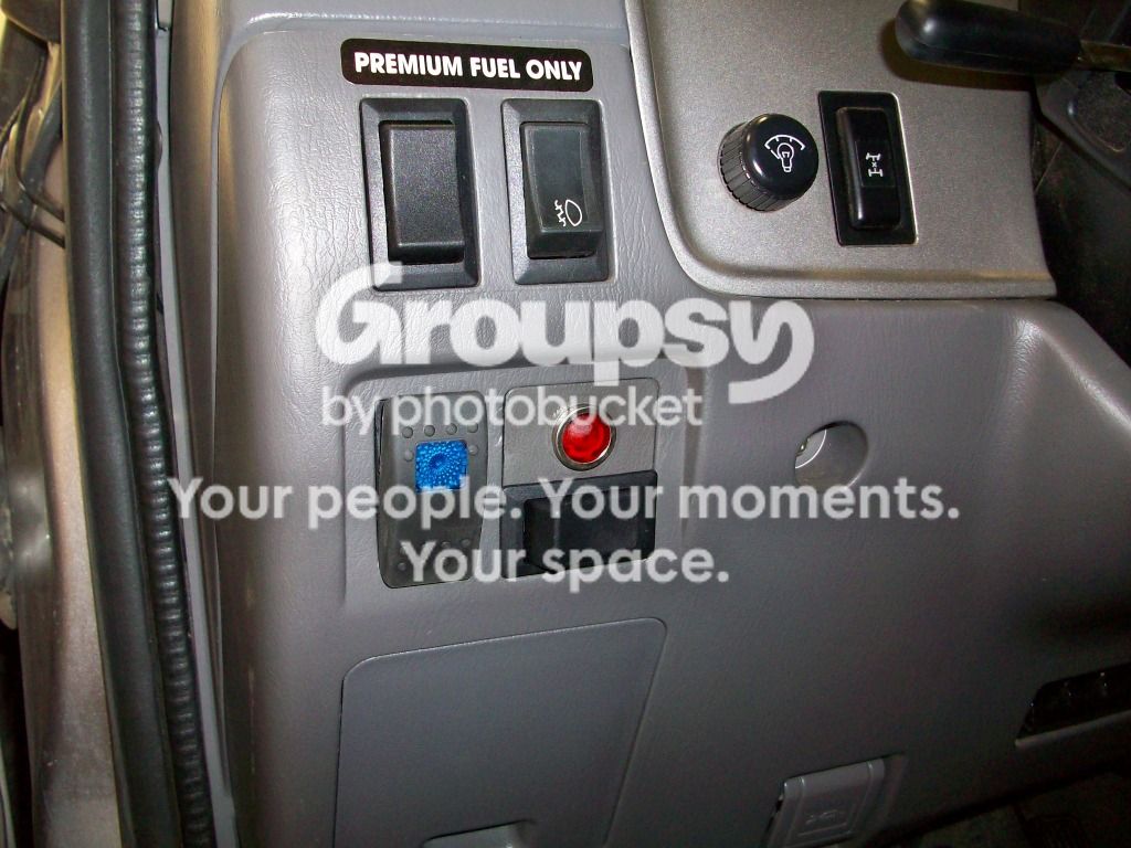

For the switch, I have already filled up the 3 extra switch locations. So I had to use the big one. With that one, the switches have to be mounted sideways becuase of the dimensions. I just planed to use the extra space left over for a light!
127_1381.jpg~original
127_1382.jpg~original
127_1383.jpg~original
127_1384.jpg~original
I am very happy with this setup, I think it looks great!

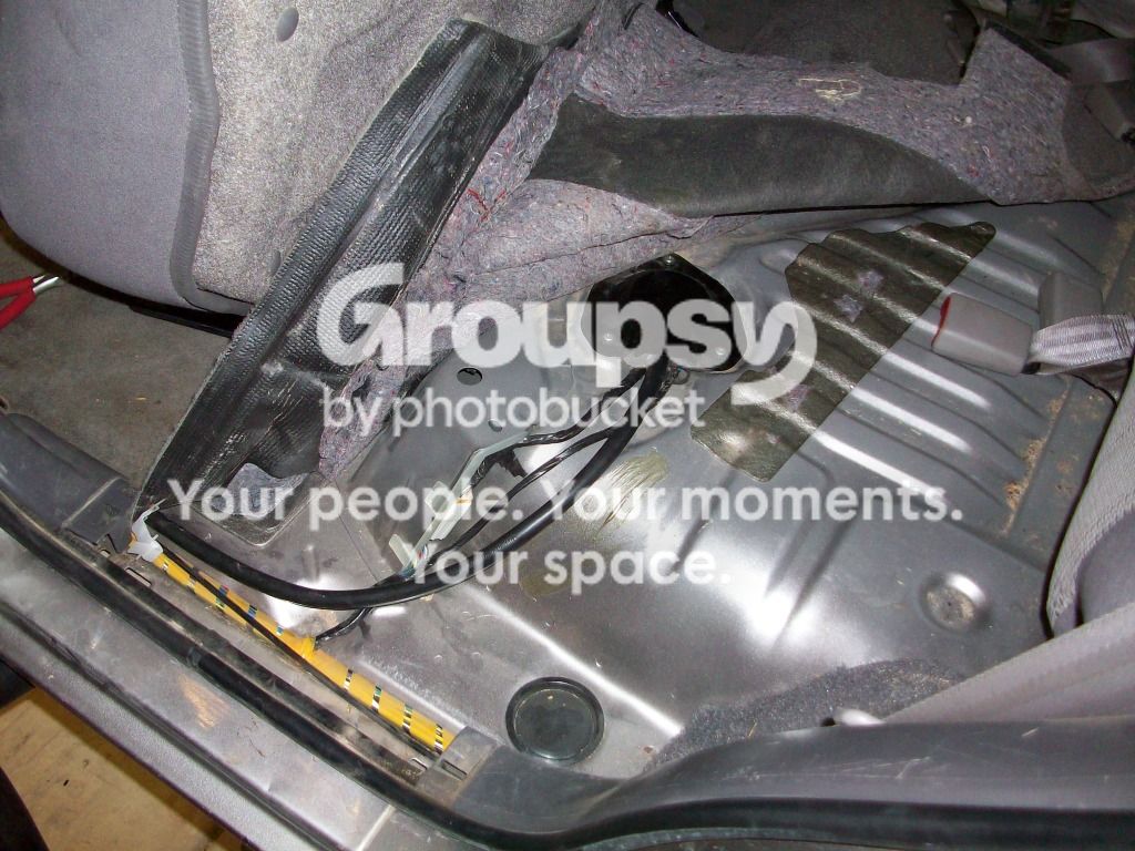

Routed the wire down through the Rear seat access hatch:
127_1385.jpg~original
127_1388.jpg~original

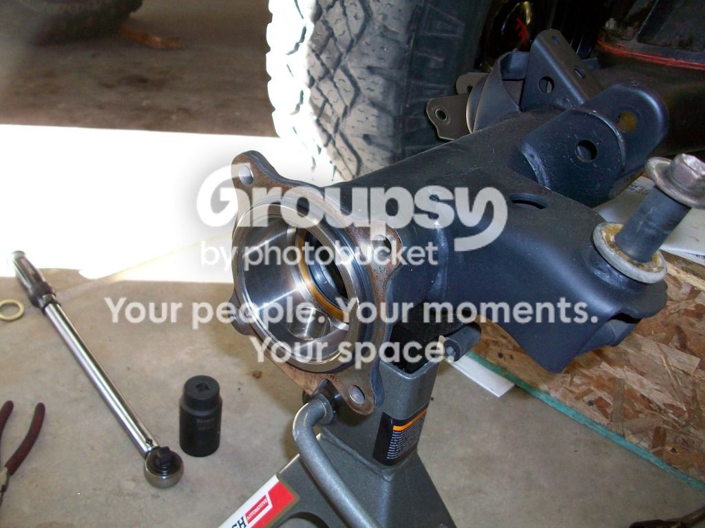

E-Locker Retrofit Part 2:Building the axle!
Part 2: Building the axle!

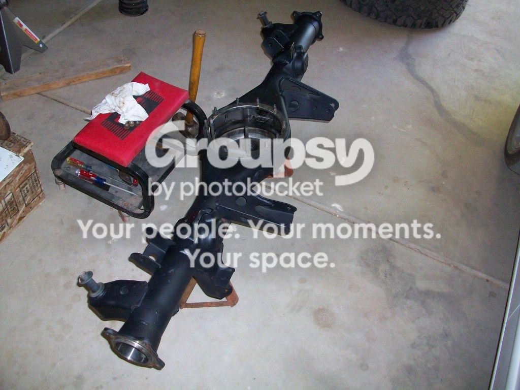

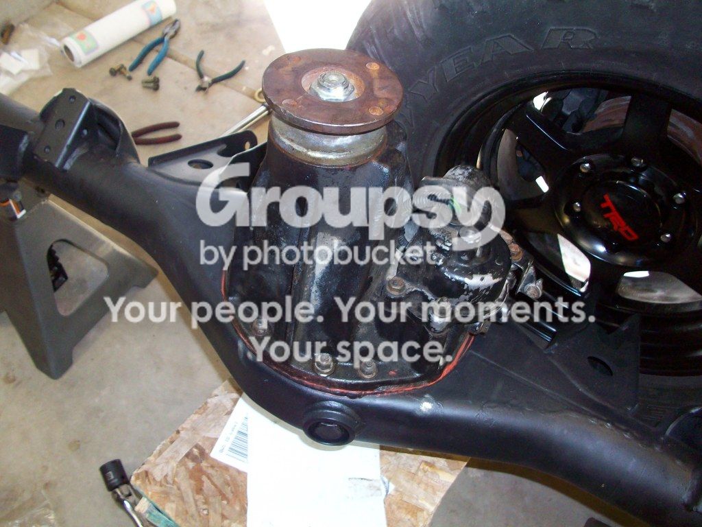

As I mentioned, I picked up a used Elocker housing from a '96 4runner at the local U-pull-it yard for $60.
You'll remember I had to drilla few holes for the brake brackets.
Got the new axle painted.
127_1368.jpg~original
127_1367.jpg~original
Picked up some extended bump stops from the parts yard.
127_1369.jpg~original
Starting to get the new axle ready:
127_1389.jpg~original
Dropped in the new Elocker 3rd.
Used toyota FIPG and waited the prescribed amount of time for it to dry before torquing the nuts.
127_1390.jpg~original

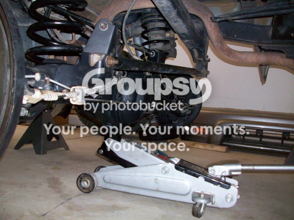

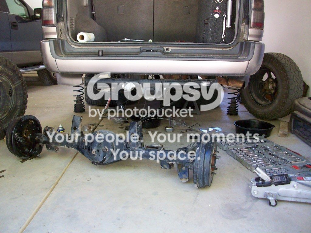

Axle in:
127_1391.jpg~original
127_1392.jpg~original

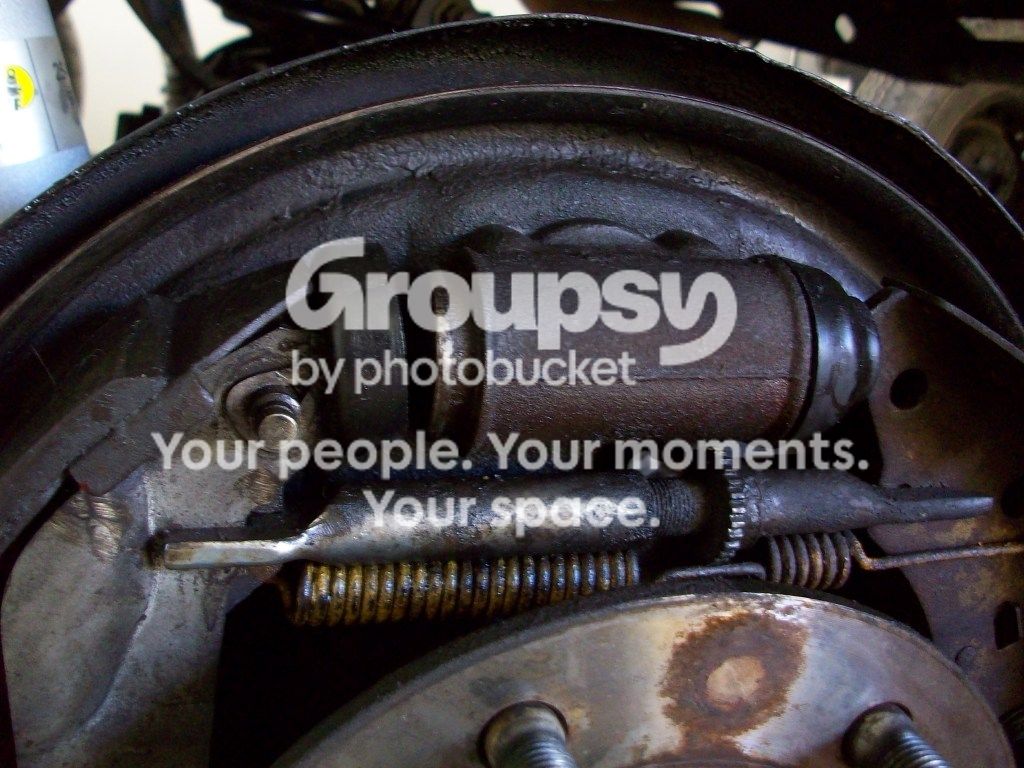

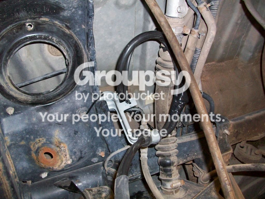

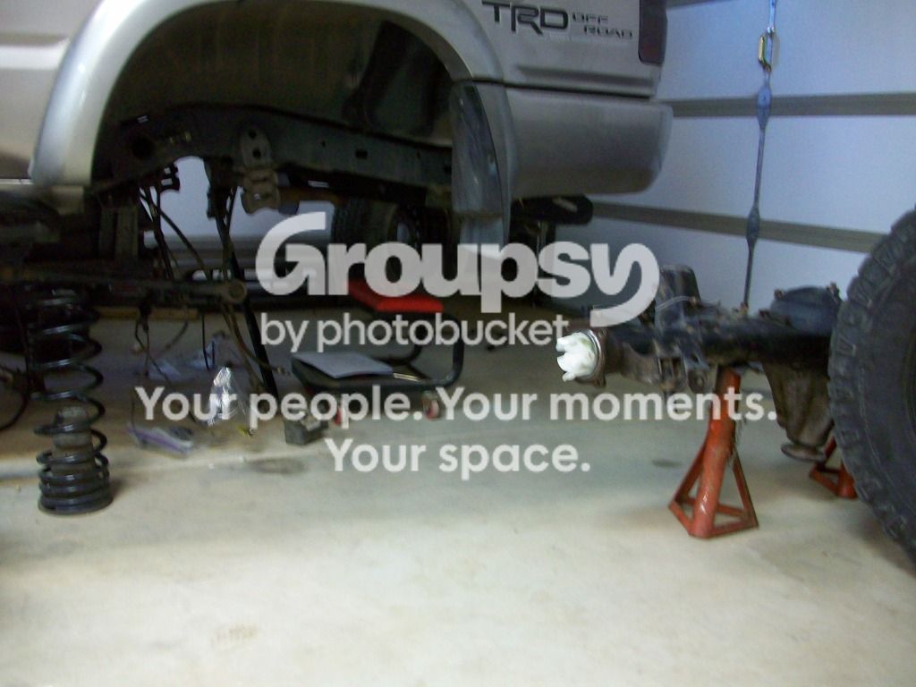

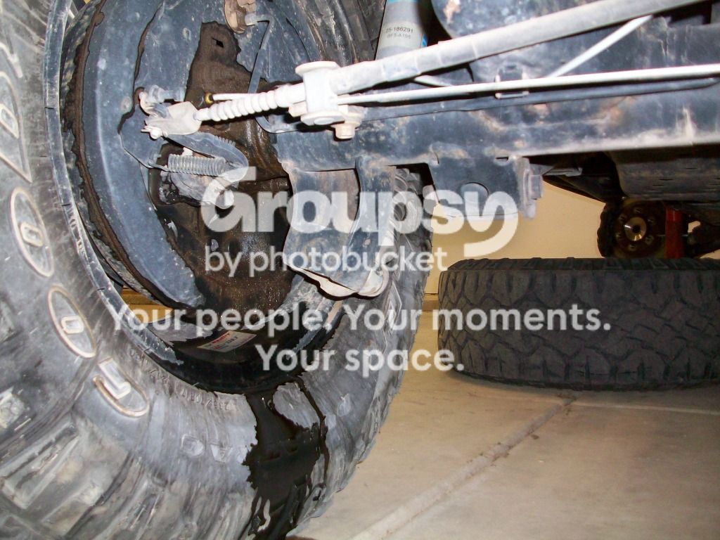

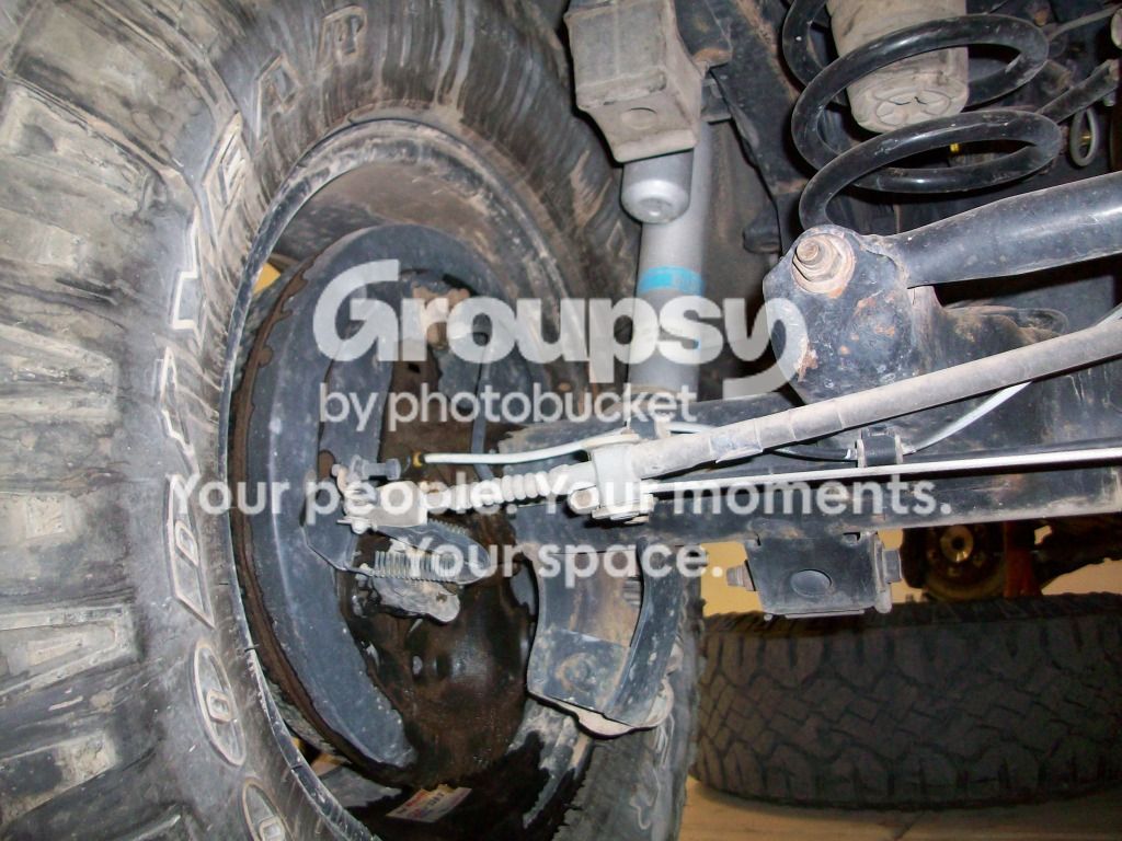

So you may remember a few weeks ago I posted this picture thinking I had a leaking rear axle seal. Well If you actually LOOK at it, you can obviously see it is not the axle seal leaking, its the brake drum.
127_13511.jpg~original
I had been experiencing a very scary brake problem in the days before I parked the 4runner and pulled the diff. The pedal would go to the floor and not have any pressure, but a second pump would net me the brake pressure I needed to stop.
So what do these have to to with each other??

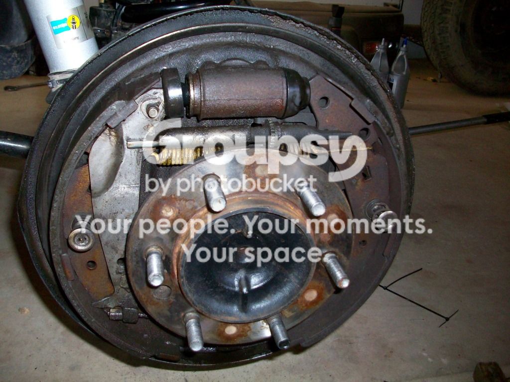

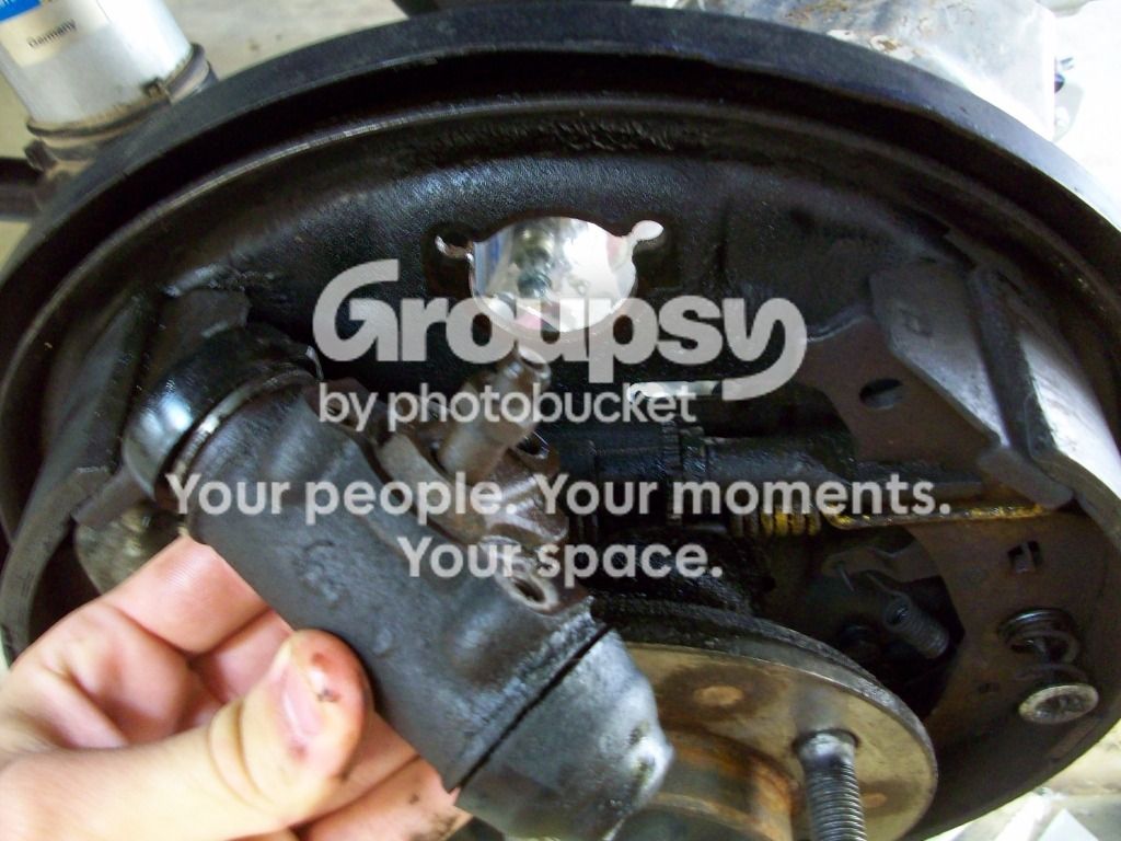

The rear brake cylinder was what was leaking, and boy was it! So I went to napa and picked up a new one for like $15, what a deal.
Brake drum off:
127_1393.jpg~original
This the cylinder in question:
127_1396.jpg~original
Out!
It was actually really easy to replace, 20mins easy. Don't have to take anything apart in the drum.

After I got the new one in I bleed the brakes and finished up putting the axle in and went for a test drive!
Everything works great! The locker engages and works perfectly, gears have been tested up to 60 mph and have no vibes or whistle or anything. Smooth sailing!
