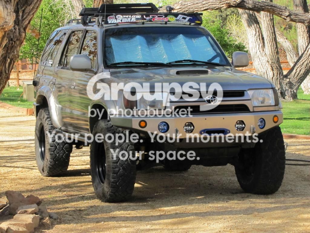

Looks good Jim, the blue works well with the TCM. I too, cannot wait to see a winch in that bumper!! Although, I understand your hesitation, it's a pretty heavy and unpractical device to DD around all the time.
What was your key reason to go blue? Coincidentally your fog lights match pretty well with the theme. Clean 4Runner man, one of my favorites here. You need some projectors though to finish up the front end :D

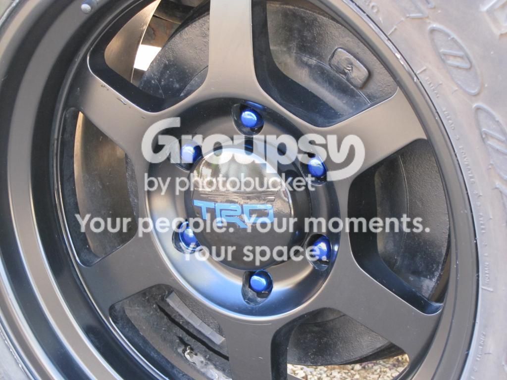

Did the metallic spray paint stick to the chrome lugs without scuffing then priming them? I don't remember but I know you did this awhile back also.
Looks really good, I definitely need to do this...thanks very much for reminding me bud.
Thanks Addison, Im really starting to like it.
Thanks man I appreciate that. After I did the winch fairing blue last year I wanted to go to the gray black and blue theme, and I needed to redo my center caps so why not?
I desperately need projectors! Stock lights such so bad. one day..
It was a certain type of paint that was meant to go on surfaces like that, I tossed the can so i have no idea what it was called haha. Thanks though!
Cool thanks! I think I'm going to hit my fairlead and light rings with some clear coat before I install them just for some extra durability.
I definitely would, clear coat is a must for that stuff.
