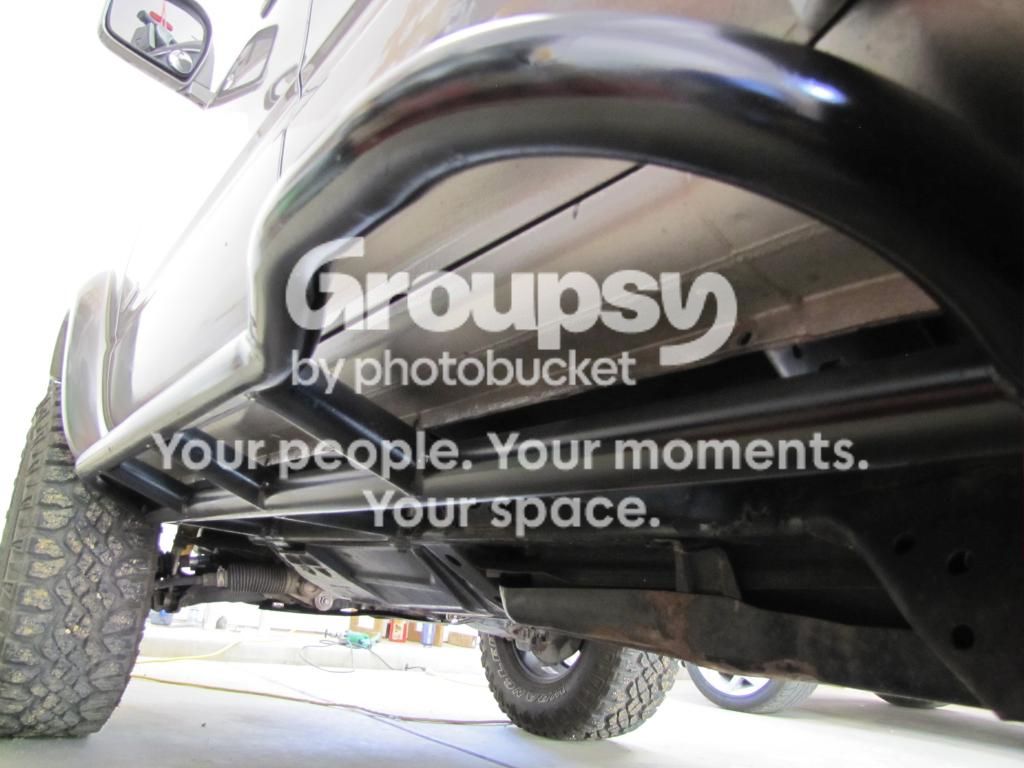

Repaint Sliders / Add Grip Tape
Today I had some free time so I re-painted my sliders and added some grip tape to them.

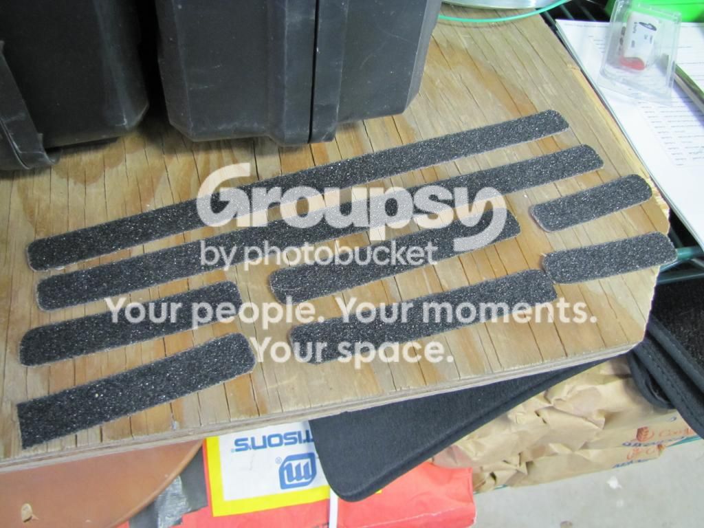

The paint I already had and the pack of precut safety tape was $3.87

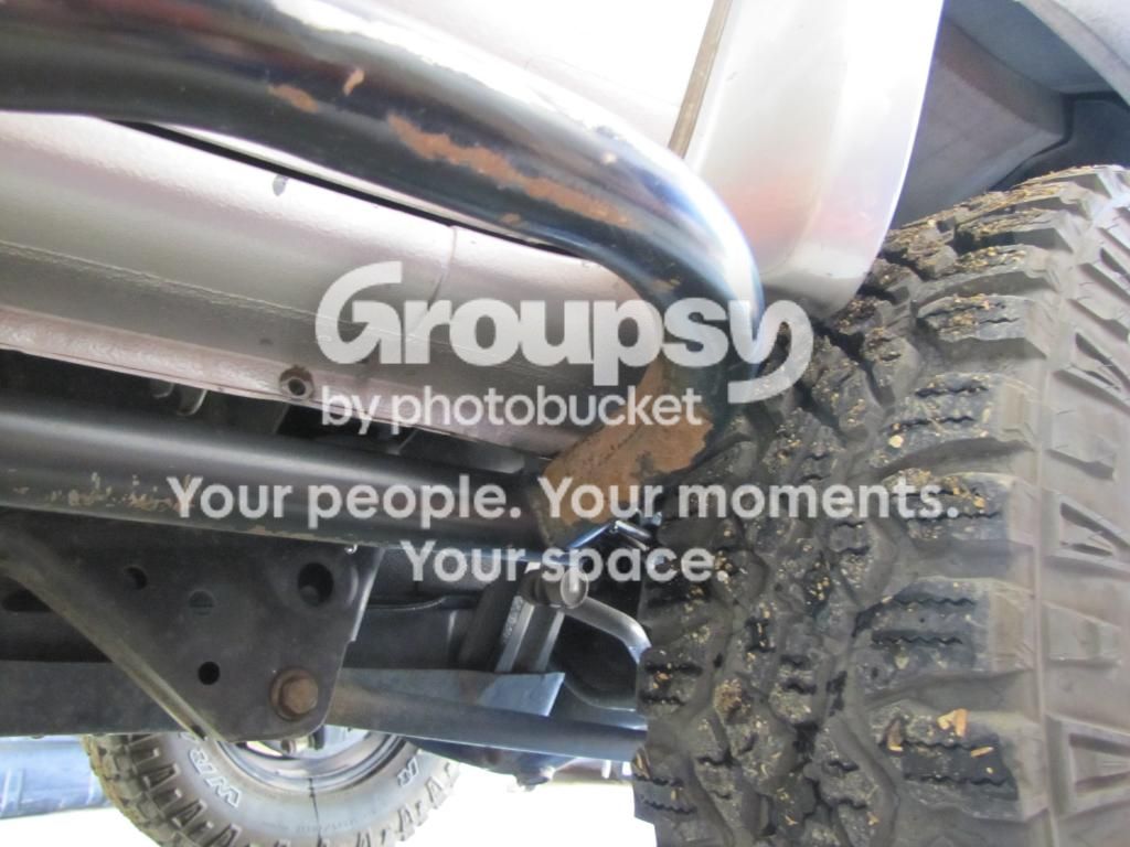

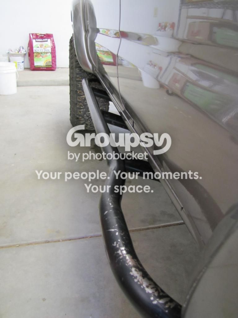

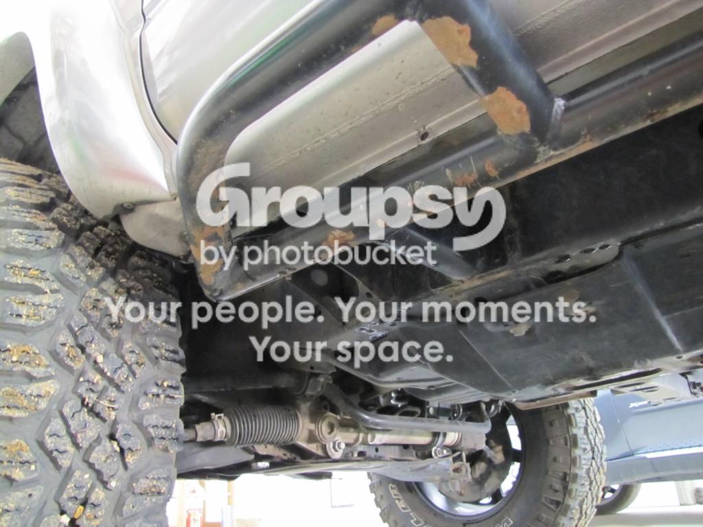

This was the condition of my sliders for pretty much a year now, exposed metal and oxidation.

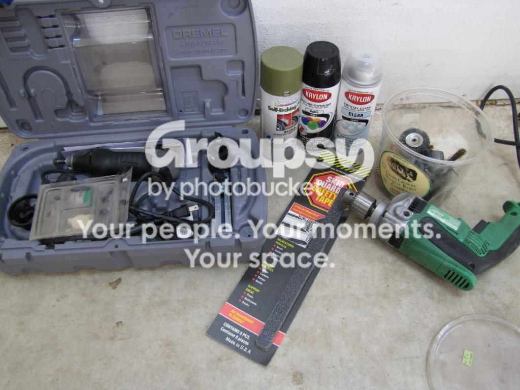

So I used the wire wheel and ground off all the oxidation and prepped for repainting.

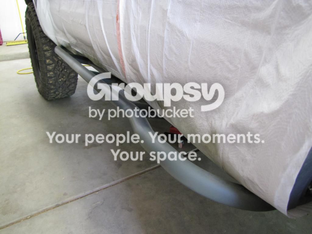

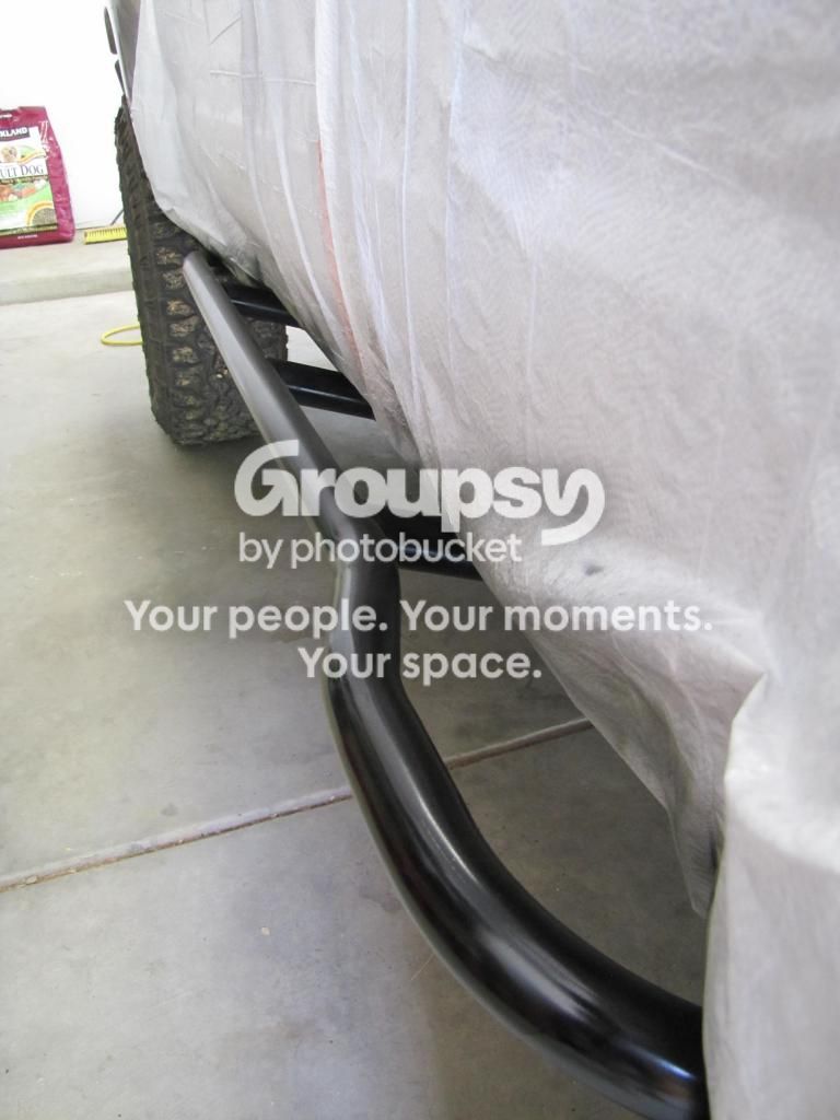

Primer:
Paint
Cleared:

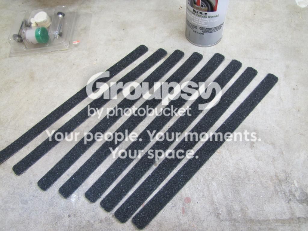

Then for the grip tape, the package came with 8 pre-cut strips:
I cut two of the strips into smaller pieces:

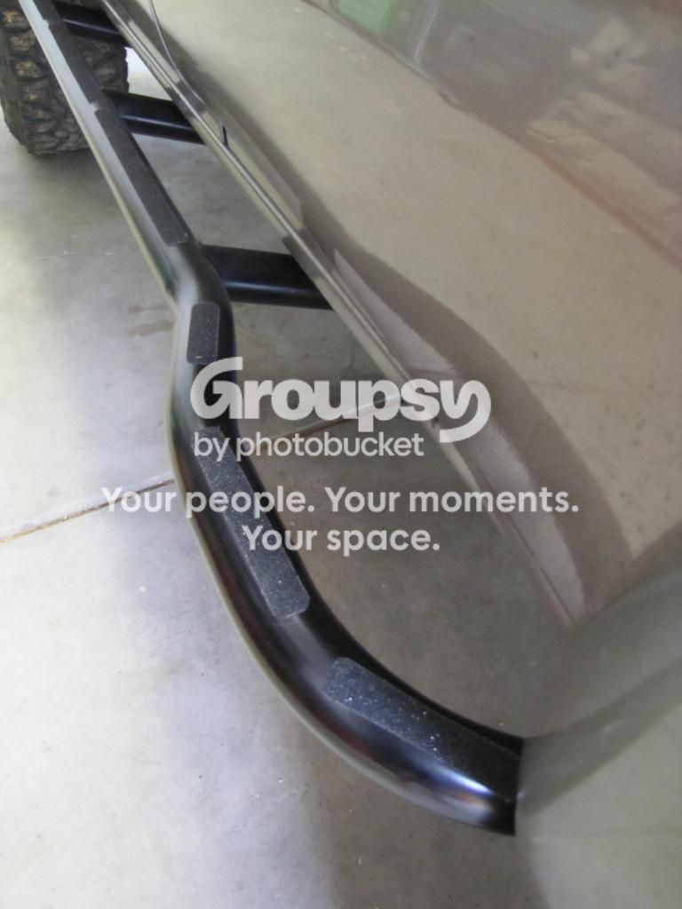

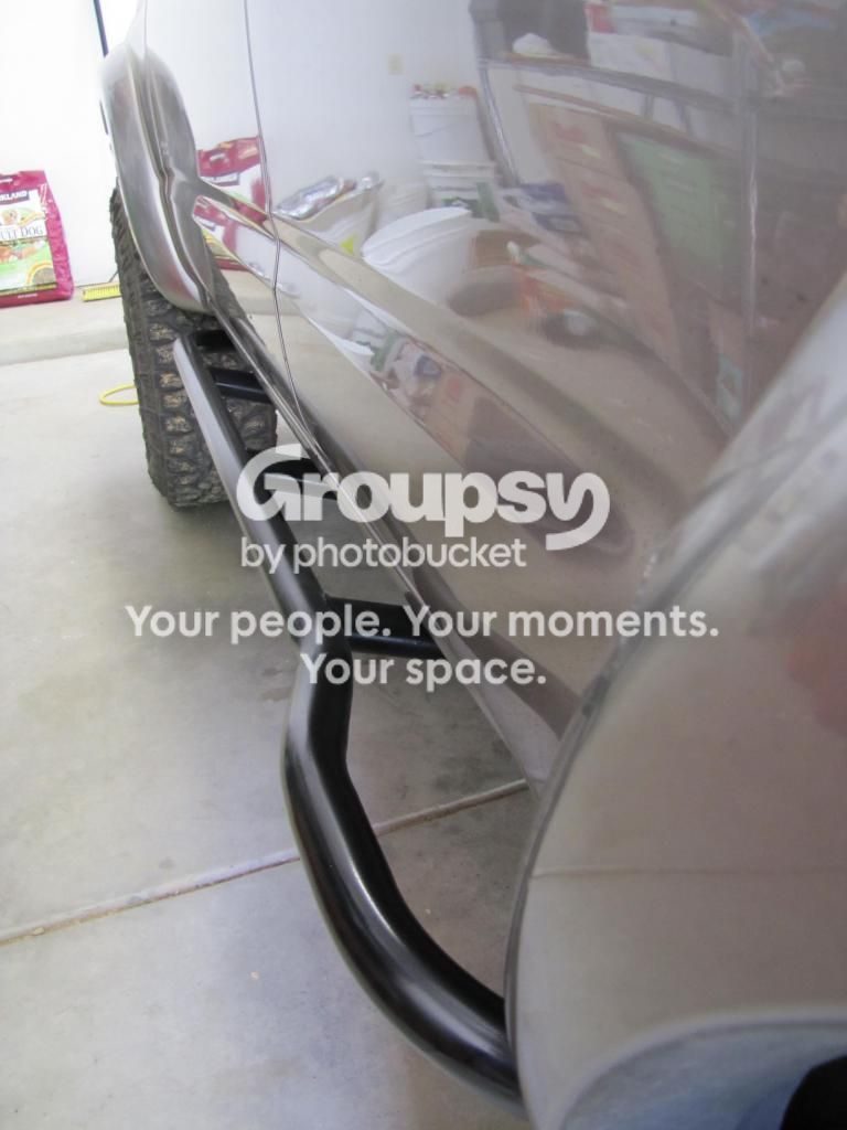

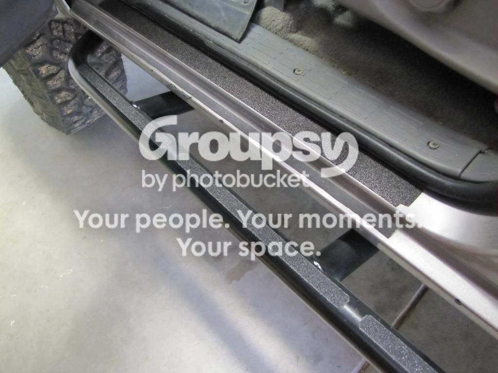

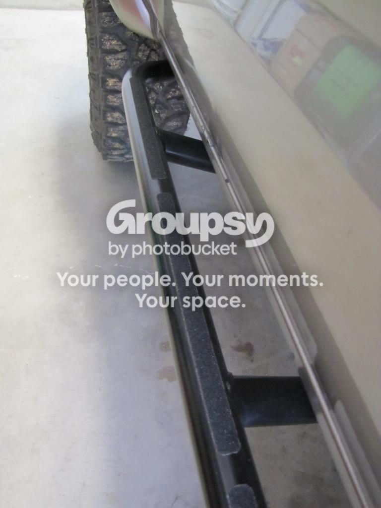

Applied:

Sliders look good Jim, those strips are really durable also! I have had the same ones on mine since January and they have not budged from being stood on or lost any noticeable amount of anti-slip properties on top.
Got the idea from you brother! And thanks.
