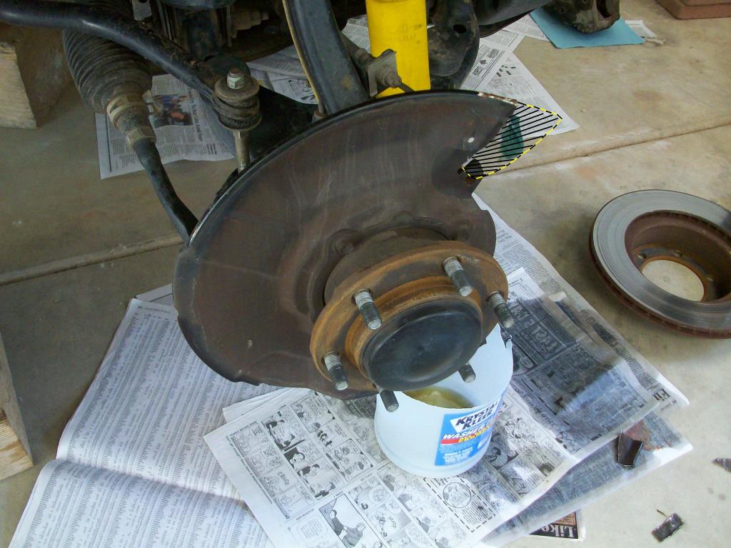

What was the cost for all the parts to do the 231 mm brake upgrade??
Thanks!
Brakes + Taxes - Core refunds = $378.41
Worth every penny.
Mine was $343.43 after the core refunds. That also included large bottle of brake Fluid, a can of brake cleaner and an extra pack of springs and clips.
AutoZone was a bit less than NAPA plus - I got teh "Bling"

Also, small update on the Tundra 231 brakes, I got them bedded in a while ago and they absolutely rock now!
Before I was scared to brake because of how bad the rotors were warped, I avoided the highway at all costs. When braking I actually thought my truck was going to break apart! It is so butter smooth now. The pedal is a small bit mushy, but I can deal with that seeing as how I can again feel safe using that pedal..
Its been so long since I have had properly functioning brakes, but I venture to say that these are quite a bit better at slowing me down versus stock.
That Bed-In process works wonders!!!

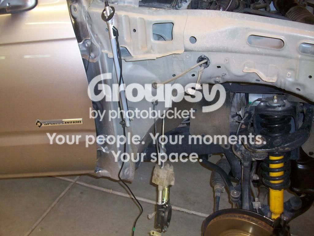

Today just seemed like the perfect day to tear my fender off..
What & Why:

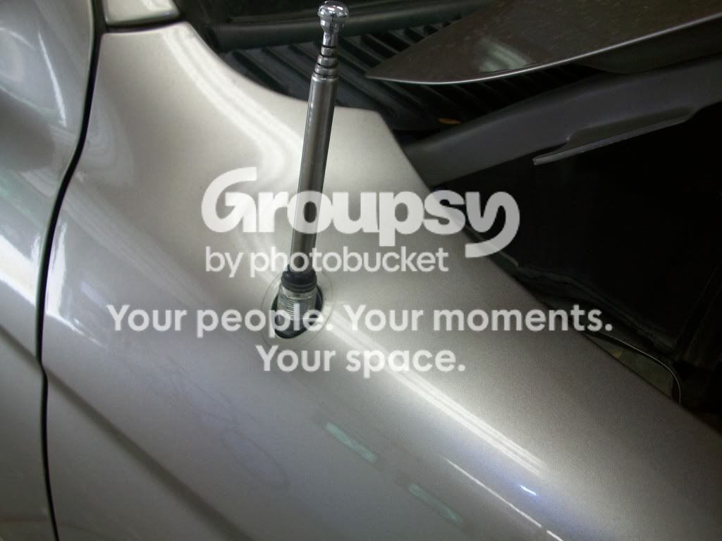

The stock power antennas on the 3rd gen 4runners are known to fail, in many ways. With mine, the gears had become shredded and the motor made a horrible noise anytime it tried to raise/lower the antenna.. which is every time you insert/remove the key!
The "Tacoma Whip Mod" replaces the stock 4runner power antenna with an OEM whip antenna from a Tacoma. No more failing motor to deal with and better reception. Seemed like a double plus to me!
The combine antennas mod is necessary for aftermarket stereos. The 4runner actually uses TWO antennas. One in the front, and another in the rear passenger cargo glass. While the OEM stereo has a port for each of these, aftermarket stereos DO NOT! They only have a port for the front antenna. To fix this you need a Y-Splitter to combine them.The rear antenna plug is smaller, so an adapter is also needed.
Parts:
OEM Tacoma Antenna Assembly: 86300-35090 - $36.94 from dealer
(above comes with a silver antenna also.)
OEM Black Tacoma Antenna: 86309-AA040 - $27.38 from dealer
-I didn't buy the extra Black antenna, I just painted the silver one black to save 30 bucks.
Y-adapter: Amazon.com: METRA Ltd 40-UV43 Motorola Antenna Y-adapter: Electronics
Size adapter: Amazon.com: Scosche Mda-B Micro/Delco Antenna Adapter Tip: Electronics
Tools:
Every bolt involved in this is a 10mm, so..
-10mm socket with ratchet.
-10mm ratcheting wrench (couldn't have done this mod without this tool)
-flashlight
-Phillips screwdriver
Resource threads:
http://www.toyota-4runner.org/3rd-gen-t4rs/75575-taco-whip-mod.html
The "Taco" Whip Antenna Mod
http://www.toyota-4runner.org/3rd-gen-t4rs/62658-front-fender-removal.html
Guide on How to Combine Both Front & Rear Antennas into One on an Aftermarket Stereo - YotaTech Forums
Time:
It really depends on how much of a fight the fender puts up. Took me 2.5 hours.

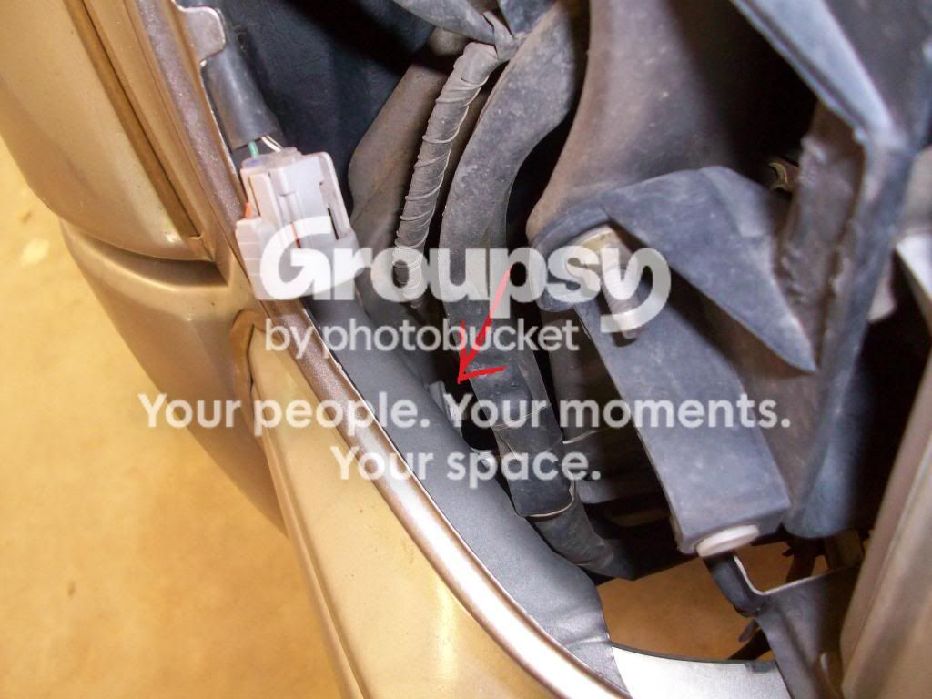

Here are the locations of the bolts, remember they are ALL 10mm.
The three under the corner light are an absolute pain in the A$$ to reach. Those are where you need the ratcheting wrench.

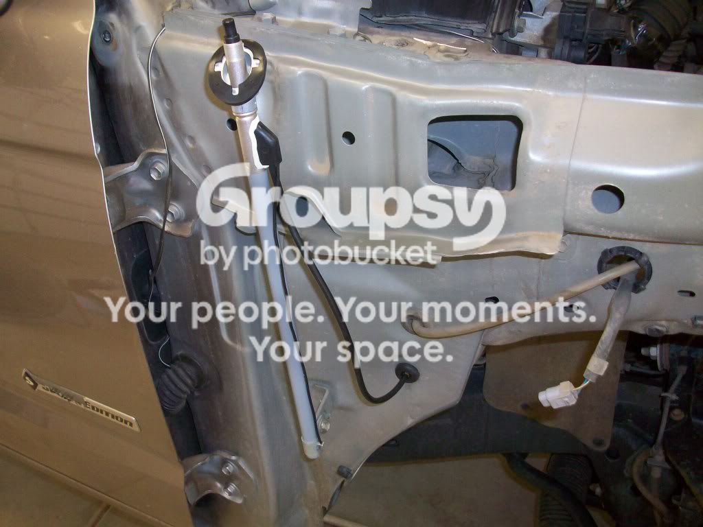

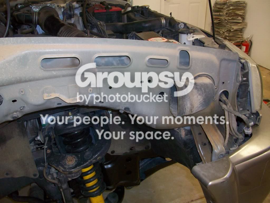

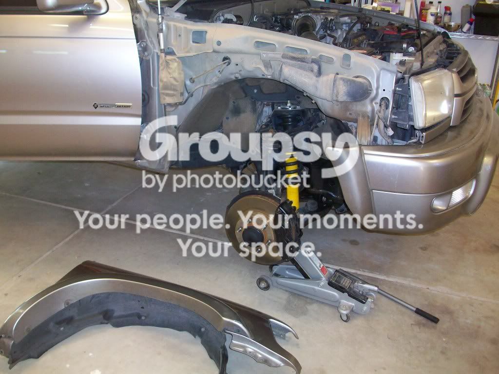

Fender off:
108_0971.jpg~original
Removed intake "snorkel". Kept the elbow in place.
108_0972.jpg~original
New antenna in: Old antenna dangling by the antenna cable.
108_0973.jpg~original

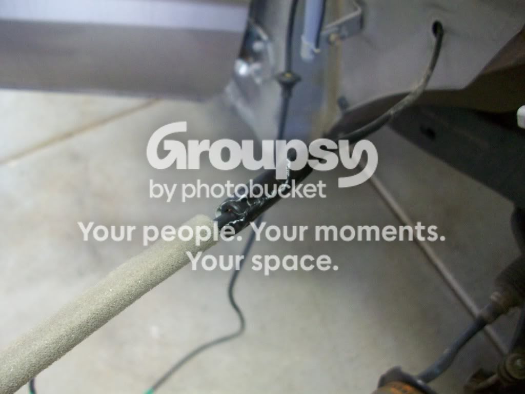

To feed the new antenna cable through, I cut the old one and taped the new one to it. Then just pull from radio side and the new cable will follow it through. (there are 4 clips behind the dash that must be undone first)
108_0974.jpg~original

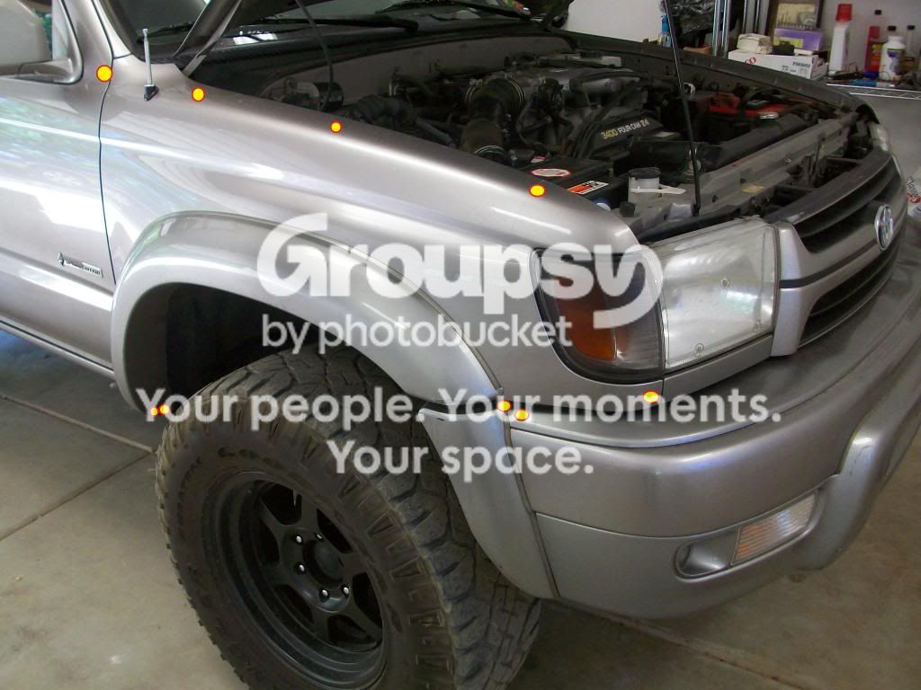

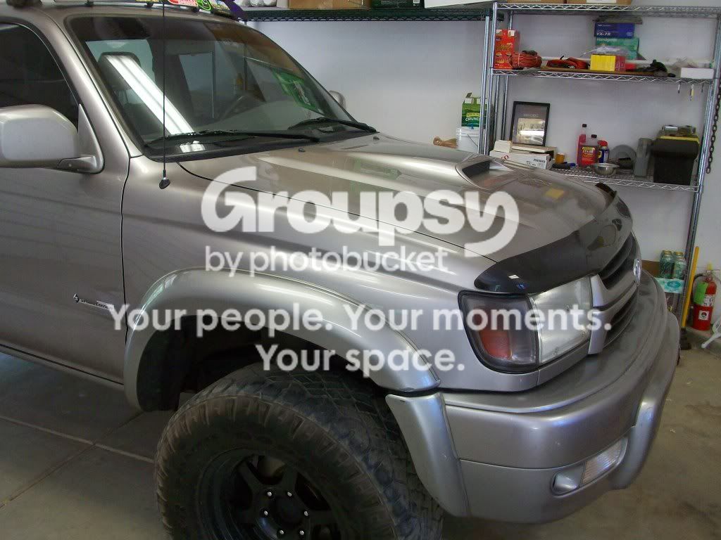

Done:
108_0976.jpg~original
108_0977.jpg~original
