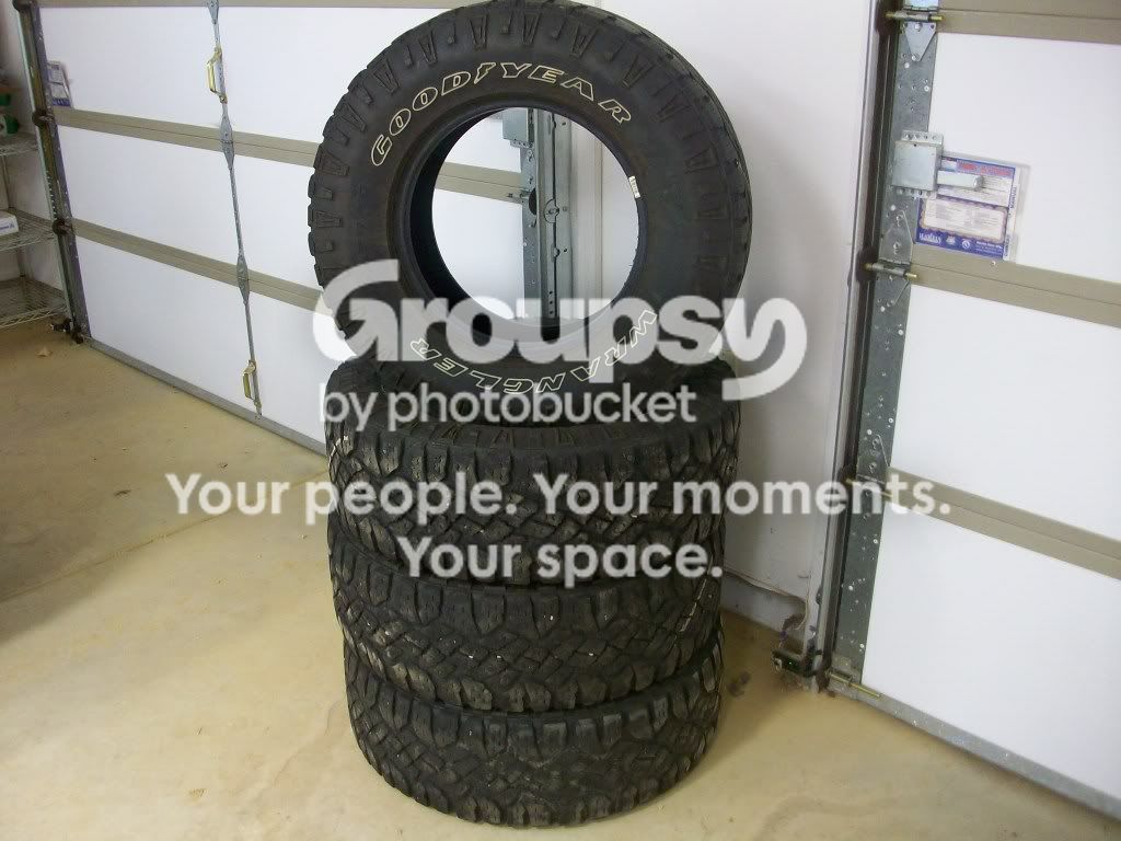

Got some tires. 285/70/17 Duratracs. $300, 55% tread. Picked them up in Denver over the weekend.

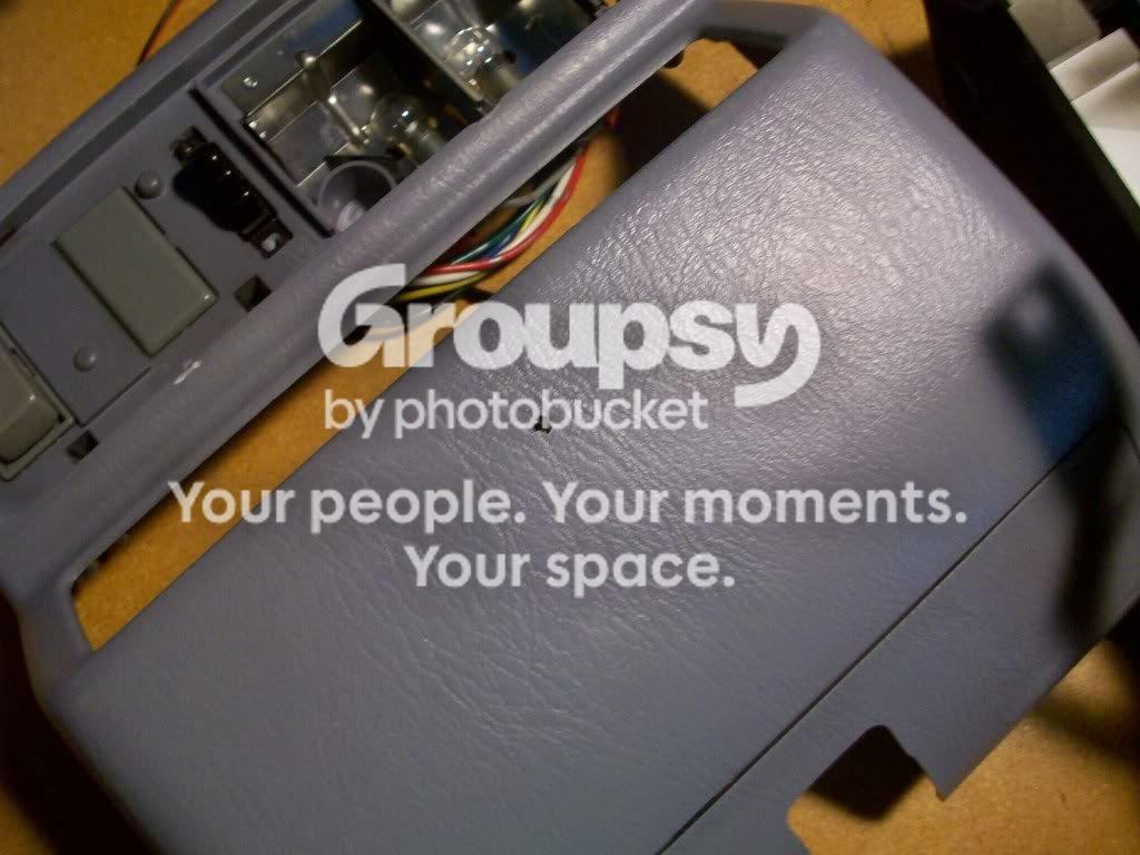

Took off the field monitor:
108_0899.jpg~original

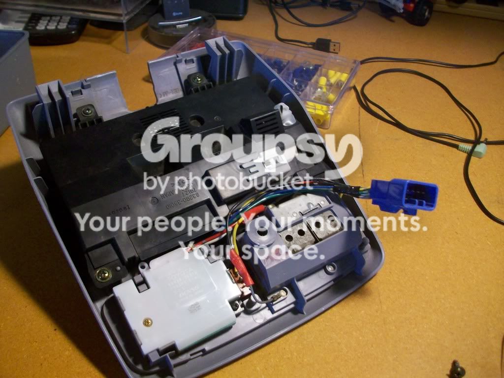

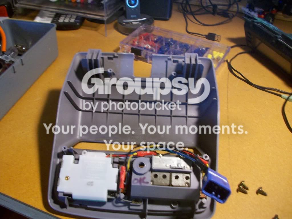

Remove the monitor from housing:
108_0902.jpg~original

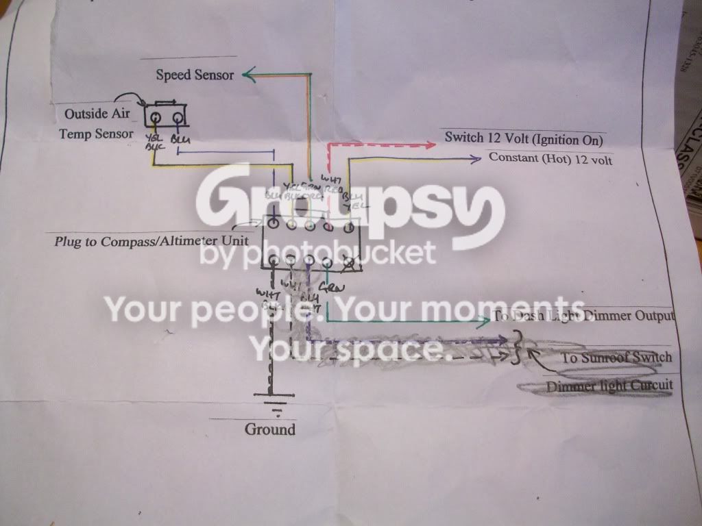

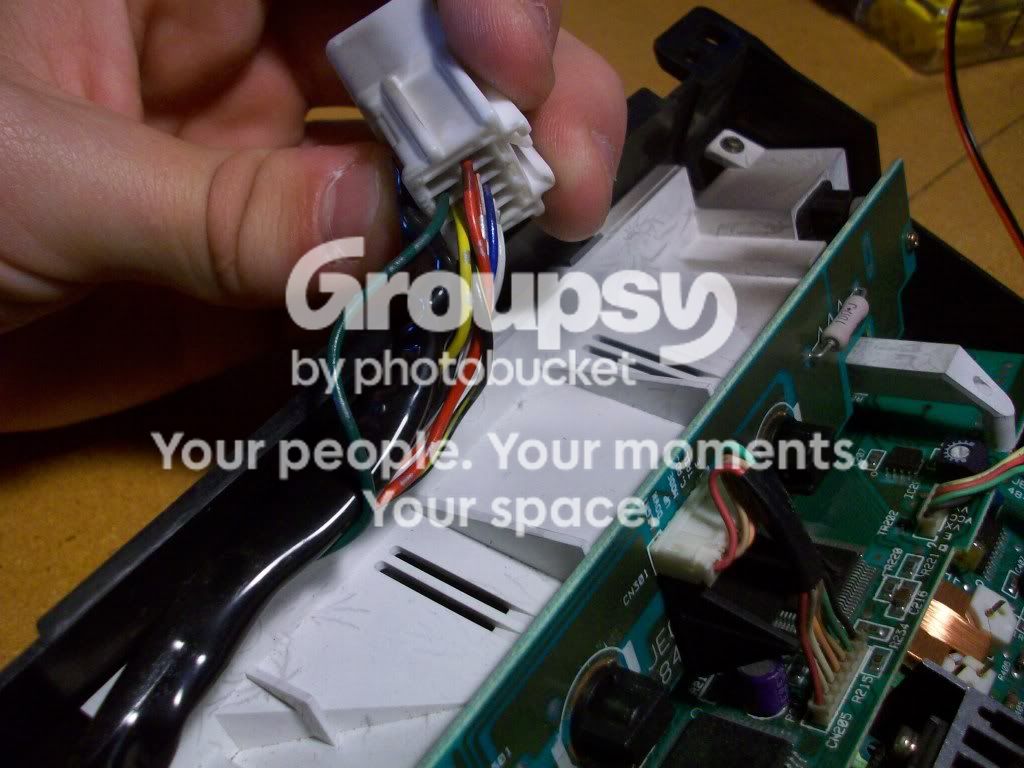

Here is the wiring diagram from the plug on the field monitor, I needed to tap the "dash light dimmer" and the Ground:
108_0904.jpg~original
I tapped into the wires on the monitor side of the plug instead of the other side of the plug. In case I ever need to remove it again, the light is attached to the monitor:
108_0905.jpg~original

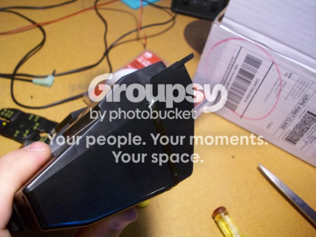

Drilled a hole. I don't remember how big it was, most likely 3/8". Maybe a bit smaller:
108_0908.jpg~original

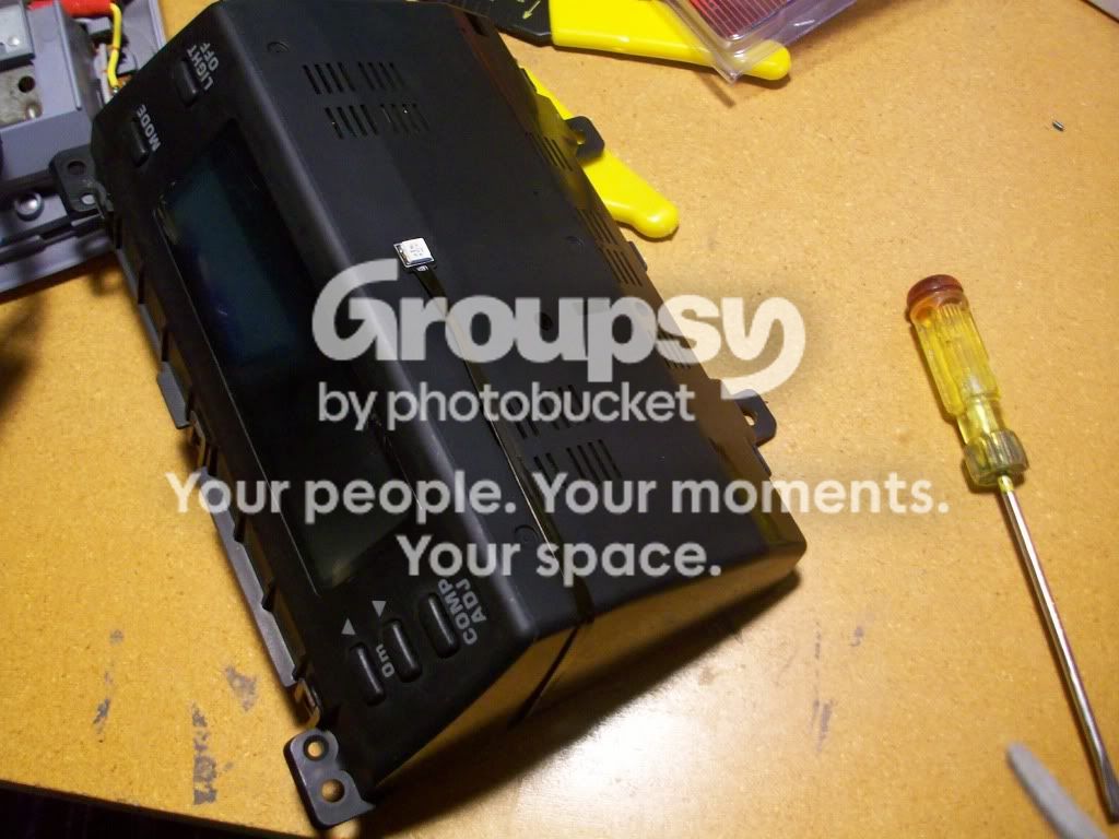

The module comes with a sticky backing, so just stick that to the monitor:
108_0910.jpg~original

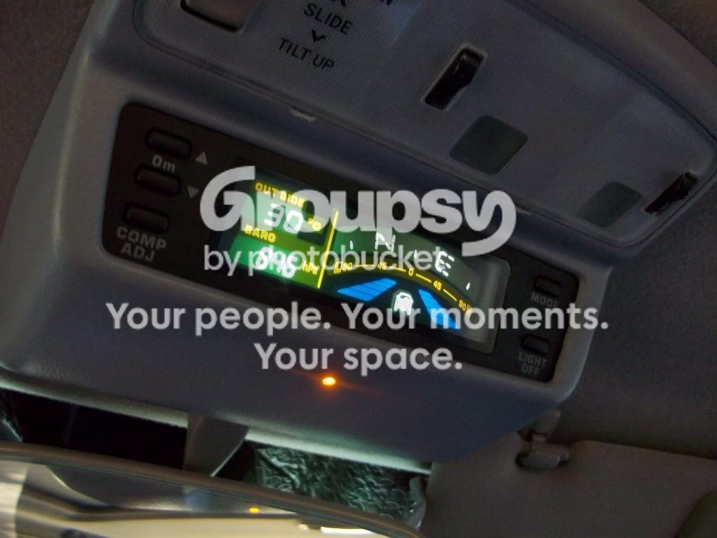

All done:
108_0913.jpg~original
I do not have any nighttime pictures, my camera just sucks too much for those. But I assure you, IT WORKS GREAT! Not to bright to distract you, barely even noticeable. But it provides a nice little glow to the interior.
