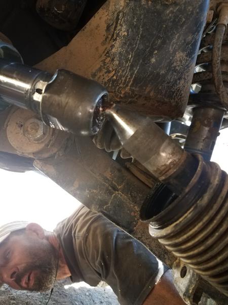

The Dusy was a doozy. Ranger was pooped after someone broke his third of four for the trip. More to come once I get home.
Sent from my SM-G930R4 using Tapatalk
It still drove home. lol
I'll get some photo's of the broken CV's and we can all have a good laugh. Thanks again for the bottle jack trick and for helping replace those things that broke. lol
No problems. Sure didn't take anything away from how fun the trip was.
