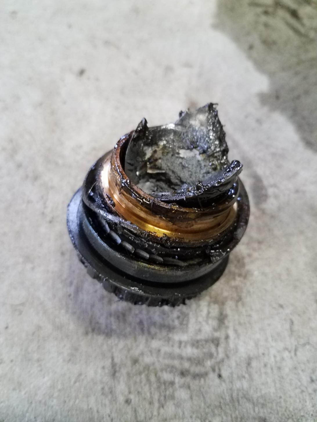

I didn't have great luck with the OEM ones either - broke this one and it took out my manual hub.

A company used to make “hub fuses” for 1st gen Aisin hubs. The inner ring which the dial face moves up and down to connect the hub body to the inner splines was modified with some weak points. This ensured it would fail first. But then your hubs would be full of metal chunks so I’m not sure it was that much of a benefit...
I used to have some on one of my first gens. I thought they broke wayyyyy too early.
