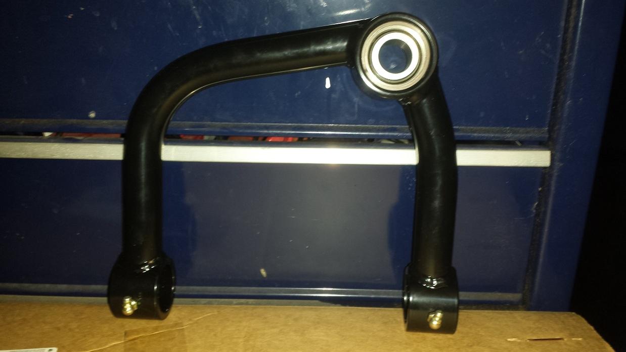

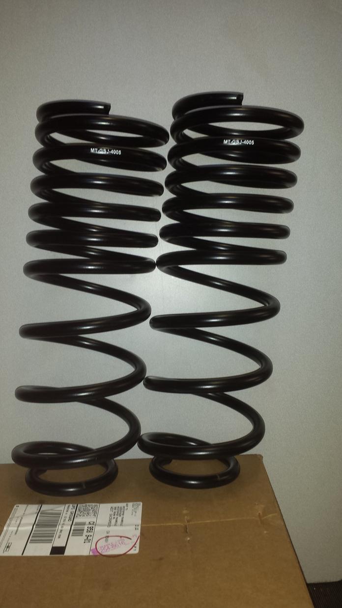

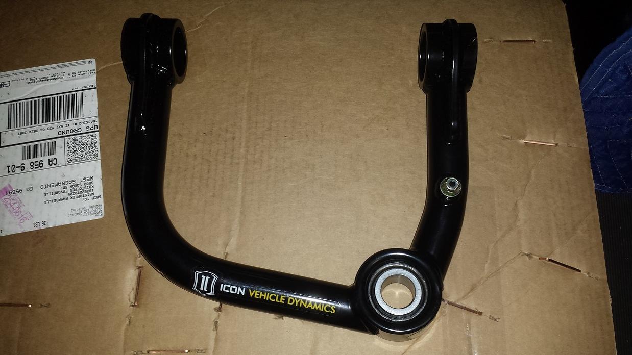

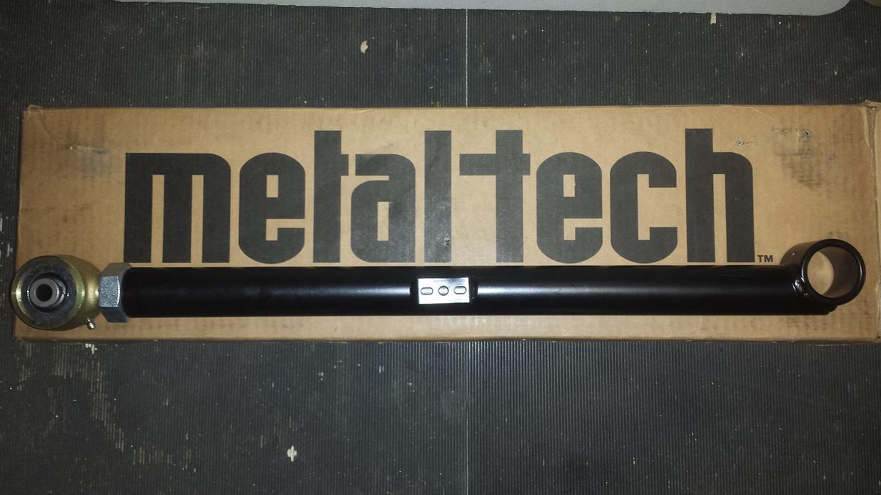

A man in brown showed up yesterday with a package or two. Now to find wheels, tires and time, and the fun will begin. That and may have to let someone borrow the Runner for some fun stuff, so stay tuned for that one as well. In the mean time, play the guessing game and wait for pictures of everything opened up.

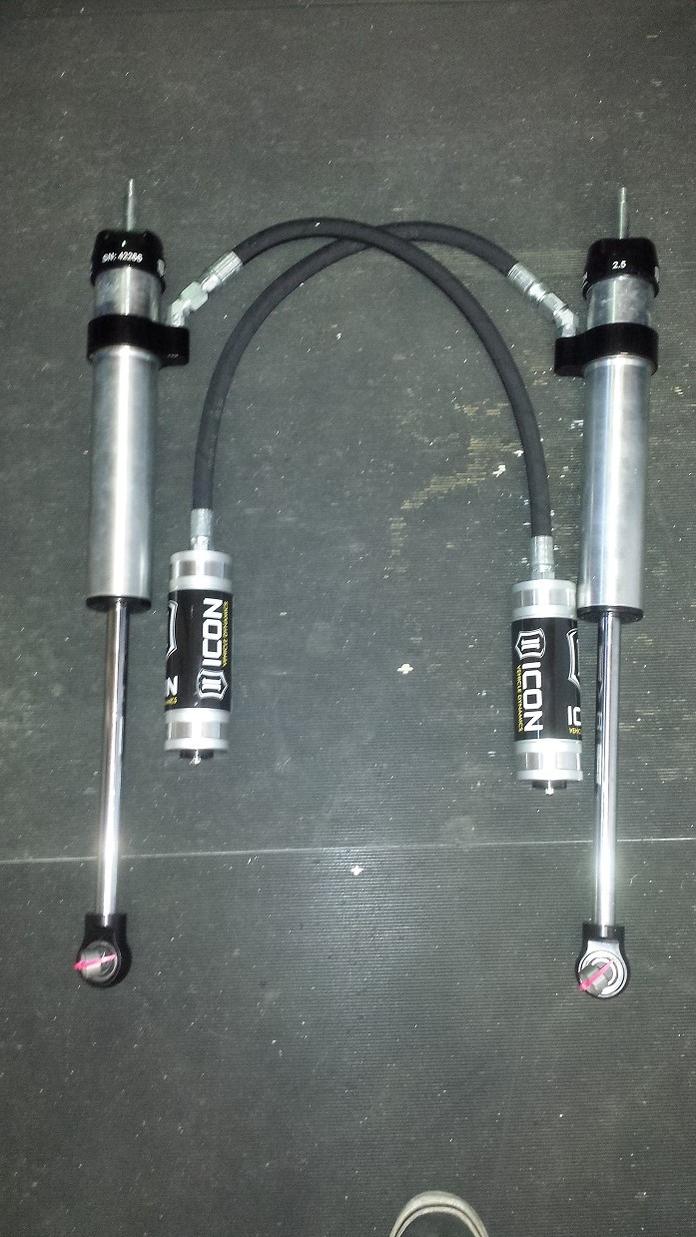

Guess the front coil overs still have yet to ship. The rear 2.5" shocks are massive. Can't wait to start putting all of these into place.
