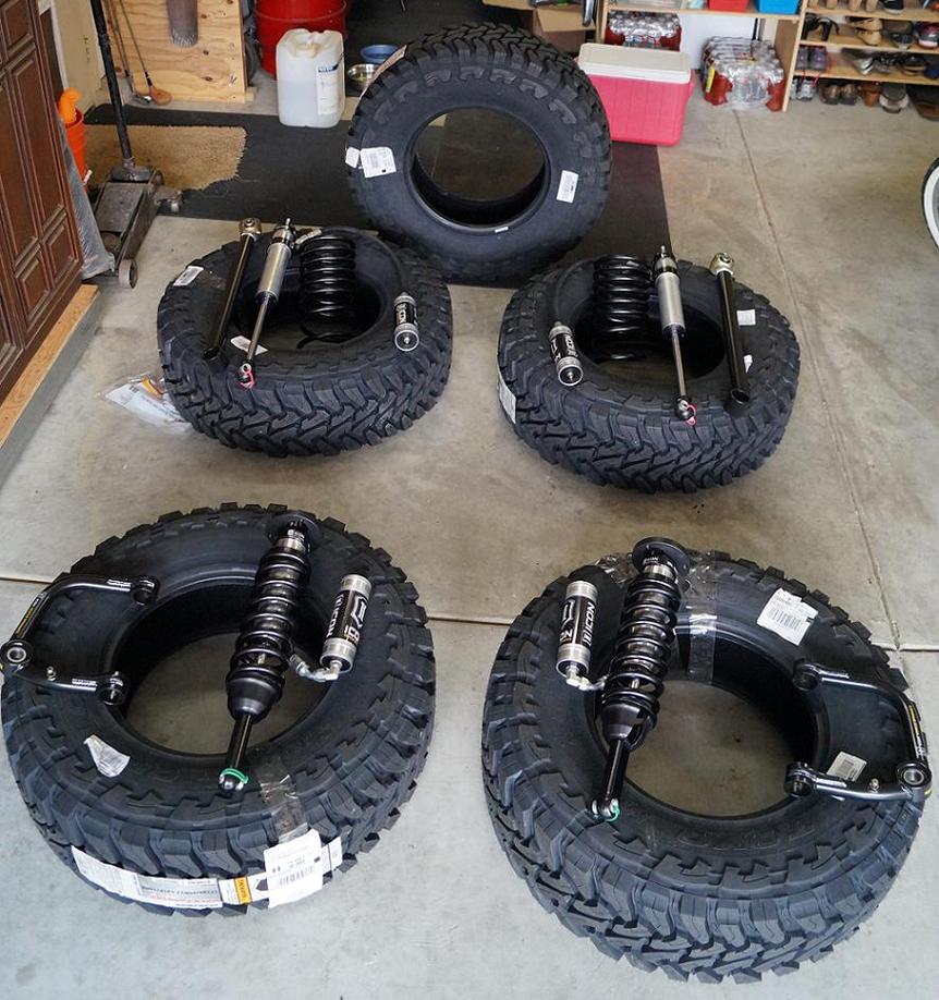

I love Santa's little helpers in brown. 4 - Toyo MT's in the 285/75R17 flavor and Icon 2.5 front coil overs with remote reservoir. Waiting for wheels to come in and the 5th tire to arrive.

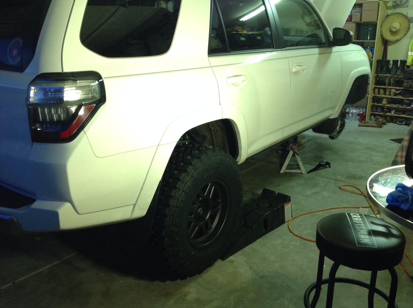

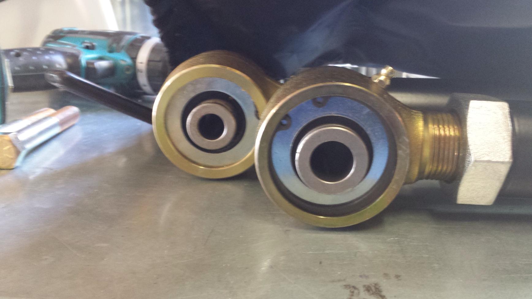

Started install of the Metal Tech LT rear suspension today only to discover that the Johnny Joints have two different bolt hole sizes, which means the larger one will not work. Of course only after everything is torn apart do I find this. Well, charge ahead and get close to 2/3 complete. Should hopefully button the rear up tomorrow, minus the one link, then time to tackle the front.

Been a long weekend. Got the back mostly done, just waiting for the replacement Johnny Joint from Metal Tech so I can swap the lower control arm. Now, just need to add some weight as it's sitting pretty high.

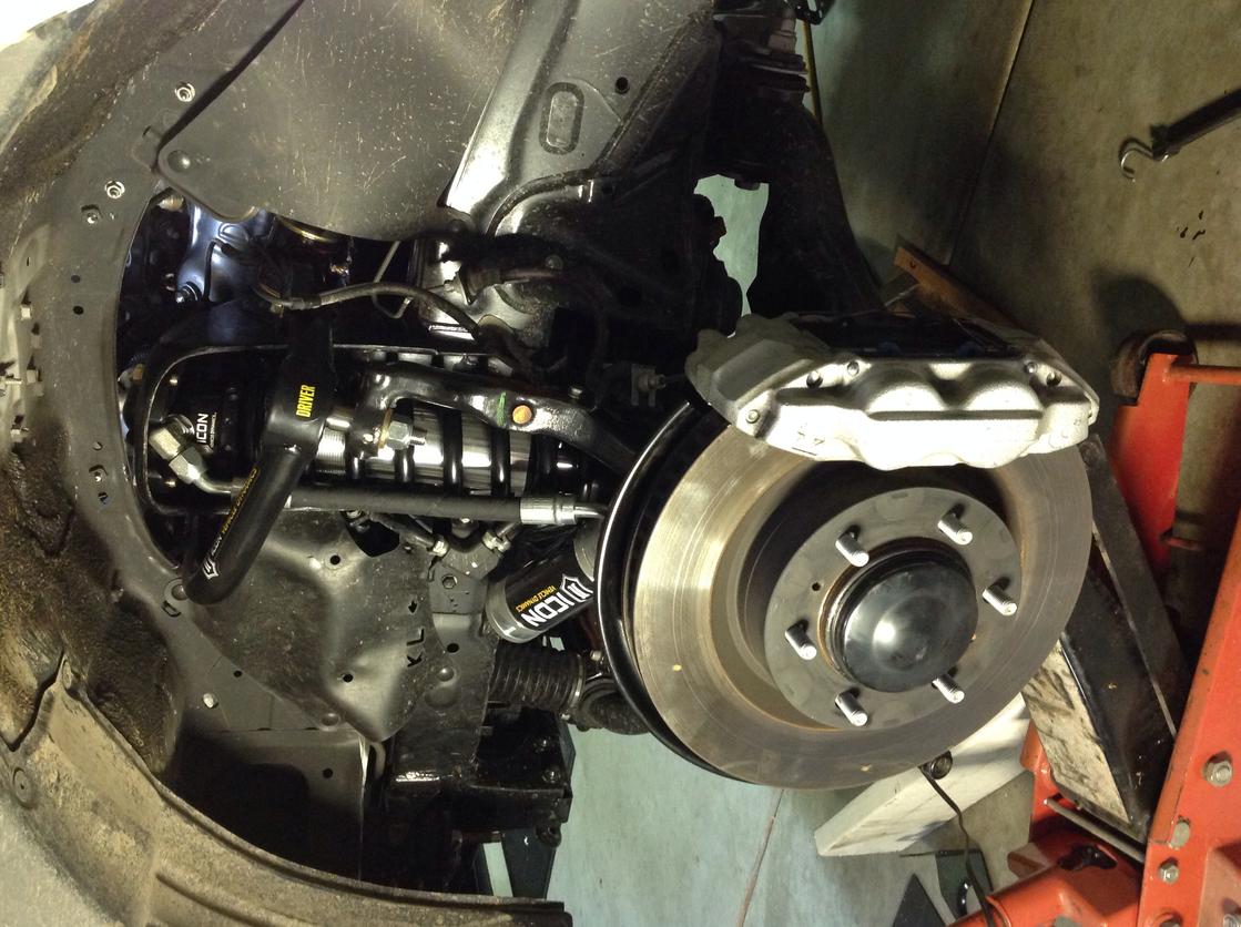

The front has been a real ass kicker. Going at this alone makes it all that more challenging. Almost done with drivers side, then time to switch to the other side.
Surprisingly, no cuts or skinned knuckles. Only on screwdriver under the thumb nail, thank goodness for gloves. There was still blood, but it could have been much worse.

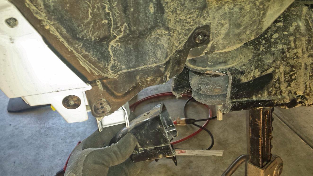

Good bye to the excess body mount, good ole sawzall and Torch blade made quick work of it. Good thing for gloves again, one smashed finger and chunk of the cuticle torn off with the glove on. Cleaned up with a flapper wheel and paint. Will weld some reinforcement later.
