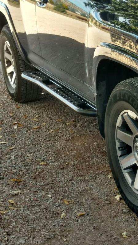

Here are the C4 Fabrication rock sliders on my 2016 Trail w/KDSS.
I am in the slider market as well and have spent quite a bit of time reviewing this site for options/opinions. What's weird is the sliders I am most interested in, Hefty Fabworks, have little play that I can find among this crowd. Can anyone offer more insight on Hefty?
I've got a set on mine. I like the look, they fit well, install was super easy (HeftyFab installed for me ;-) ) and the cost was in line with everyone else.
I haven't 'used' them yet, but it's hard to imagine they won't hold up as well as any others.

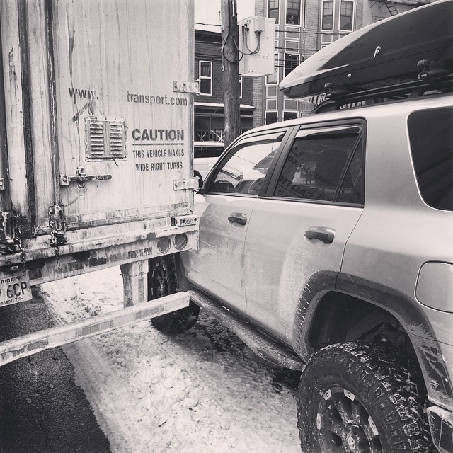

I love my new Budbuilt sliders. Chip spent his valuable weekend time helping me install them. Thanks Budbuilt and Family.
Another vote for BudBuilt. They work great protecting from real rocks AND rocks for brains.

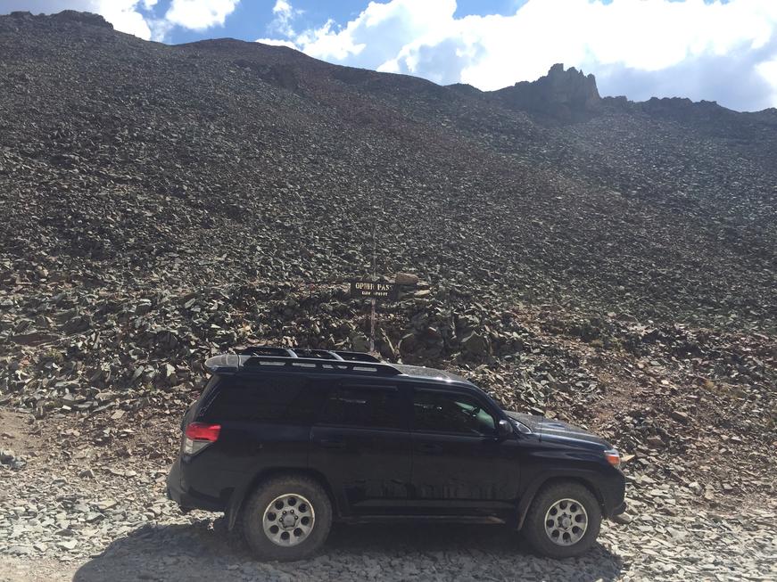

BudBuilt customer here.
They were kind enough to install them for me instead of ship them! Located in western NC, caught them on a trip down to my parent's place for Thanksgiving one year.

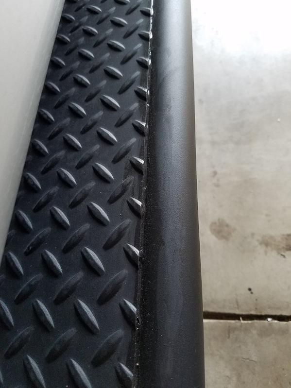

A word on any sliders with treadplates which are not continuously welded. Save yourself a rust headache and fill the gap between the tube and the treadplate with black silicone while the sliders are new. Water gets trapped in the small channel created there and it will rust because even powder coat doesn't get all the way in the crack. I had to use a rust converter for touch up 1.5 years after I got them installed. I then laid a thin layer of silicone on top, and a thick bead on the bottom. I don't wash all the nooks and crannies on the underside of my sliders very often, so better to protect it from road salt sitting in the slider.
