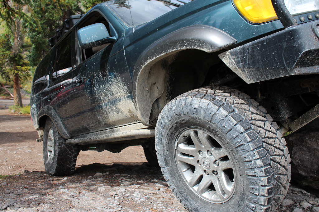

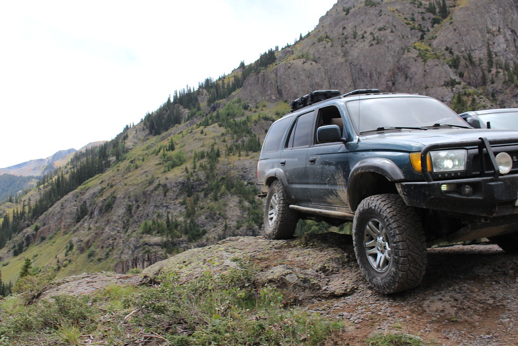

I highly recommend the Stubbs Welding HD-SKO:
I like those sliders and your truck looks great, but to me those look more flat? I'm looking for the ones that are more angled up, that's what I mean by "tucked in"
I've got a 1" body lift and I intentionally spaced them a little farther down. This is what the angle looks like off the vehicle.
The HD-SKO sliders that Stubbs makes are so excellent. I have them and I welded them as close to the body as possible.

Pictures of my HD-SKO sliders
As you can see, the angle which you look view them from can impact how low profile they look.

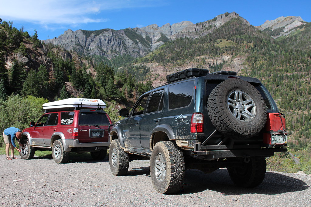

Also, [MENTION=9139]steezemcqueen[/MENTION] has some that are like [MENTION=83356]rideexileex[/MENTION] and I do have a picture of them:

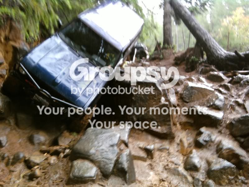

a set of 4xinnovations sliders with kick out saved my bacon with my old 81 trekker
when i was stuck between a rock and hard place you can see the kick out down here

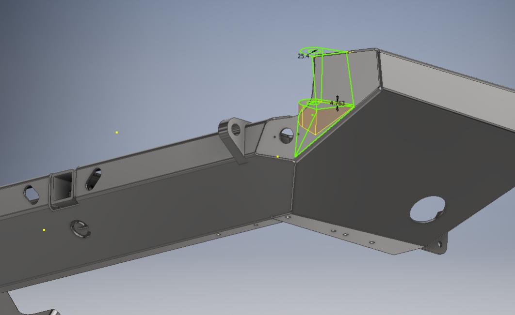

(working on that swingout hinge mount still - this evening in fact - finally made one I don't hate, lol)

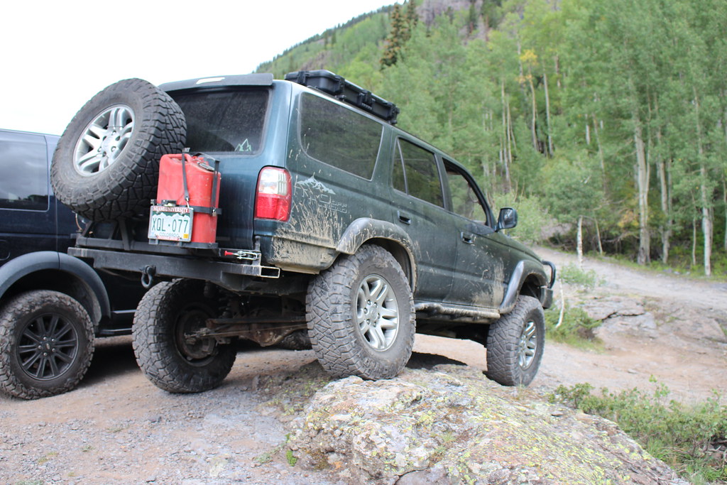

Respectfully disagree....
The problem with having bars that stick really far out is the leverage they create. Yes, that can be overcome by reinforcing the frame (as one should do anyway)...but IMO, the more they stick out.....the more likely you are to hang up on them.
I always build mine tucked in pretty tight.....yes, you have to be more careful and IMO, full width axles help keep the body out of the rocks more....which is why this project will be getting 67" WMF to WMF axles eventually.
Here's a pic of my sliders....two tubes, 5 legs to the frame...you can hardly tell they're there.
