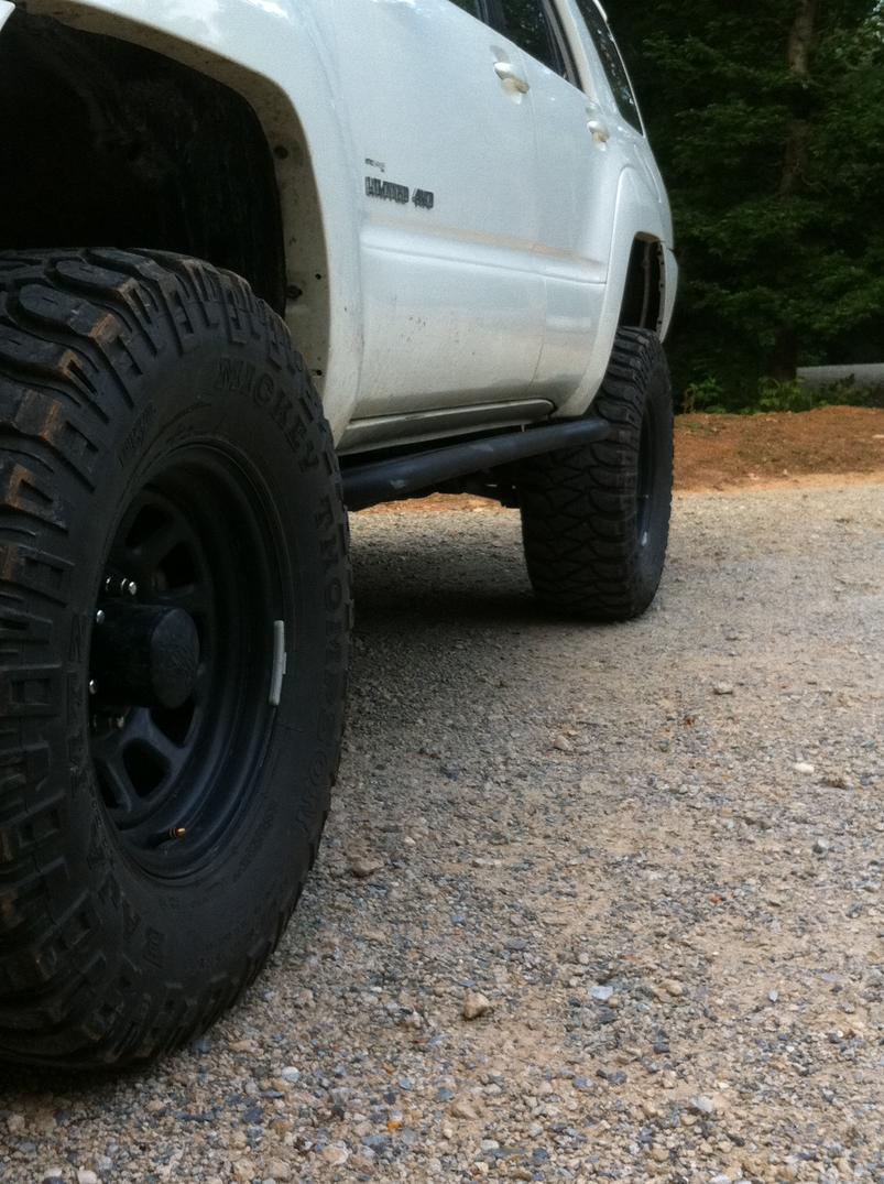

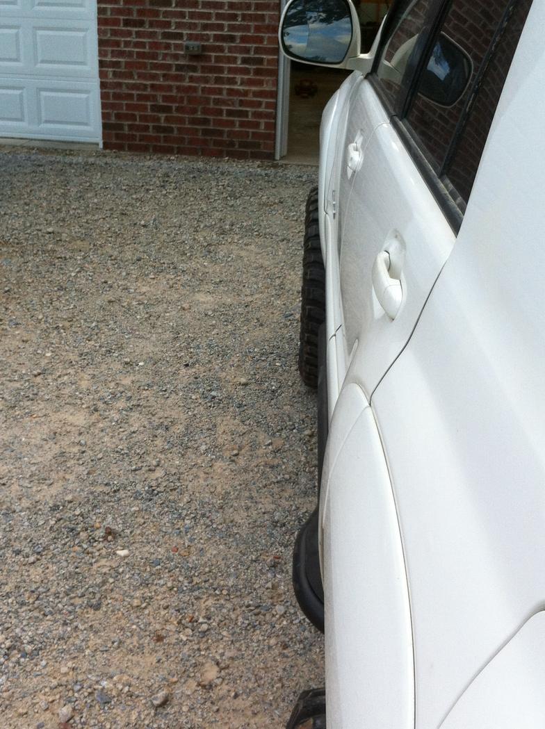

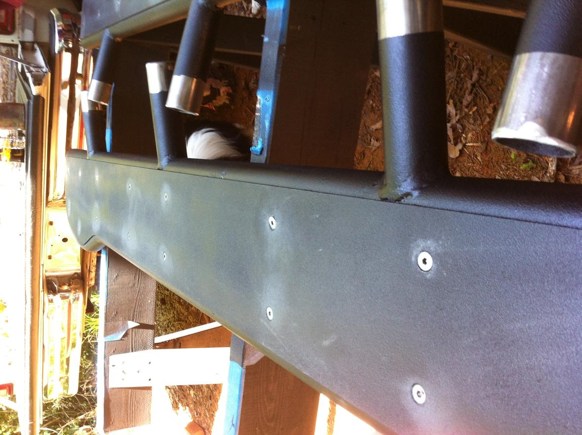

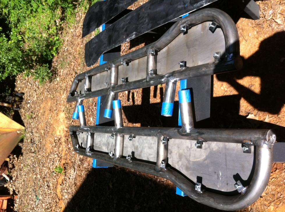

took about 3 weeks from sunday night order to friday lunch time fedex delivery! not to bad they were out of stock when i placed the order. I got them last friday and added 3/16" plate steel to the bottom and an 11gauge bolt on top plate. The slidders def. prove to strong enough on there own just wanted to slide on rocks a little better with the plating. Thanks 4xInnovations!!. took me all weekend but i got them welded up on my own wouldve gone faster if i had a helper lol.

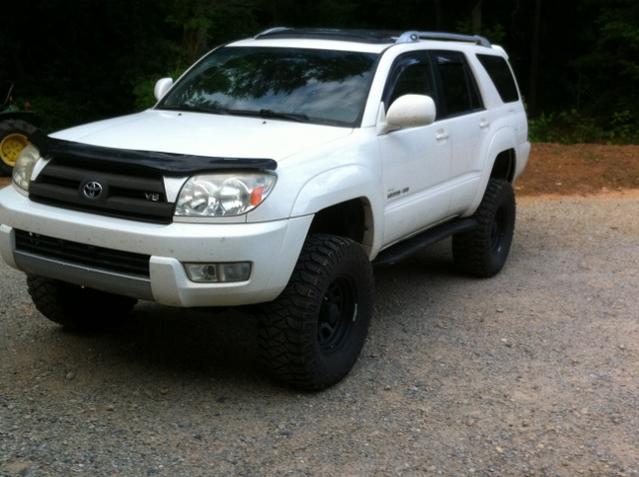

66" dom upgrade with kickout for the 96-02+ 4runners the front of the slider is about 6" behind the front tire and the rear of the slider is about 5" in front of the rear wheel with my 305/70/r16 setup anyway. I couldve chopped the body mount and centered it on the wheel base but i was satisfied with the 1" offcenter.
You shouldn't have had to even think about cutting the body mount for anything to do with the sliders, what was causing that potential interference?
I wouldnt call it a potention interference i mean, I did have the abilty to place the slider where ever i wanted it. I suppose just the way i wanted the sliders to tuck and sit put the front end of the slider about 3/16"-1/4" from touching the body mount (being placed 1" behind center of wheel base) I welded on 3/16" thick steel plating to the bottom of the sliders and counter sunk bolted an 11 gauge top plate. the counter sunk allan headed bolts required about a 5/8" gap between the bottom lip of the rocker panel (not the face of the rocker panel but that last little flat edge of plastic) I had to creat a gap there to allow a shortened allan wrench to remove the counter sunk bolts. My 4runner is a limited model which came with lights on the running boards so my intentions with the plating were to intigrate the orignal limited running board lighting/wiring into the sliders. I haven't decided exactly how i want to set the lights up in them yet (weather they face up or down, what bulbs i'll run or anything like that) but with the top plate removeable i can clean any debree i catch in there with the added plates and add the wiring and lights at convience.
on a side note: do they look to be in a similar location relevant to the body to other sliders you've seen put on 3rd or 4th gens? do the angles on the out running tubing seem to be similar to others as well? just curious I'm really happy with them. I love the 2" kickout, they show very minal flex with weight bouncing on them. As well I love the fact that i had the ability to customize them. oh and they were the best priced sliders on the market. Only thing to do now is get these things sliding on some rocks and see how my plating holds up underneath as well as my welds haha.

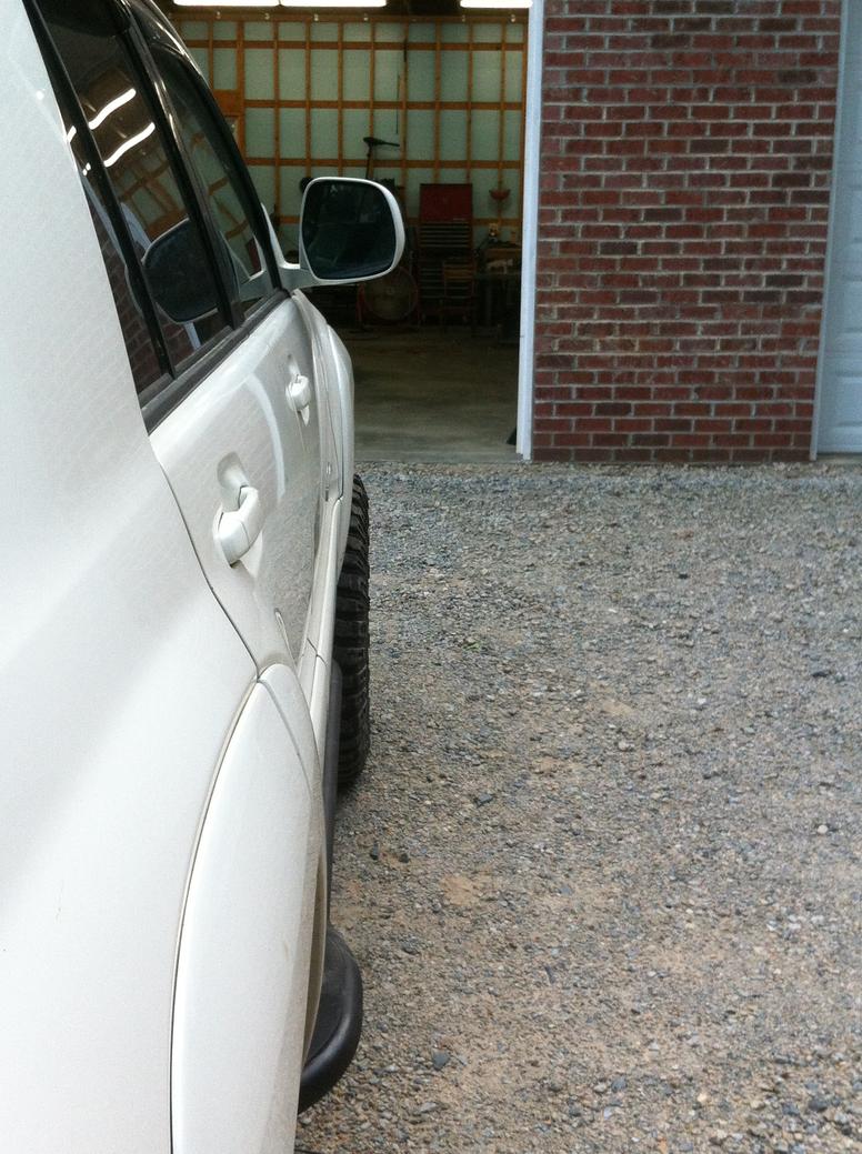

more pics! any armor idea to protect these big ass mirrors lol

Ah ok I see. For reference we do recommend at least 3/8" of gap between the body and the slider to allow both the body to flex as you are driving, and the slider will flex some under load also. Closer to a 1/2" gap is better anyway.
As far as how you installed them, looks good. I like the plating and installing lights into them will be really nice. Thanks for posting the pictures!
