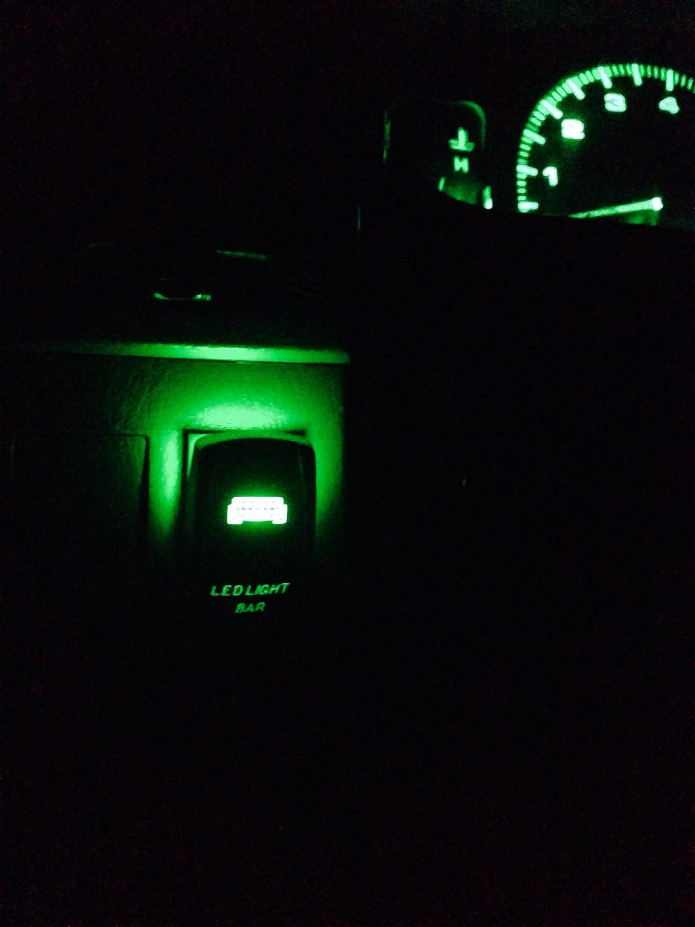

So this might be a newbie question maybe not, couldn't find much on it. I installed an Led bar today and the rocker switch is always illuminated. I tired hooking it up to my remote turn on radio wire, doesn't work. How can I hook this up with the dash lights?

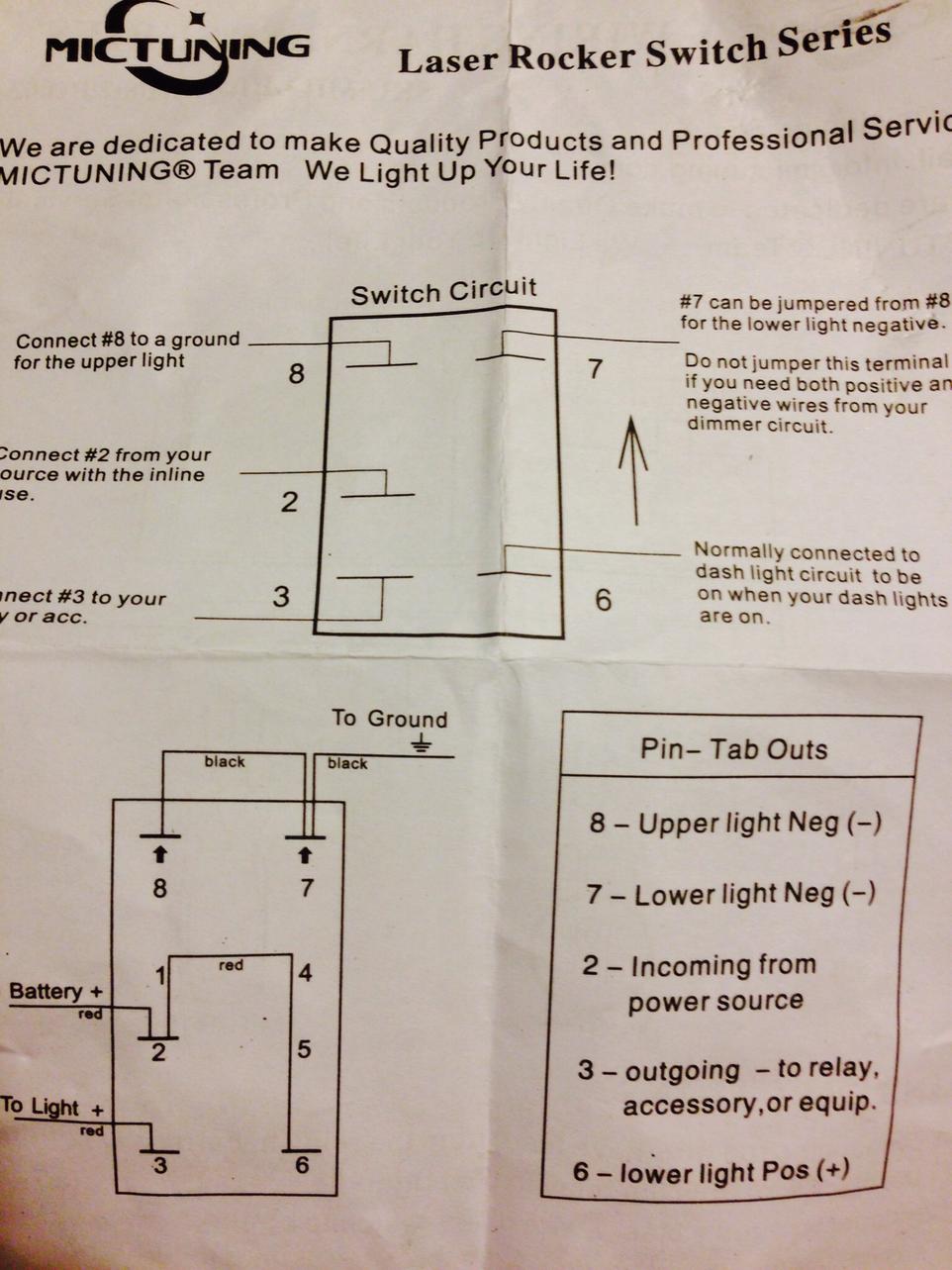

Here's the switch configuration. And I wired it like you're suppose to wire it....I read reviews on amazon and they all said they left theirs on and the light blew out after a couple days. I certainly don't want that. Like I said I tried hooking up my radio turn on wire to number 6 but it didn't work.

That would drive me insane. i bet one of those is the power for the backlight. do some testing and dont even power the backlight.
