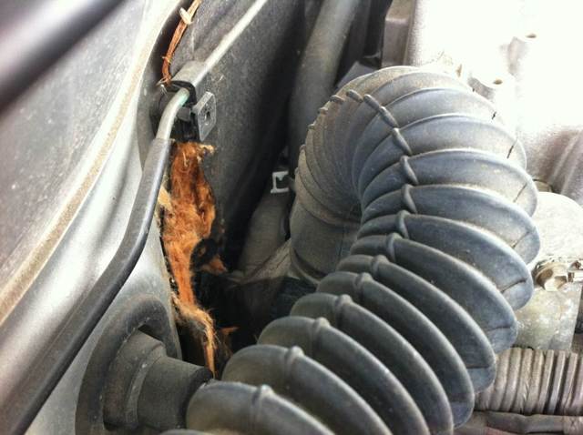

Advice please. There is some kind of rodent getting in the engine at night and eating insulation by the firewall.
The droppings are larger than mice and oval shape.

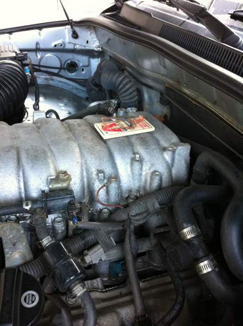

Should I set traps in the engine at night?

Get a spring loaded trap with a metal holder on it for bait. Put a peice of bacon on it before you go to bed. Take a torch and heat the bacon on the trap, and put in a spot close to there, but, stable not to fall off if touched by mice.

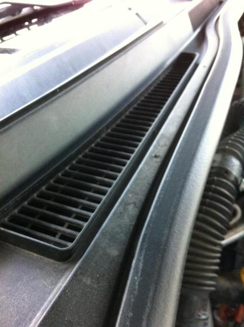

You might want to check the cabin air filter over the glove box. If you are having a problem with rodents in the engine compartment, it is very likely they might have gotten into the interior HVAC ducts via the fresh air intake under the wiper cowl. I have seen this in many vehicles in the Northeast. I had that problem years ago, and had to make a wire screen cover for the fresh air intake to keep them out (My anti-chipmonk mod).
If I remember correctly, there are some openings down the side of the body, that the critters can crawl up to get access to the area underneath the wiper cowl. Once there, it isn't very hard for them to get into the fresh air intake and inside the HVAC ducts and set up housekeeping. A long time ago, I worked for a Honda dealership, and we saw this problem all the time. There were a lot of pine trees in certain areas, and people came in with their HVAC ducts packed full of pine nuts that the critters had stored there. We had to take apart the entire dash to get to the ducts and empty them out. Once in a while we even came across a critter still in there. We used the steel mesh screening with 1/4" holes to make a cover for the fresh air intake to keep the critters out, and it worked well. I have also seen instances where critters can get up into the engine air intake and fill the area under the air filter with their 'winter supply'.

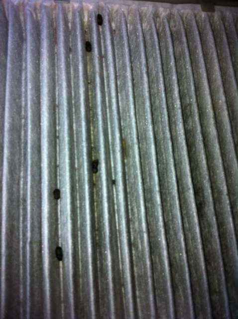

I checked the cabin air filter & it was disgusting! Couldn't believe I was breathing in that air!

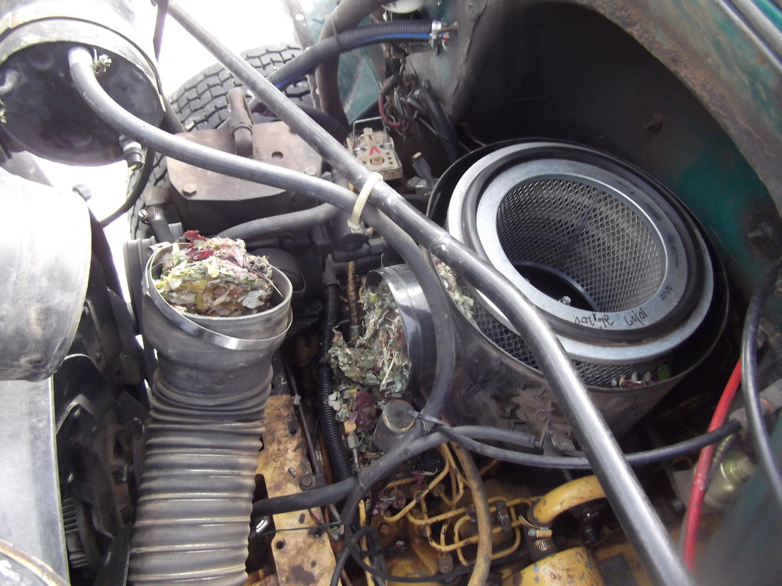

My truck had no power. I found that a pack rat had filled my intake system with a nest:

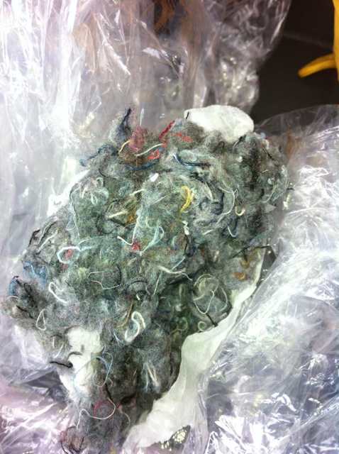

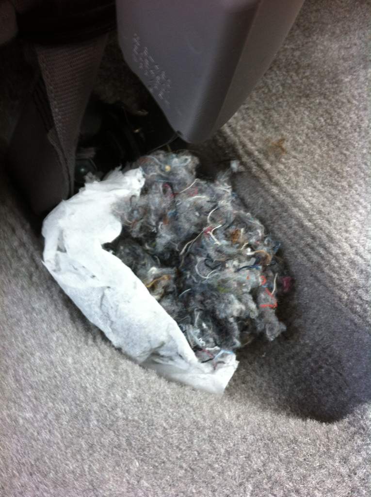

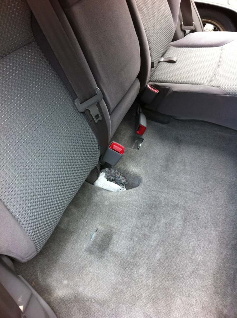

This afternoon I noticed very, very small mouse droppings on the console by the gear shift so I decided to thoroughly inspect the interior of the vehicle.
Upon lifting the rear seat cushions here is what I found:
Obviously a mouse nest. Can anyone tell me where the mouse would have obtained these types of fiber/threads from? The only one that looks familiar is from the yellow firewall insulation.
Maybe the insides of the seats? Under the carpet?
Thanks
