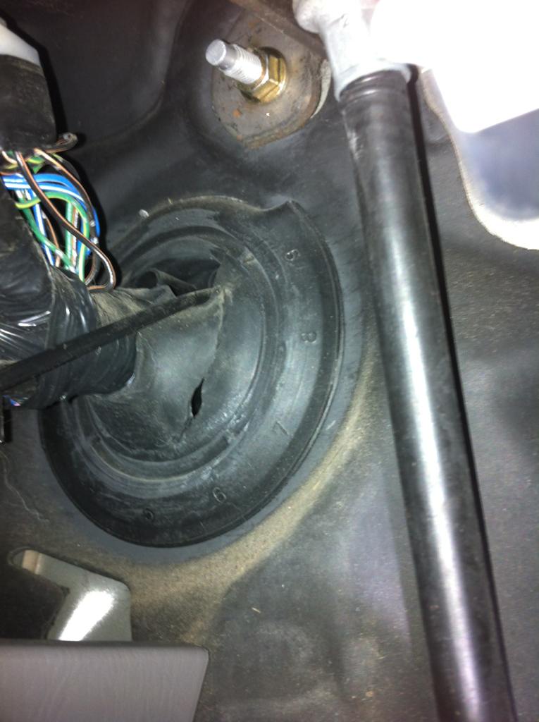

Anyone think this has been chewed by a mouse? Maybe a point of entry??
This is just by the parking brake.

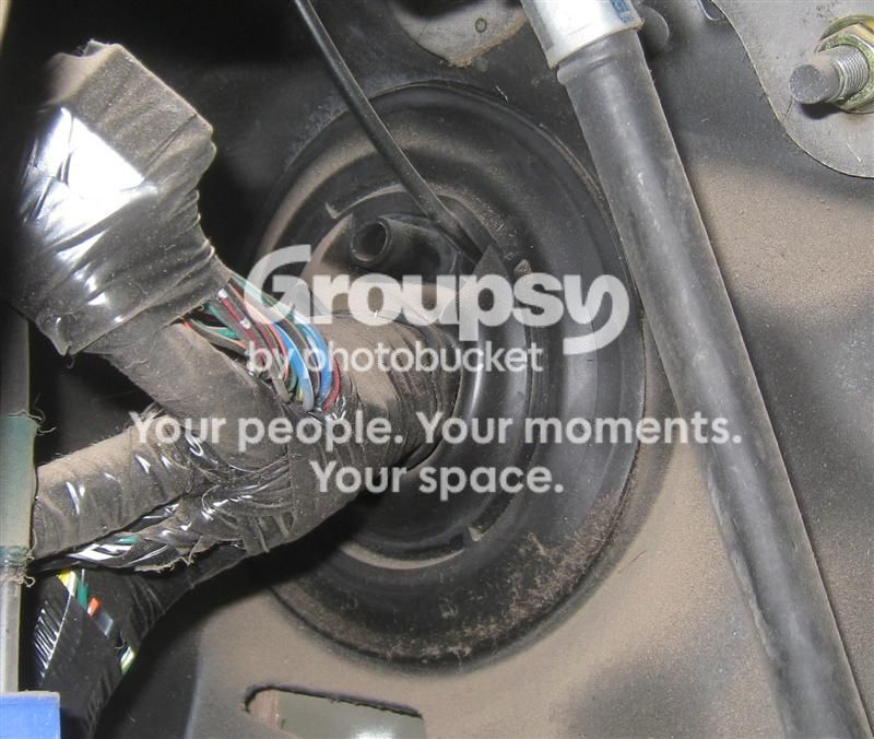

Could someone please have a look at theirs and tell me if it is a complete black rubber circle? And if those wires should be exposed?
Thx

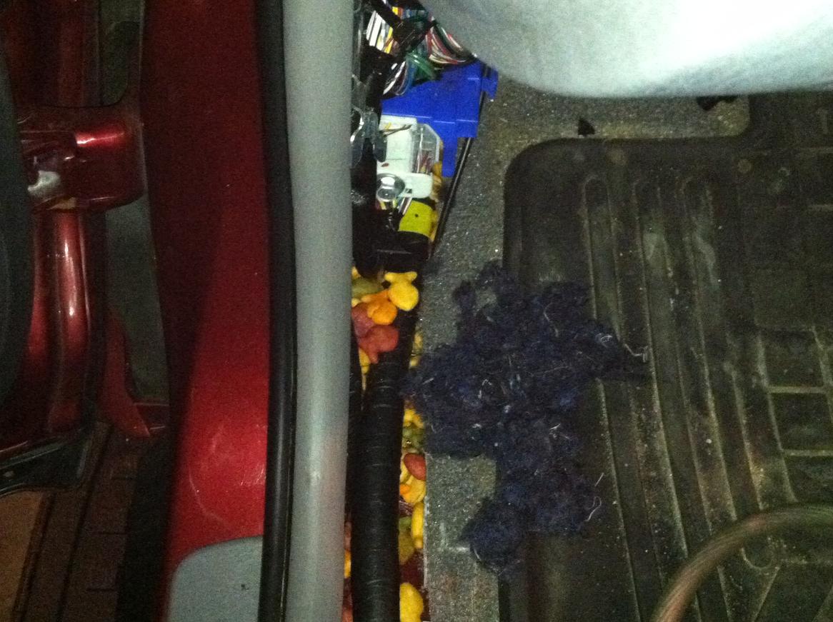

And this: "Obviously a mouse nest. Can anyone tell me where the mouse would have obtained these types of fiber/threads from? The only one that looks familiar is from the yellow firewall insulation.
Maybe the insides of the seats? Under the carpet?
Respectfully, where the fibers are from is irrelevant. Once mice are around they can and will get anywhere in your vehicle, and they will chew everything - rubber, plastic, paper, wire insulation.
I'd highly recommend the PB-baited spring traps as before set INSIDE the cabin, say on the floor. Put them on a rag or something, as they often bleed when trapped.
Very surprised your cabin doesn't smell like pee.

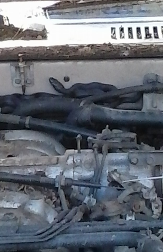

Ugg, found chewed wires today & a small black snake in engine compartment. Snake rode 45 miles in there. It was probably as surprised as we were, when we popped the hood at home.

I bought my 4Runner from a guy that didn't use it all that much so it sat for long periods of time.
When I began taking the insides apart to install a sound system I found what amounted to an entire bag of those multi coloured Goldfish stashed in the wire runs beneath the door sills. You can't imagine how small an opening those friggen mice need to pass through. How they did it with a whole Goldfish in their mouth I'll never know.
