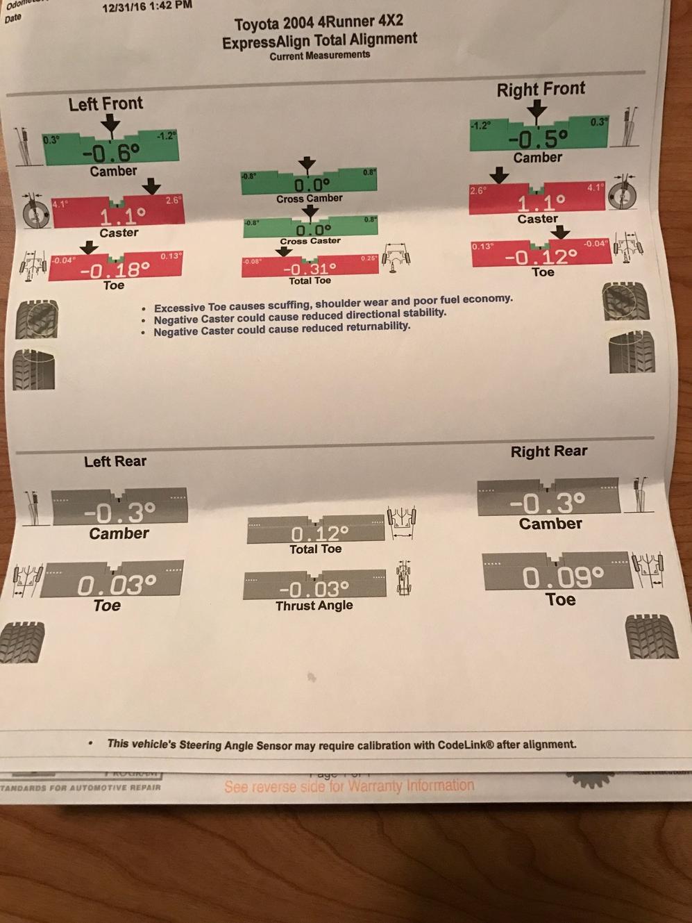

I'm curious if there are any members who have installed the Rokmen UCAs on their Gen4? I am installing mine this weekend but have a concern about the -1.1 Caster on my alignment. For a 2.5-3" lift it is recommended to use the standard setup. But since I am -1.1 in my castor wondering if I should go +1 on the included shims.
Any advice would be greatly appreciated.

I haven't used the Rokmen UCA's, but given your caster measurements, I would set the UCA's for +1 deg. That will move the caster in the right direction and allow the proper range of adjustment using the LCA cam bolts.
In general, a 2.5 inch front lift with a 1.5 inch rear lift will cause you to lose about 1.1 deg of caster. Setting the aftermarket UCA's to +1 will make up most of that, making the alignment at the LCA cams easy for the tech to adjust.
Where do you see -1.1° on there? Your Caster is at +1.1° not negative.
The red colour just means you are out of spec, the center line is the ideal spec. The writing in edges of the box show the acceptable range (which is technically that tiny green spot you see) that it should be within and the arrow is pointing to your measurement being way out of that, which is why the box is mostly red rather than green.
If you look at the Camber measurements you can see the "steps" in the box indicating that the measurement is within acceptable limits and that they are close to ideal.
